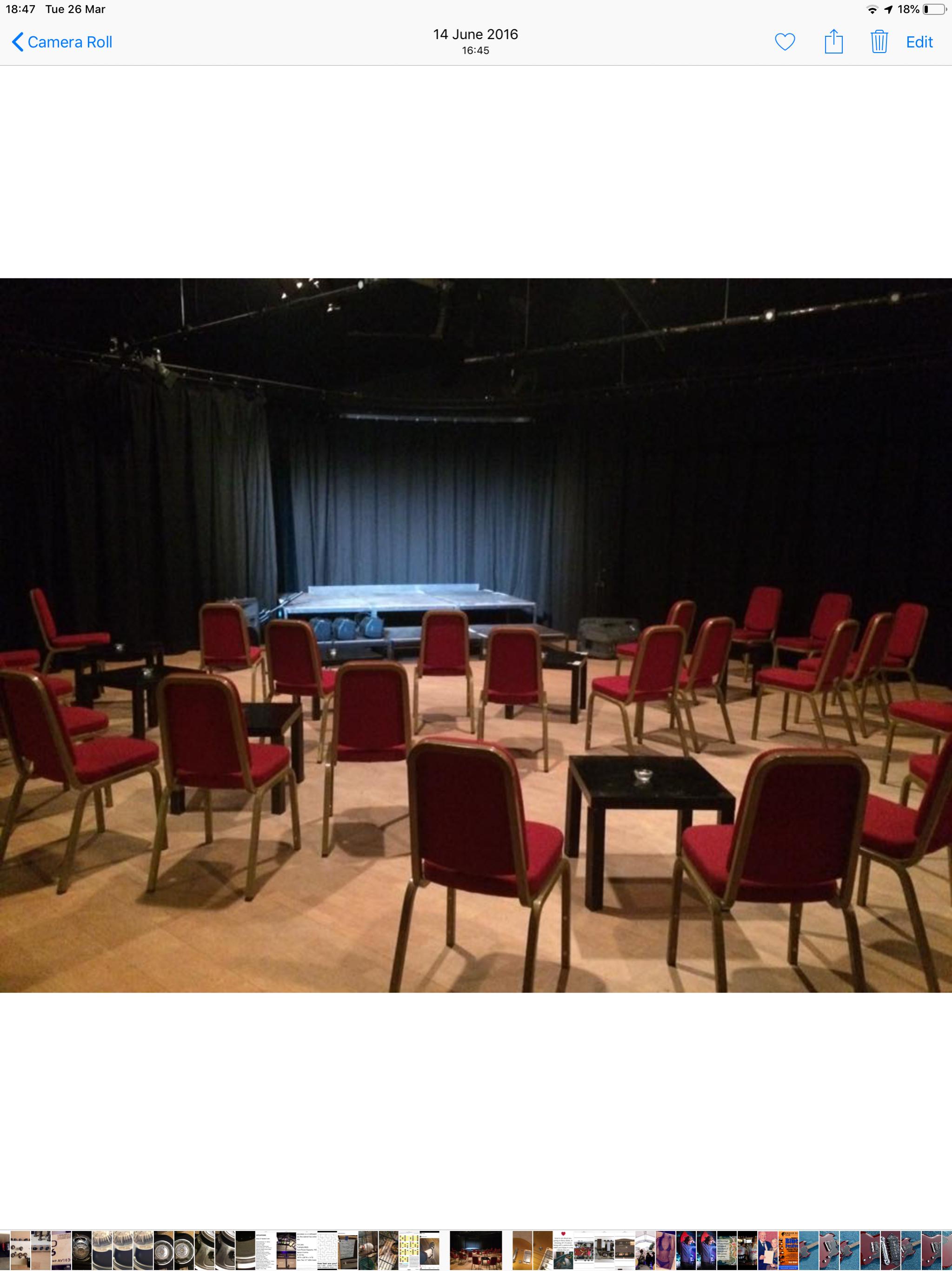

Thanks both but I do understand the difference in placement and how to do cardioid and endfire.. but I know I physically can not do any of them in most of the venues I go too... I physically don’t have the space or time to setup a system like that... if I was doing an install or had a few hours spare then fine, but a lot of the time the band arrives an hour before we’re due to start. And I have to set the PA system up and get it working , set up the lighting rig and get that working , as well as set up my own guitar rig....
And a lot of the time I don’t have a dedicated stage in witch to work around. So there no way of putting the subs in the centre, unless I make the singer stand in them. There’s not enough depth 90% if the time to get subs 1/4 wavelength apart and same goes for width as well..
It’s literally throw one sub at one side of the room throw the other sub at the other side, stick the mid high on top, plug in and go.
I’ll try and find a photo of an average gig I do so you get the idea.. give me a minute

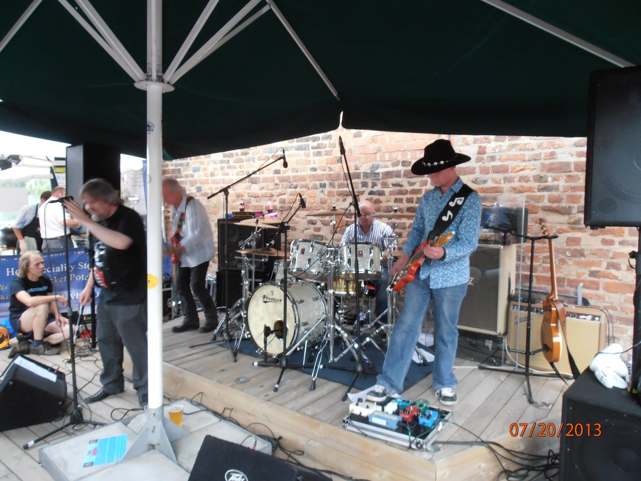

The photo of This outdoor gig is very old and it’s much much bigger now but the stage area is the same..the venue thinks we have about 600 people stood in front of us now days.

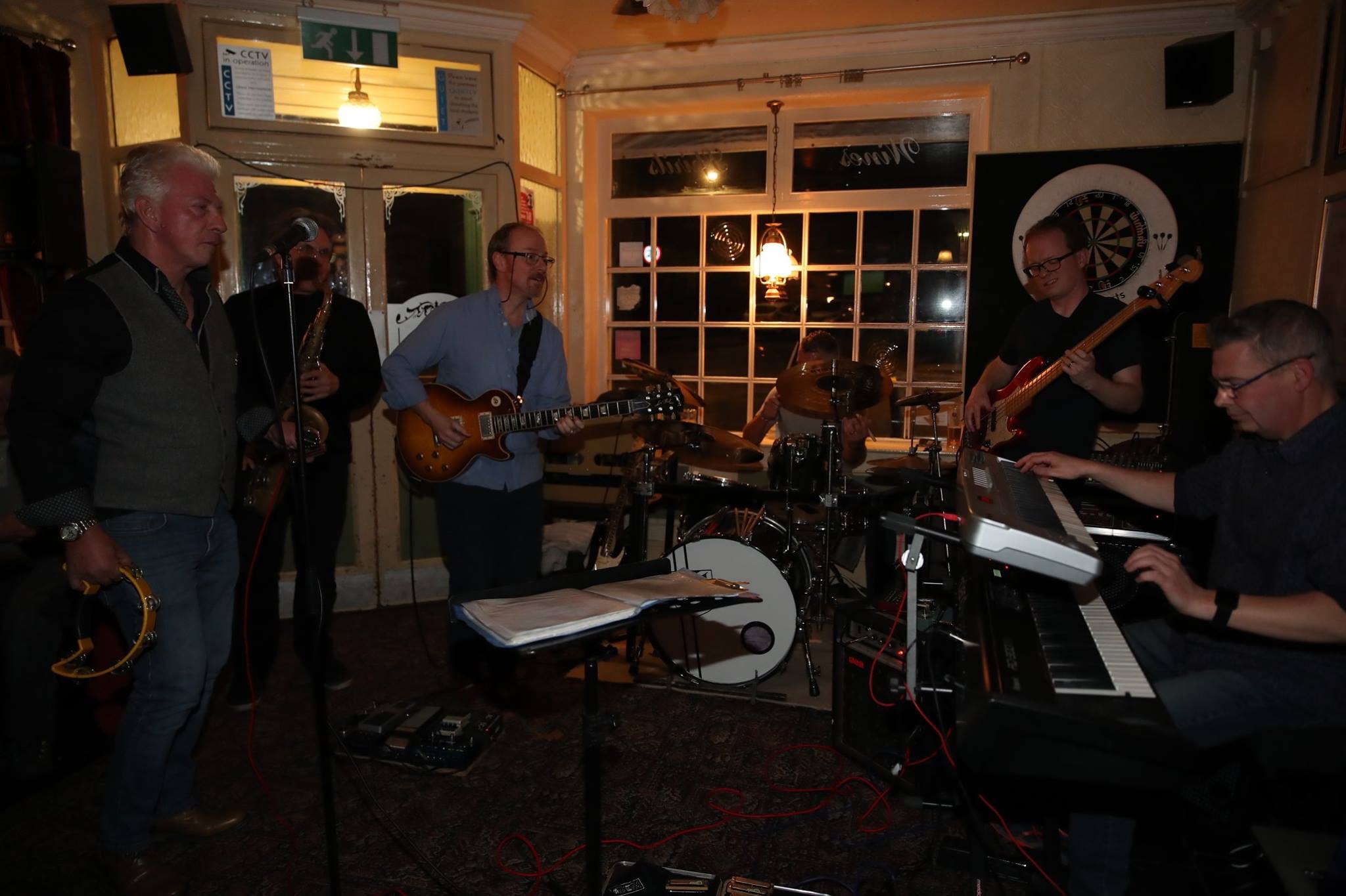

The other photo is of another band but in a blues rock club i play, it’s tiny and I hate playing there, but the Venue opens out and is fairly long and very heavily carpeted.. it holds 280 people ( apparently)
But I’ve attached a few other just as a general idea.
