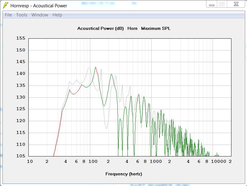

(I accidentally previously simmed it with 18hp1030 and deleted that post) Here's an 18HP1060 comparison assuming CUBO 18 can be assumed to be ~ a BVR as with this grabbed model
THAM18 appears to be tuned a half octave lower
I simmed both the traditional fold and new fold vs a CUBO18 model
more gain can be had in THAM18's volume - but at the expense of low end extension

Grey curve is the ROAR15 with a B&C 15TBW100, 2000 watt and xmax, and the green/red is a THAM18 with the Faital Pro 18HP1060, 2400 watt and xmax.
The max spl for the ROAR is slightly tweaked based on our experience with never getting a 350 watt 15 mm xmax driver to leave xmax in a ROARlike design driven by a 5000 watt amp.
I think the midbass range 60 to 1120 Hz is very revealing of the real life performance of a bass box due to the high energy content centered there in modern music.

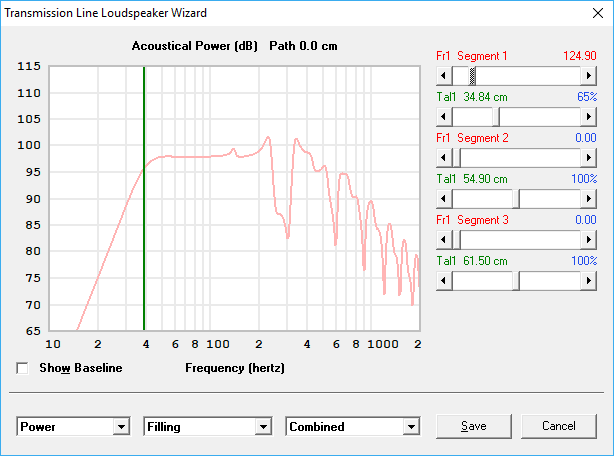

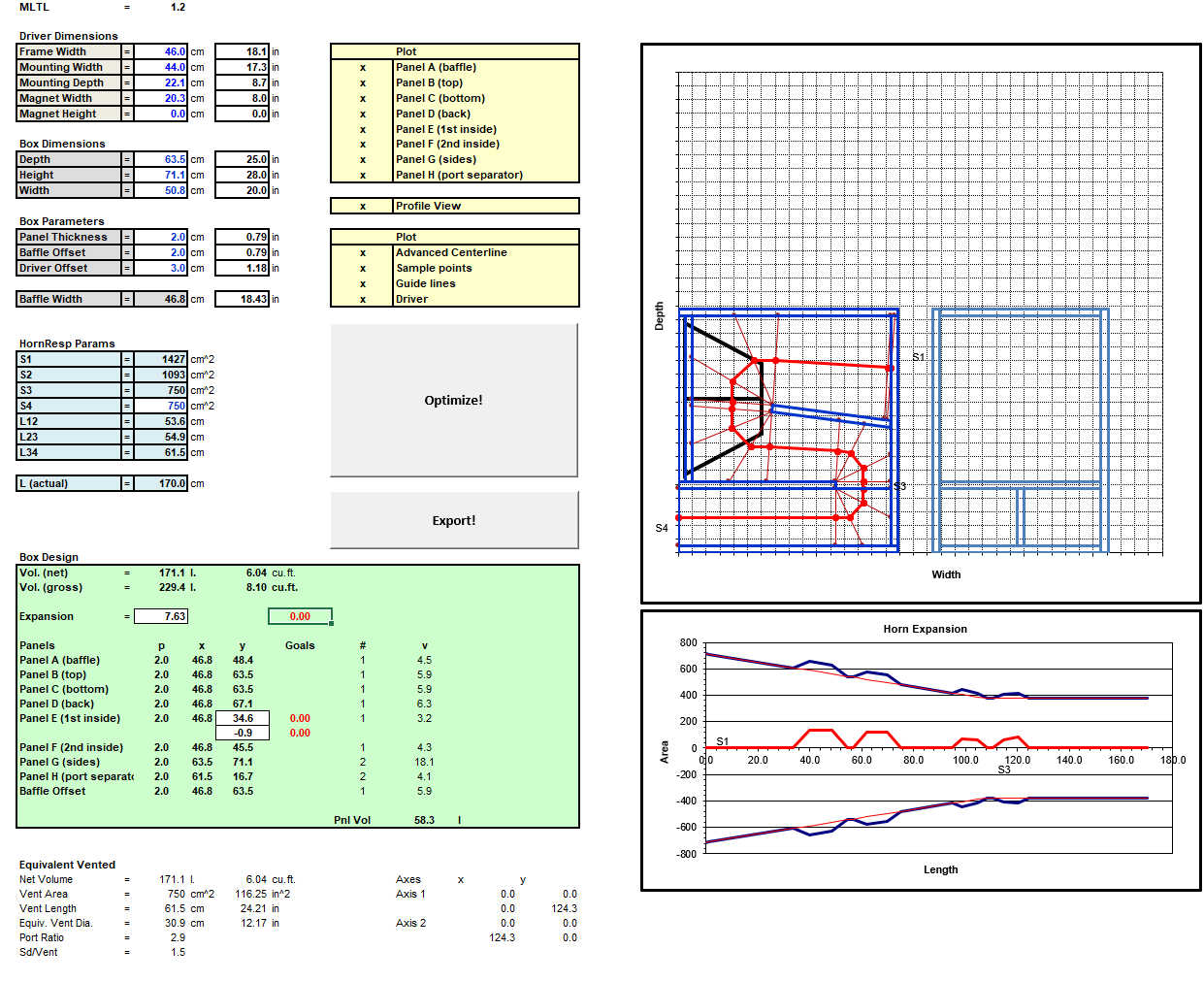

Sounds like a BVR or ODTL might be the best fit for your needs. Any other design in a similarly- sized box may give more SPL, but a narrower usable bandwidth, and out-of-band response variances that may be of concern.
Here's an idea for a 39 Hz ODTL using your selected driver. With 600 cm^2 of vent area, good luck trying to hear any vent compression effects 🙂. Build it so that the internal panel is removable. If you don't like how it sounds, remove it and you've got a vented box. Extend the vent upwards with an additional internal panel to lower Fb.

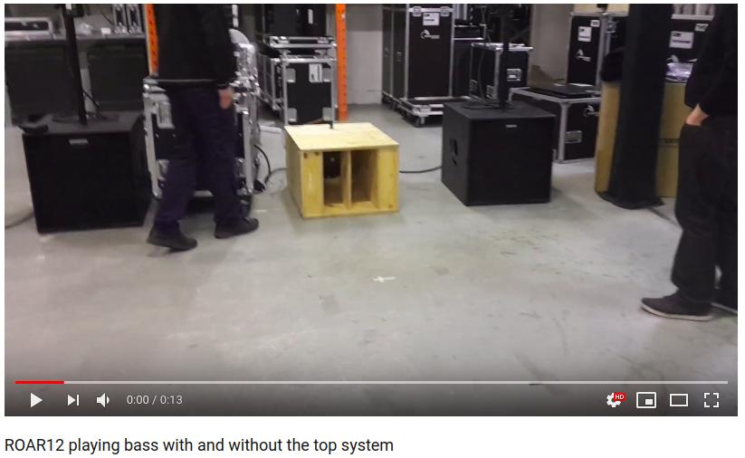

the old "throw" concept is one of the myths that just will not go away...sound propagation still continues to follow physics no matter how ardently we wish the rules could be broken... and in my touring days we used to wish that gear could be shrunk to small "pill" form that could be reconstituted with a drop or two of water at the next arena/gig ( you know like Wyllie Coyote did on Bugs Bunny with cannons or other large objects)
with bass there's no replacement for displacement...
The ROAR series is a low dispersion angle "far throw" design - just because it follows physics.
One single ROAR12 standing in the middle had a much more narrow dispersial angle and "longer throw" the two single 18 inch BR boxes spaced almost 4 meter apart.
This is very spl-dependent (more pronouced at high spl), which is quite logical because it depeds on the non linear behaviour of air at high sound pressure levels.
