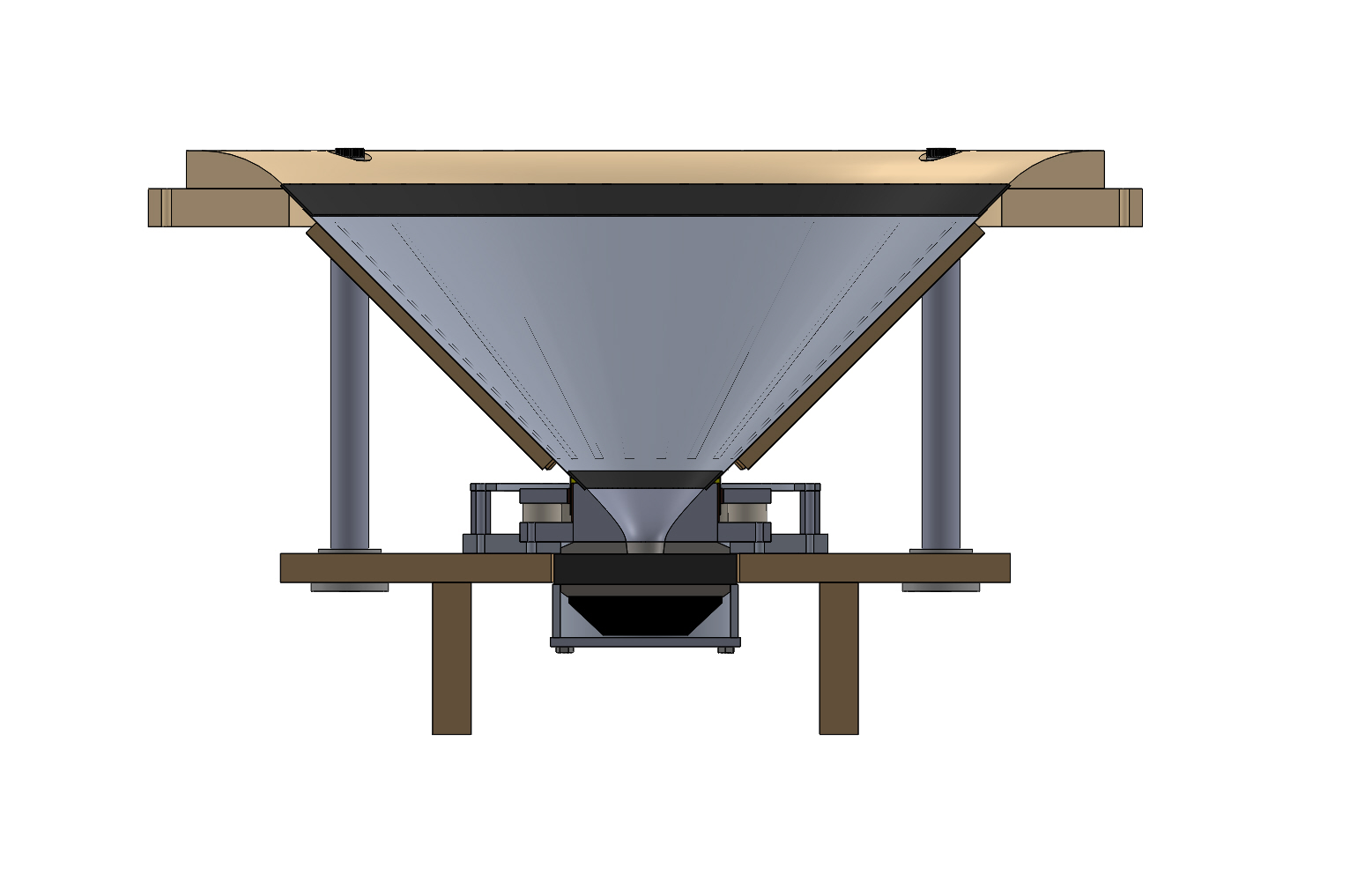

There have been a few design changes so far:
- One of them is that I'll be going back to a single layer aluminum cone for ease of fabrication. Instead of spinning it like I originally thought, I'll just be rolling it as I would've done for the sandwich. The reason why the sandwich doesn't seem necessary anymore is because I looked at the response curve for the Dayton RSS460-HO, and it doesn't have any resonances until about 1 kHz. This is an 18" driver with a shallower cone, so if I make a deeper cone with roughly the same wall thickness, I should be able to raise the frequency of the first mode even higher. If I can't make it so that the first peak becomes a non-issue (e.g. after DSP), I'll epoxy on 12 reinforcing ribs, equiradially-spaced around the back side of the cone. These ribs will be approx 10 mm wide by 200 mm long x 1/4" thick balsa wood, with thin aluminum sheet laminated to both sides for high rigidity with fairly low mass.
- The basket is no longer made out of extruded T-slot. Again, the change was made for ease of assembly, as the centers and lengths of the attachments would have required "tweaking" in order to get all the parts aligned. The basket is now made from aluminum rods mounted on a very thick, high-rigidity laminated MDF plate. All alignment (centers and offsets) would be handled by CNC-milled holes and shoulder screws.
- Another change that's LIKELY to happen is that instead of using the motor backplate to connect to the basket, I'll use the motor top plate instead. The system becomes slightly more complex this way (probably) but the benefit is that the cone assembly can be fully assembled with good access, before the motor system is installed. This allows for greater flexibility in how the voice coil/voice coil former are made and attached.
- One benefit of using the metal spider is that it serves as a fairly safe excursion limiter, given that the spider will hit the top plate at Xmech. Luckily, it should be fairly resistant to this type of damage. However, at the time being, there is no such Xmech limiter for excursion in the opposite direction. Therefore, I'll be adding some plastic shoulder screws that will screw into the top of the top plate. The screws will be located such that the spider would whack the underside of the screw heads on over-excursion. It's just a simple drilling/tapping operation on the top plate, so I'll add 4 screws for symmetry.

Found out that 4" DWV copper tubing is almost exactly what I need. ID of 4.009" and OD of 4.125". I can take the center pole and turn the OD to 4.02" (depending on the actual ID of the tubing), put a generous chamfer on the front, and press the whole thing on. The CNC operation can then shape the outside so that the sleeve OD is as required.
I've been steadily refining the design to make it cheaper and easier to manufacture. Hoping to get some free time to snap more screenshots of the model.
I ordered a DE250 today to get some precision measurements of the metal parts, since I am locating the axis of the driver through its top plate. Also would be nice to see how I am going to clamp the back on, and how much clearance I have for the signal wires.
Current iteration. Not all fasteners are shown.
The "basket" is aligned to the aluminum mounting plate using two dowel pins. I had previously used a bunch of shoulder screws all over the place for location, but I figured it would be more effective and more economical just to use two pins for location, and regular screws for fastening.
