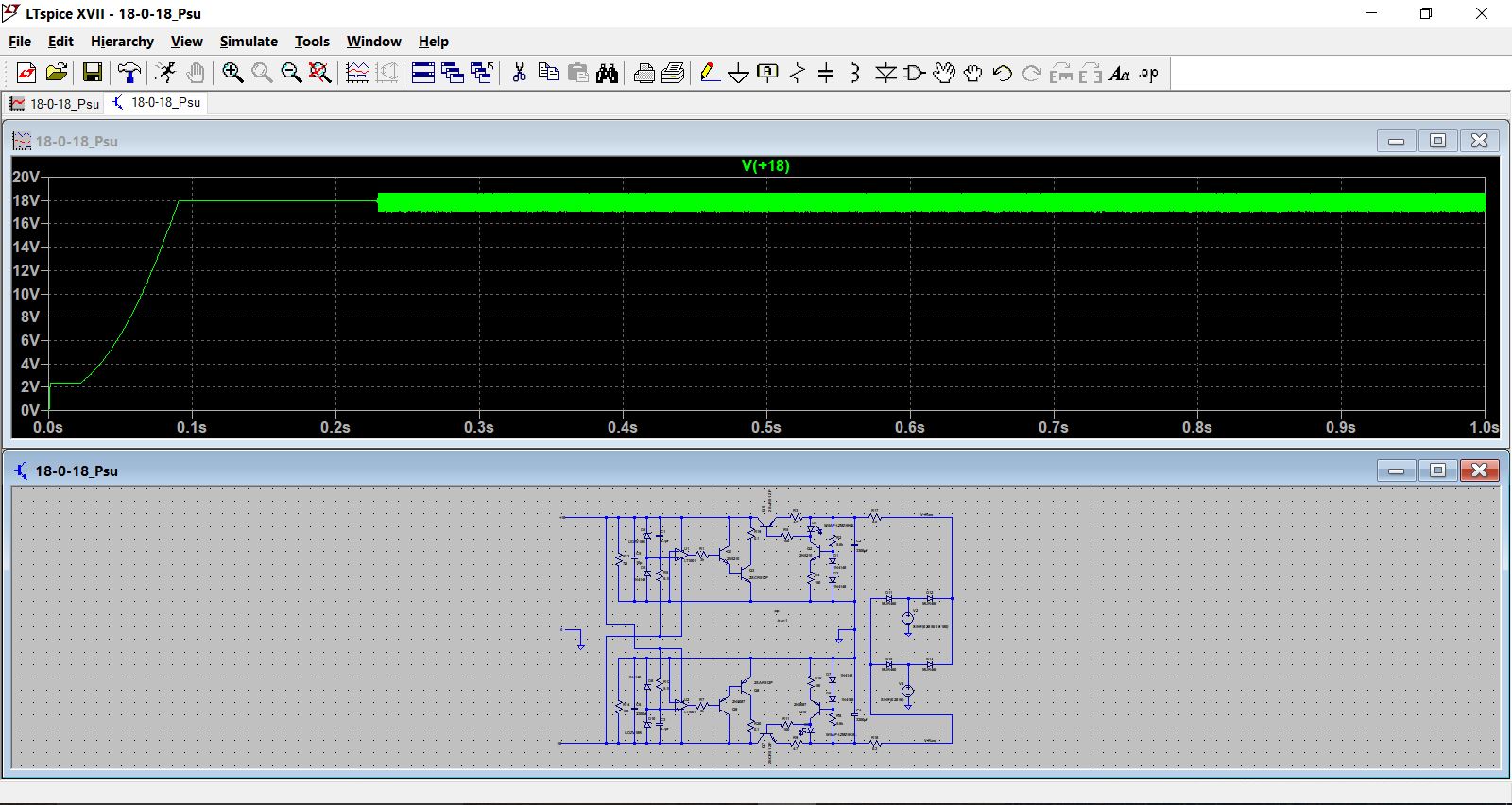

Ok, the last file you sent runs instantly. As before, I don't see any changes to the settings. What did you do?
Also, and pardon my ignorance; why are we using an AC sine source – or rather, seeing as it's rectified and smoothed; why can one not measure DC voltages with aforementioned rectified and smoothed source?
Is it because a SPICE generated DC source will be perfect and have no ripple? That shouldn't prevent DC measurements from being taken.
Of course I am very glad that you've shown me the sine source option, and I did notice in the setup that you put the second one 180 deg out of phase 🙂 So obvious when you think about it but maybe not so much when just getting started.

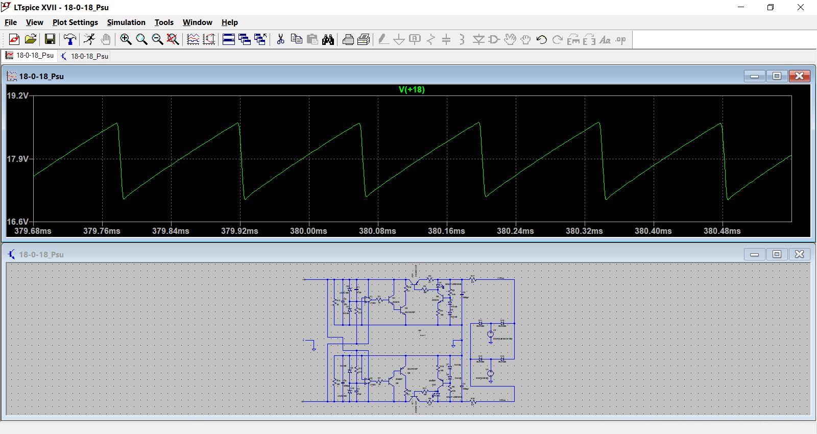

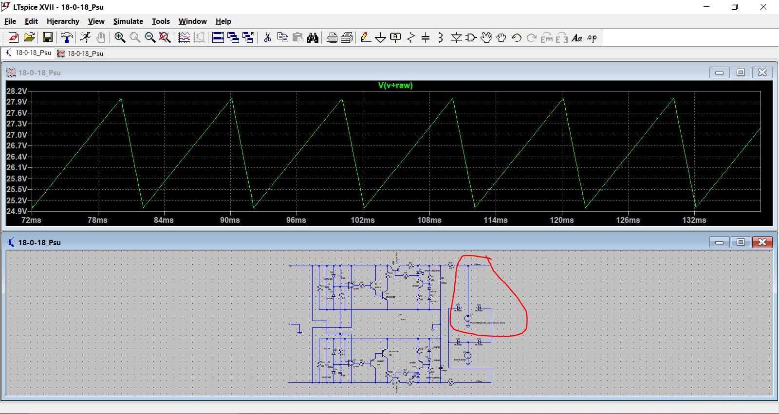

We used an AC source for two main reasons.
1/ It shows dynamically how good (or bad) the circuit is for producing clean DC. We can see exactly how much ripple there is. We could also be smart and rig up a switched load varying between two values and look at the regulation of the supply.
You could also reduce the value of the main reservoir caps and look at how that affects the final ripple voltage.

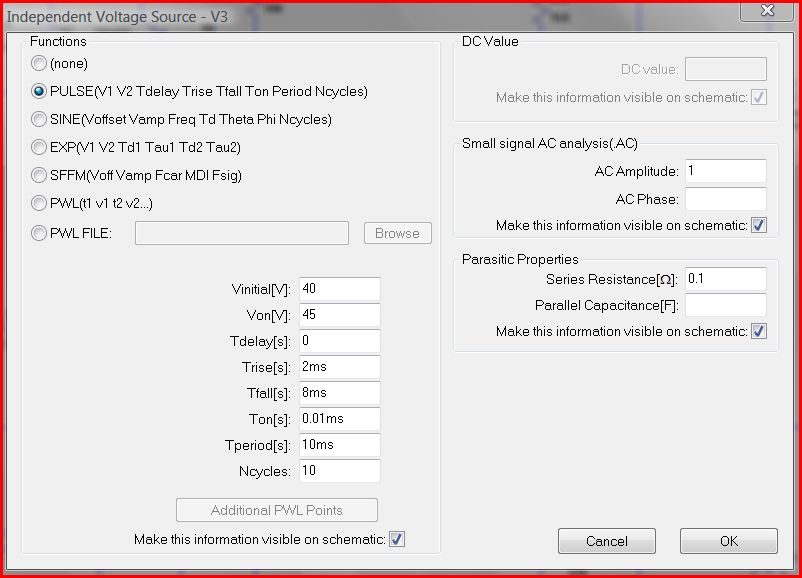

2/ We can also see if the regulator is stable under all conditions. Look at the images. This shows the +18 volt rail when the 3300uF cap is reduced in value. So we have a problem. The basic design is unstable and is relying on loads of capacitance to force it to be stable which isn't good. The second image is a close up of that noise and oscillation.
Sometimes simulation files don't run (or don't converge as its called) and the original could have been such an example. It doesn't actually happen all that often. The OP34 type opamps seemed to be an issue though and possibly not suitable in real life as well as simulation. When there is a lot of random detail to plot (random instability at a microvolt level) then things probably just appear to stall. That would be my best guess.
A DC voltage source is perfect in every way and can supply billions upon billions of amps with not a uV drop 😀 There is an option to add series resistance to the supply and sometimes adding say 0.1 ohm makes it more realistic. Of course there is still no ripple.
If you don't want to set up a bridge (or diode) and reservoir cap then we can still simulate a fixed level of ripple. Take a look at image 3. That generates a waveform approximating 50Hz ripple. The peak is at 45 volts and the trough at 40 volts. In the last image I changed that to 28 and 25 volts.

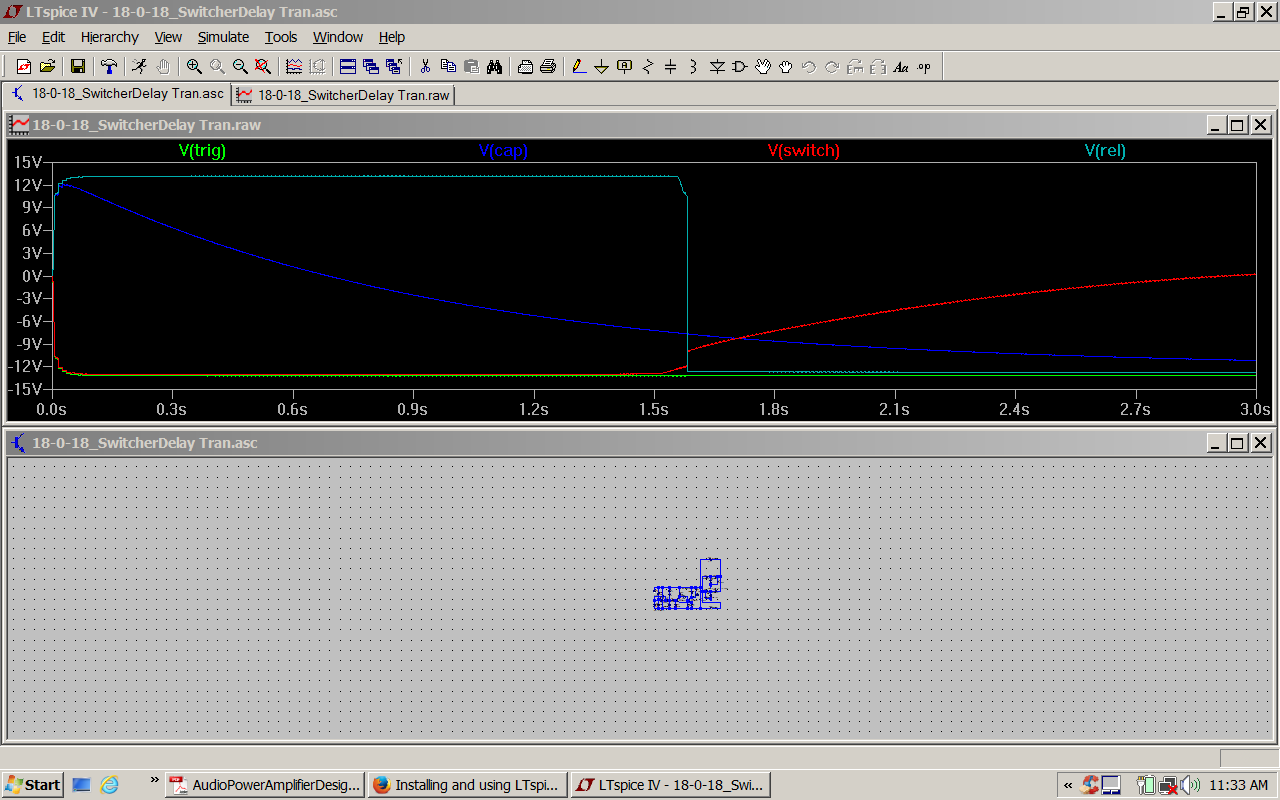

Hi Mooly,
A lot of what you've just explained I experienced for myself last night while experimenting with a simple timing circuit, using your sine psu.
When a simulation produced the attached image, a light suddenly went on, figuratively speaking. I think part of the problem for me that inhibits learning (I'm an Aspie) is I need a kind of 'overview' of whatever it is that's being studied. What is blatantly obvious to others is often shrouded in mystery to me. At school, I always did better learning from a 'worked' example. When working on a new model, say a complex AVR, I find it helpful to take a few minutes to study the block diagram which helps me understand how all the many different sections function together.
Having used this program for less than a week, I'm still very much in 'a state of wonder', trying to comprehend the vastness of this incredible resource.
When the attached image was produced, I only then realised that the simulation can be run repeatedly, without reapply all the probes again. Also, that it seems I can attach as many probes as I like and get to see this beautifully choreographed dance of electrical signal function in the circuit. At that point I also understood the necessity of clearly labelling all the points of interest 🙂
So, a picture is indeed worth a thousand words. At a glance I see the trigger event (in this case an interruption in the V+ supply to part of the op-amp based circuit) initiate a capacitor discharge sequence, which at a certain threshold causes a relay to latch (a transistor takes one side of the coil to ground). I also tagged a transistor switch just out of curiosity. All the action takes place just after the 1.5s mark and with the initial setting of 1 in the tran setup page, was being missed entirely. Changing the timing cap value and the time setting resolved all that. For a beginner like me, Slow is the operative word 🙂
The voltage scale is a bit weird because I used your split rail supply. The circuit I was examining didn't need that. Being a bit lazy, I used the outer +&- rails and then I had ripple galore. Even a cap between V+&- did nothing. I had to add one between each supply rail and the centre tap and that got rid of it.
As always, your helpful comment and attached images are much appreciated. I will study them today.
I've only scratched the surface of what LT can do tbh but I agree that it is a fabulous design tool.

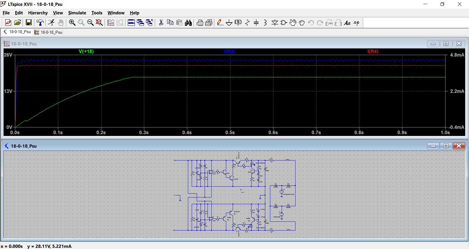

I don't know if you have tried this but as well as just looking at voltages you can also look at currents all on the same screen. Just hover over a resistor or cap and click. The current will be displayed with a new scale at the right of the screen.
This shows the 18 volt rail again, and also the current in R2 and R4.
I can't make your last circuit out 😀 At any time you can place the cursor on the circuit diagram workspace/screen and just hit the spacebar. The circuit will resize back to fill the window. The scroll wheel should allow you to some in and out and you can also drag the circuit around.

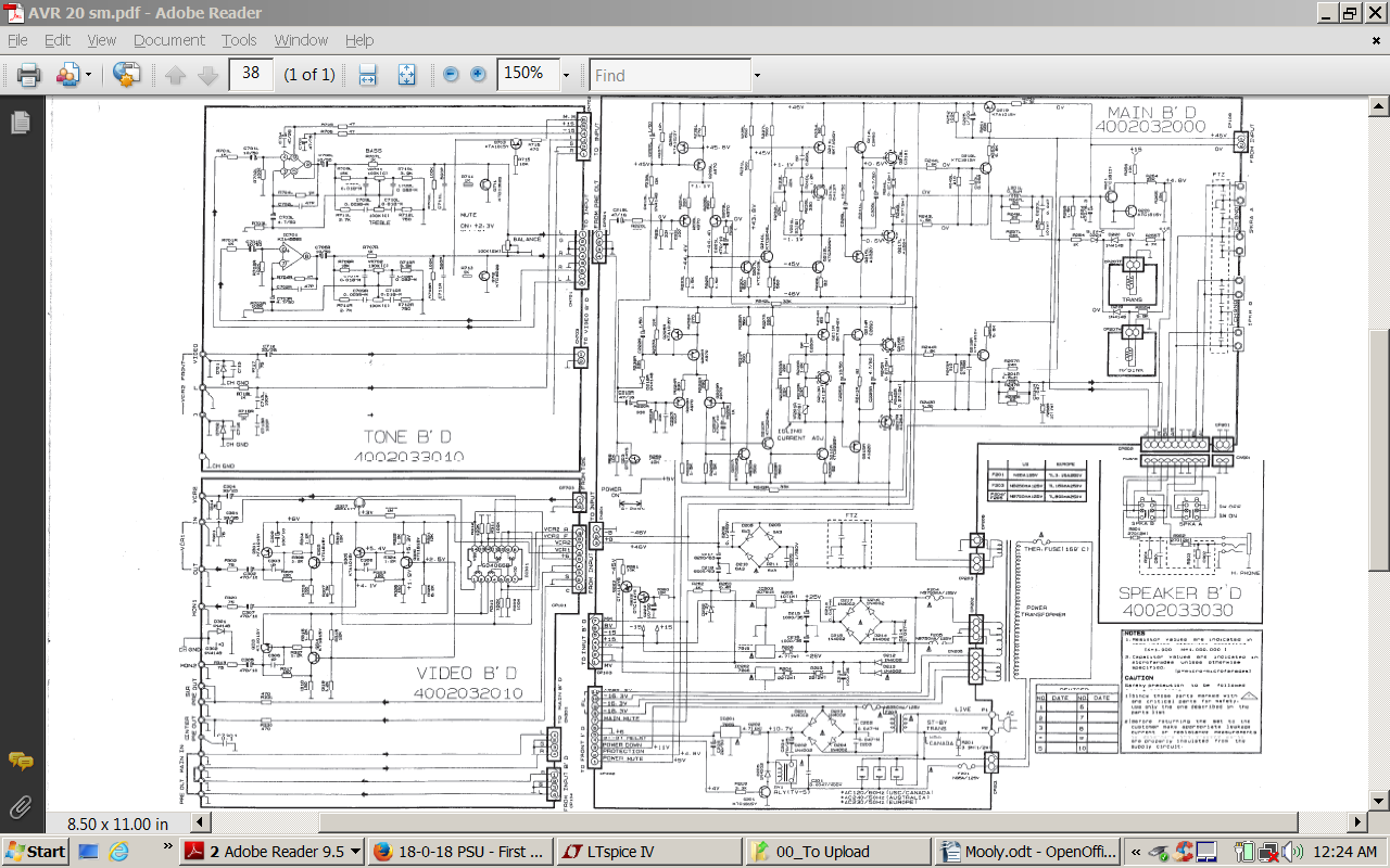

All primary windings of transformers in power supplies are on the left of the page.
Power flows from left to right as does signal. Maybe your schematic is a mirror image?
Not that it matters, just a sanity issue for me and anyone else in the trade that has been reading service manuals for over 50 years.
All? Really? 🙂 🙂
I closed my eyes and just chose one at random. Good choice it was too. It's an older one scanned from a good old fashioned paper service manual.
