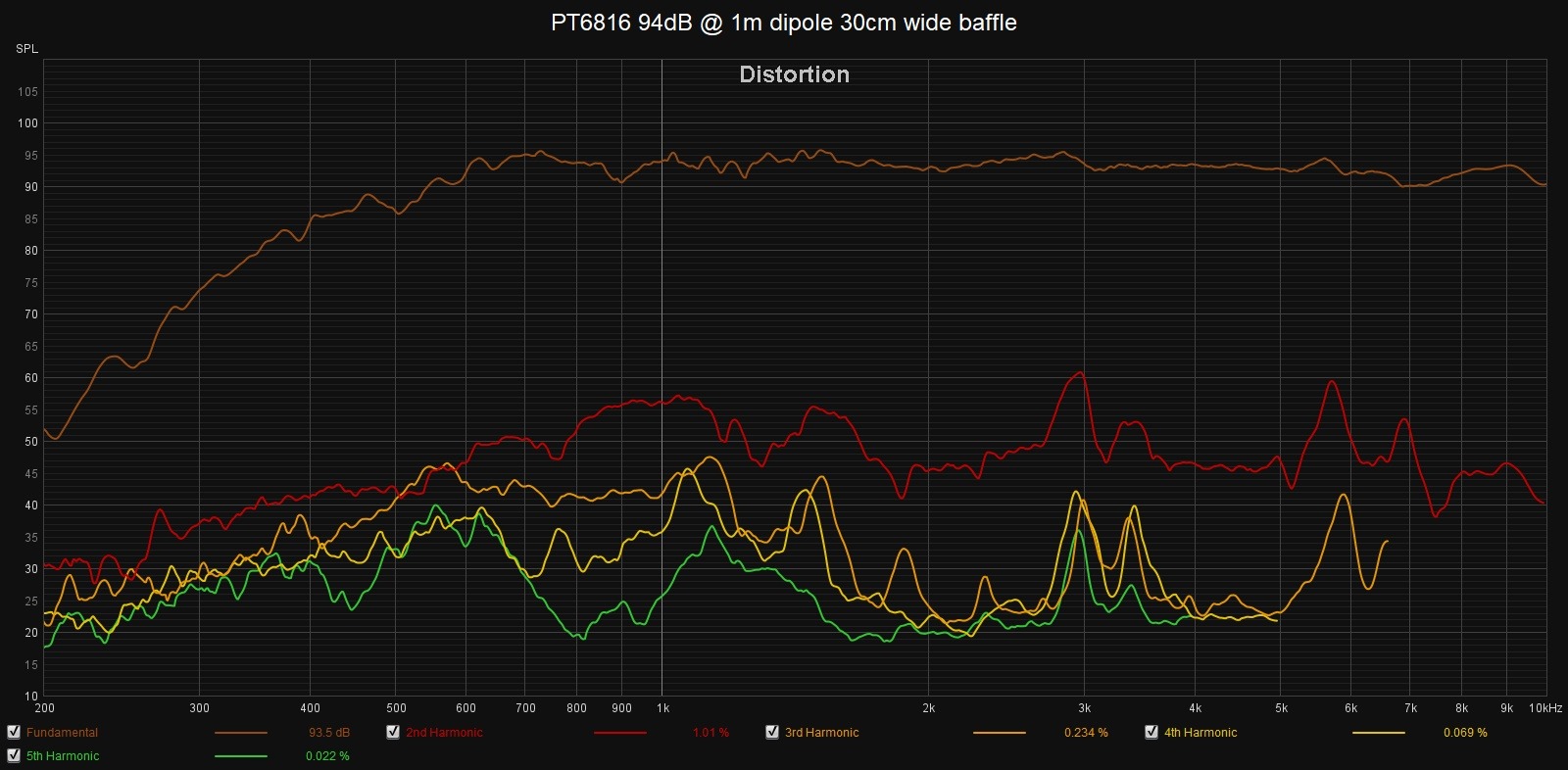

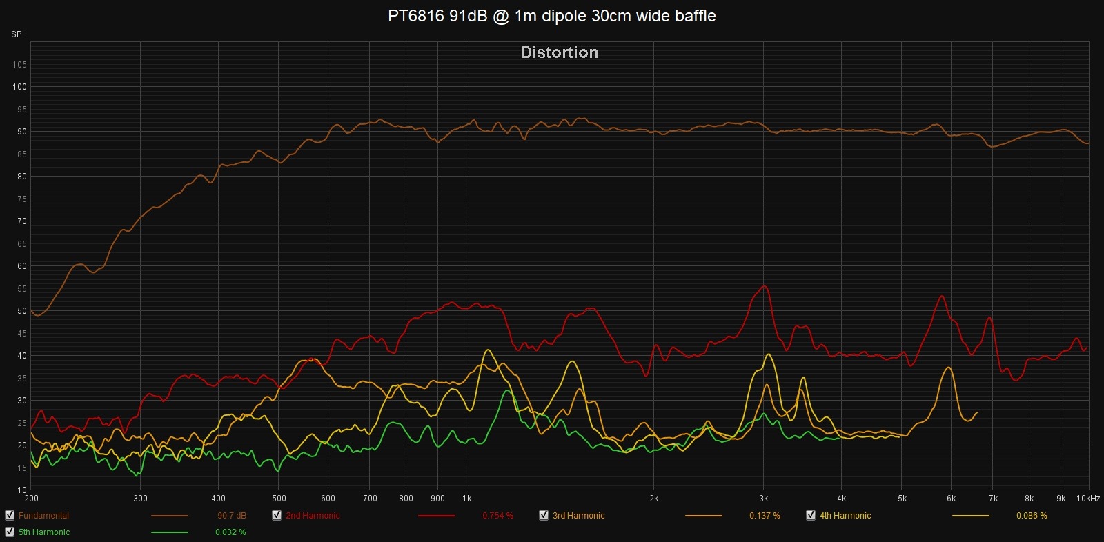

As small satellites I think 300 hz is too low for a single PT6816. I'd suggest more in the 600 hz range. You might get down to 300-400 with a huge ~ 20" wide horn or but then we aren't in small satellite territory anymore. I've added distortion figures in a dipole setup normalized to 91 and 94 dB with 500 hz LR4. While it is not a true representation of a sealed setup it does show when the driver starts to misbehave and not output cleanly anymore.
If you want a small sattelite I would suggest either one or two front facing PT6816 (mounted on top of each other) and then small shallow woofers mounted to the side with a crossover in the 600 hz @ LR4 or 800-1000 @ LR2. The second PT6816 would be to bump the height of the speaker and thus help with vertical dispersion.
Or go with a different driver. A single planar driver more suitable for 200-300 hz is probably the PT5010 but it needs a separate tweeter.
