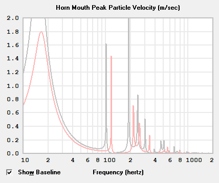

17hz TL sub for Dayton Reference 10"

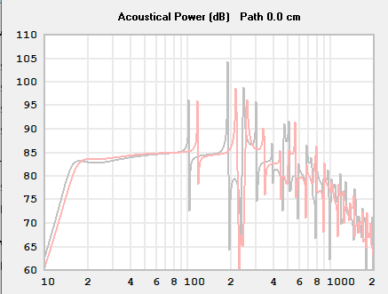

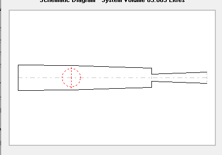

Working from the target of 0.7*Fs, I came up with this. Target is a large box that can play to 17hz. Appreciate any feedback. Amp is the Dayton 250W DSP plate amp.
Driver is the Dayton RSS265HF-8 10"
Wow, you get that way down low. Are you sure you don’t have a issue with your air speed at the last 66 cm?
I have a few of these down in the 20s in ODMLTL and they work good. I’d be cool if you could manage that 17 hz? But definitely check your air particle velocity by selecting the port or the horn option in acoustic power just in case?

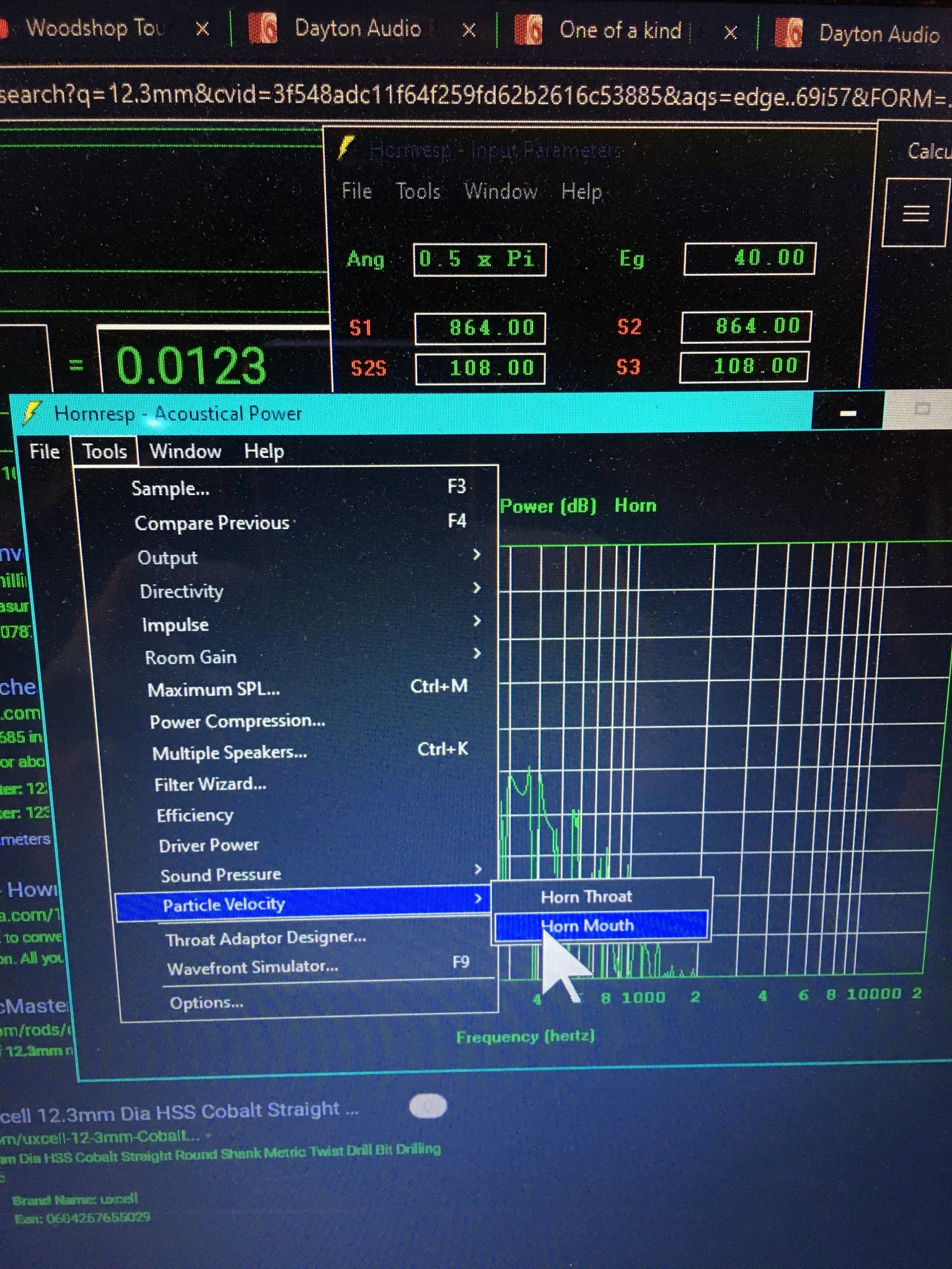

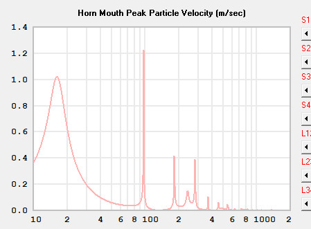

How would I check this? Is there a rule of thumb for when air speed becomes a problem?
I just tried playing around with the shape of the last segment and can get the air velocity much lower with a flare and slightly different shape to the TL.
What does it look like when you pur damping in the line?
dave
I have the damping at zeros right now. Where and how much would you suggest? Is there something in the modeled response that I should be trying to correct here?

Yeah I have something similar the first leg is 105 cm of 300cm (low 20hz) and that’s where both the driver entry is @ . and t then two more folded segments slightly shorter —>to the exit and driver output from the front of the cone are in the same place and share in abbreviated exit chamber Just big enough to allow a down fire or end fire or whatever cut out A router can easily produce Thats best for wherever you put it or need to.
Turn her up to what are you anticipate being full power at any moment(ie the party with Drinks) make sure you haven’t created airspeed exceeding 15,16 m/s Even went in for retard mode or goofing off whatever you call it when you’re going to do those things that you don’t normally do just for fun

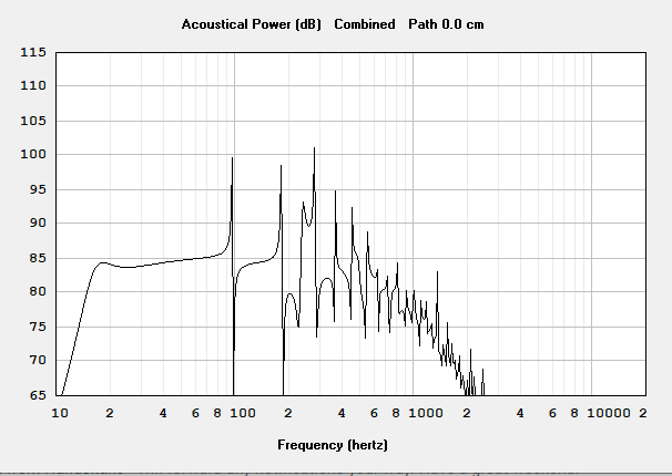

For future reference and at least for any DIYaudio thread, please EXPORT/attach your HR record when wanting HR help.
Regardless, I happened to have a similar design loaded, so inputting your original sim I first changed (Rg) = 0.5 ohm for wiring losses, then the expo taper (hard to make) to parabolic since I assume you'll have at least one set of parallel sides, then slightly changed the driver location to a more optimal offset and ran the sim with 250 W, which this alignment can't begin to handle down low, backing it off to a more realistic 120 W.
This reduced the vent (mouth) velocity to a still whopping ~33 m/s vs the ~17 m/s 'we' normally use as the upper limit, so with a bit of stuffing here n' there got it down, though of course with a ~ 6 dB loss down low and still some 'ripple' above ~ 200 Hz.

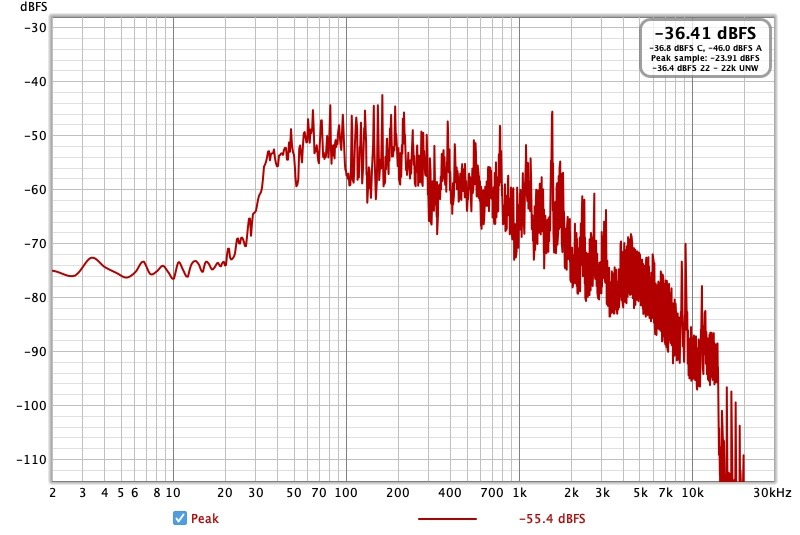

Attached is my RTA for the "50 Ways..." link otswim provided in his post*. Obviously, nothing material on the recording below 35 Hz which is what few with REW would call "well recorded" or "deep". Most of the oomph is at 80 Hz, like a lot of pop recordings I hear from automobiles passing me on the street and that a lot of people mistake for great bass. Not much treble north of 2kHz either.
Also like a lot of pop recordings, miserable dynamic range and rather boring engineering (OK, that's the point of the song). Profile at any moment barely departs from the peak I've posted.
But I might add, just like otswim found, nothing too shoddy about good bass to 35 Hz, ask any Klipschorn owner.
I wish people would do an RTA before offering their opinion about FR. Saves embarrassment.

*Other releases might be better than that link or my test method - dunno. Please post RTA if you have better.

No doubt great headphones would sound great. I'm having trouble figuring out what your test method could establish?
I suggest you give RTA using honorware REW a try. I wish everybody would try. RTA is all electric, no mic used. You might need a DAC to feed your computer output into your computer input (maybe $35 from Behringer and others). Or if you have one of those old-fashioned systems that aren't bi-amped, just disable any EQ and use the output to the speakers.

Where can I find this measure? Won't stuffing the mouth add resistance and throw off the math?
??? You posted a screen shot of it in your original post. 😉 The difference is yours is based on HR's default power whereas mine is based on using the Wizard to 'slide' my way to a realistic max amp power based on Xmax, then looking at the vent (mouth) velocity.
Absolutely! Hence my caution: though of course with a ~ 6 dB loss down low and still some 'ripple' above ~ 200 Hz.
