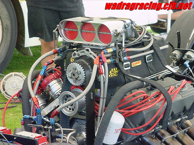

The noisest thing I have ever heard is a top fuel dragster making 5,500 hp. This would have to be the most evil sounding machine ever. Here's a 5000 hp example that measures at 164.8 dB at 1 metre in *open air* not inside a closed room or vehicle. http://sxaudio.com/ Click on logo.
Notice here some sensible people are holding on to their ears to stop them being blown clean off! http://www.webtec.net.au/~nitro/
Pic of 164.8 dB jigger below.
