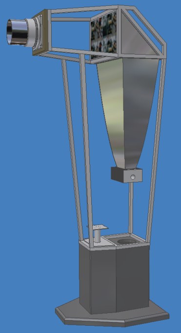

Here was the first conceptual design model before I started working on the deep parabolic reflector.
Hezz

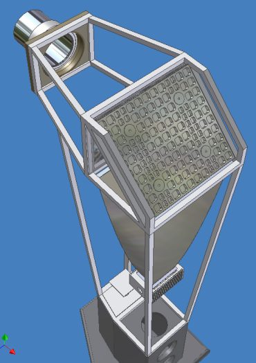

The above picture shows the two peice light engine assembly but consists of a long paramidal light pipe. The next picture shows the upper portion of the deep parabolic light pipe that I will attempt to make out of hand polished aluminum sheet. The large lens is to scale and I have started work on both the lens mounting and focusing mount. I have also build the frame all except for the lower pedestal stand. Real pictures later perhaps.

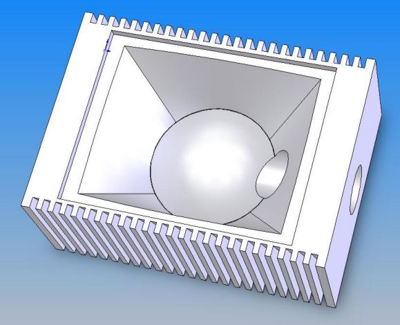

The bottom of the two piece light reflector is made out of machine and polished aluminum and has a recess for a piece of IR glass which captures much of the heat from the bulb and transfers it into the heatsink.

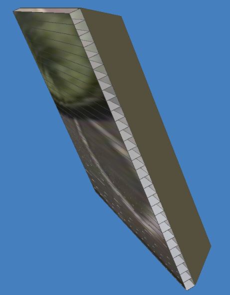

The light recycler reflector relies on simple and relatively easy construction methods. It has a backing of 1 1/2 inch thick MDF to keep the mirror flat. Then mirror reflective mylar film is bonded to the flat surface followed by a 1/4 wave retarding film.
Then square pieces of clear acrylic are bonded in rows with reflective mylar film bonded to all of there sides with the shiny side facing in.
Finally the initial mirror surface is bonded to the acrylic pieces and is a polarizing reflective film that reflects one polarization state at 45 degrees and lest the other pass (from the front). Light of the incorrect polarization state is reflected into the cube and bounces and make two passes through the 1/4 wave retarding film.
The success of this recycling reflector depends on being able to find and inexpensive polarizing reflector that has the correct behavior. I have seen illustrations on some web sites that show this principle.
Any help with sources for the right films would be appreciated.

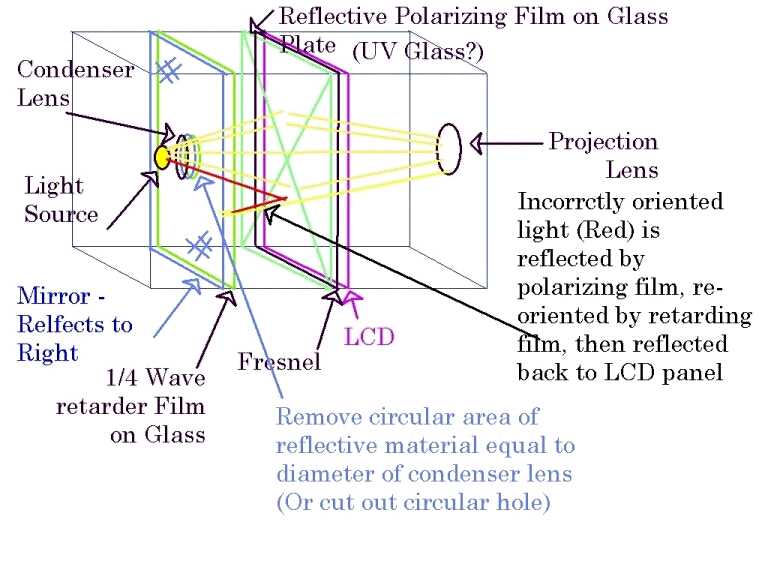

I have simpler ambitions. Would you mind giving me your opinion on my simple design for a light recycler? This design is based on using a bulb with a condenser lens. The light passes from the bulb, through a mirror with a circular area of reflective material removed. It passes through a 1/4 wave retarder that also has a circular area removed. Then it passes through a reflective polarizer (could be film attached directly to the fresnel, although I like the idea of a sheet of UV glass.
Properly polarized light will pass directly through all of these and illuminate the LCD panel. The rest of the light will be relfected back through the retarder, be re-oriented 1/4 wave, then bounce of the mirror, be re-oriented a further 1/4 wave, then pass through the polarizing filter, illuminating the LCD.
Now the big problem: Where do we get the 1/4 wave and 90 degree reflective polarizing films?

It's nice to see someone else trying to impliment a light recycler. I have looked at your design and it is quite ingenious. It should quite well and the beauty of it is that it can be easily implimented.
I would make sure that the entire enclosure from the first mirror to the polarizing reflector is lined with highly reflective material on all sides because you will get light bouncing around at all angles and you want to trap all of the light in this area until it can exit with the correct polarization state.
You could also completely surround the light source with reflective material as a lot of stray light goes off to the sides. With your system you could also eventually recycle some of this light if you made the first mirror reflective on both sides. The stray light would bounce around in the first light chamber until it found it's way through the hole and the condenser lens.
Also, as you probably already know make sure to use a spherical reflector behind the light source. In theory you could have light bouncing back into the reflector and out again to eventually be properly polarized.
3M makes some reflective polarizing films called vikitu. They have a web site. Search for Vikitu films.
I found at least one company that makes 1/4 wave plate thin film retarders but I lost the link. If I find it again I will post it here.
Good work and best wishes on your project.

Thanks for the reply on the Light Recycler idea. Lining the entire box with reflective surfaces is a good idea. Of course the light will not reflect off of the screen directly to the mirror!
Also still thinking about the light reflector behind the bulb. Ideally you'd want a reflector that focuses ALL of the light onto the condensor lens. Not sure if the Norpro bowl/ ladel accomplish this, or if I should go with a spherical mirror combined with some other reflective surfaces. Guess I'll have to experiment.
Now that we've found the manufacturers of the polarizing films (3M, Optigrafix) the problem seems to be finding the distributors. I'll keep looking, too.

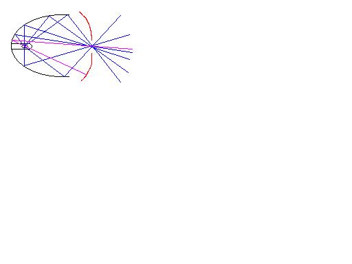

I think the best you can do for a reflector is to combine an elliptical reflector with a spherical reflector to recycle the rays that missed the elliptical surface. Look at the drawing. Blue rays go from the lamp arc to the elliptical reflector, and on the the second focal point of the ellipse. Violet rays are sent back from the red spherical reflector through the lamp arc, and into the elliptical reflector path. The only rays that miss the reflectors go directly from the lamp arc through the hole in the spherical reflector.
You can make the reflectors the right size to give you an diverging beam of light that fits your lower fresnel. For example, if you want to fill a 15" lower fresnel with a focal length of 220 mm, then the diverging light cone should spread to 15" at 220 mm from the second focal point. It is easy to work backwards to see how wide your reflectors have to be to give you any shape light cone you need.
The small focal point at the hole in the second reflector is also an ideal place to put a hot mirror! Now all we need is somebody who can do some aluminum sandcasting or sheet metal stamping of reflector sections.

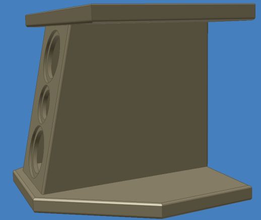

One of the things that I have had to change around in my home theater space was where the television was. It will be necessary for me to retain the Mitsubishi 27 inch television because some members of the family may want to use the regular DVD or VHS player and view something on the TV like the news.
The problem I had was that the television rests on a custom A/V stand that I made and I liked the TV higher than usual so it was in the way of the wall where I needed to project the image. I moved the A/V stand again'st the right hand wall and put the TV on a low table. This has left me with enough wall space to project on but left no place for the center channel speaker except to lay on the floor. So I decided to build a unique tv stand center channel speaker. This is somewhat of a compromise for the big screen projector as it would be more ideal to have the speaker up towards the bottom of the screen but there just wasn't room.
So I designed this pedestal TV stand and center channel speaker combination. I have it built but no pictures as I don't have a digital camera and don't want to go get 35 mm film developed to disc right now.
Here is a picture of the first conceptual solid model. The final was built to high end standards with lots of internal bracing but the outer dimensions and shape remain the same.
Hezz

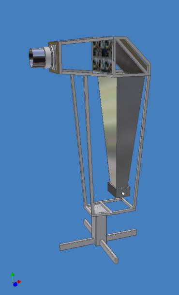

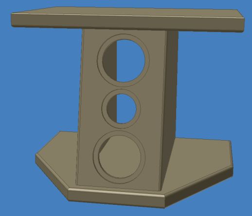

I have a few design updates to post on the progress of my projector.
Yesterday I did some more work on the frame and I welded some parts that I had machined to make the frame attach to the roll around bottom of the office chair that I had gotten from surplus sources.
After, mounting the frame I found that there was too much play and movement. I took some pictures at this stage but I am going to wait to have them developed later as I have more pictures to take.
I have come up with a different frame mounting scheme and I post the concept model here. I will continue to use the bottom of the chair for developement until I get the exact height zeroed in. The new base will be made of painted MDF and will house some of the electrical junction boxes and the fan which will blow upwards towards the bulb reflector heat sink assembly.
Two large holes will be cut in the bottom of the base and covered with a couple of used 6.5 inch speaker covers that I have. Maybe with thin felt filter inside to lower dust going in.
The magnetic ballast transformer will be housed in the aluminum shield which is mounted near the bottom next to the fan.
Hezz

I guess I got the images mixed up as the above does not show the magnetic shield. The transformer will be glued with silicone glue to a thick rubber puck on top of the little pedestal at the bottom of the frame. This is really the mount for the roll around castor assembly but it will serve as a mount for the transformer.
Since the light recycling reflector is an experiemntal thing I have decided to use a first surface mirror at first to get the projector going sooner. Because of the size of the first surface mirror I decided that it might be kind of expensive to buy so I am gong to hand grind my own. It will be made from a 3/4 inch thick piece of aluminum and machined on the rear to make it more stable. It will give me something to do on the Mazak VTC-16 at school.
I think that you can see the back of the mirror and it's mounting scheme in this model picture. Stay tuned, I will be posting pictures and information on how I'm making the mirror.
Hezz
