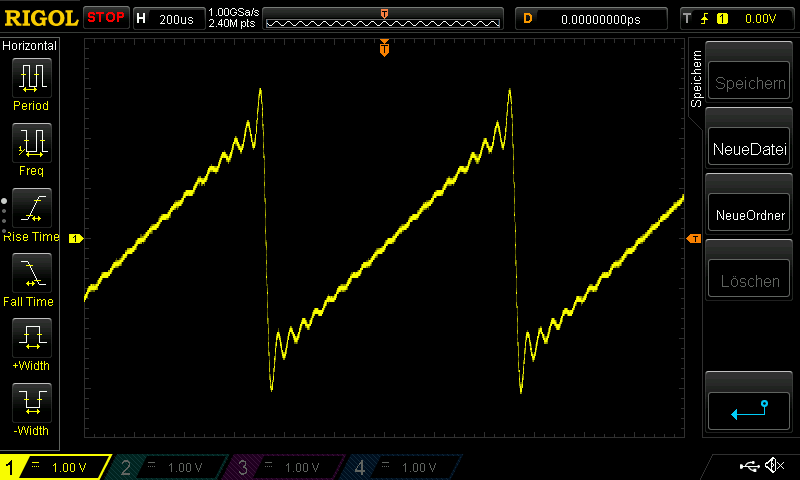

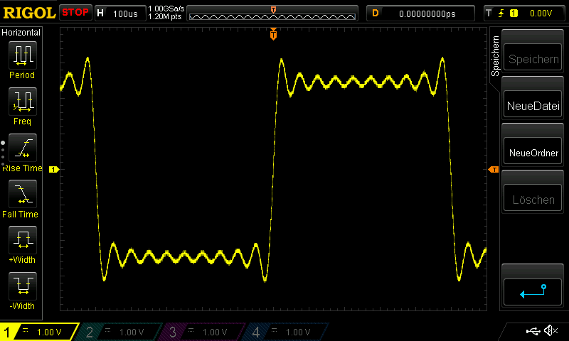

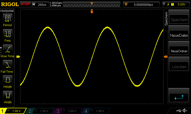

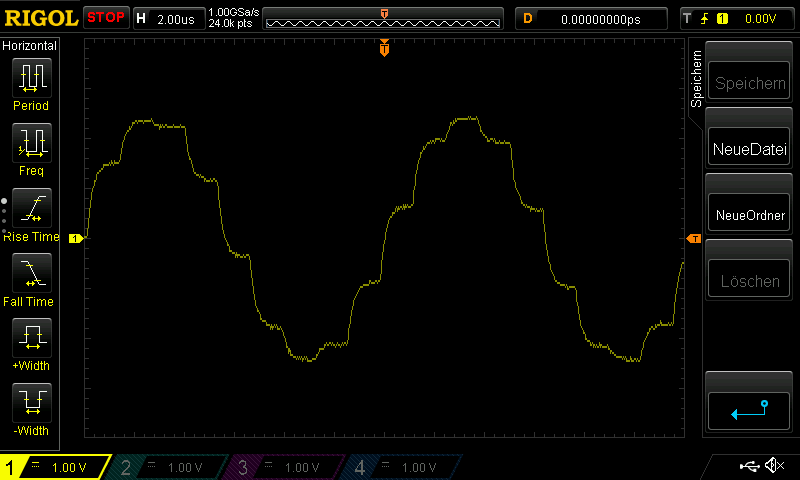

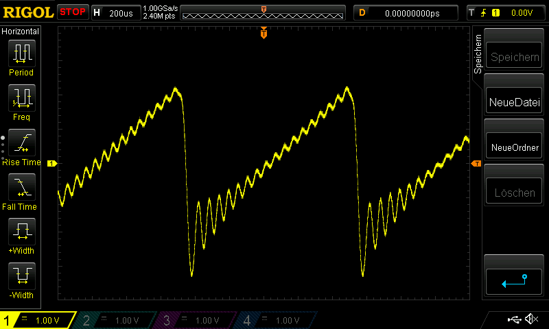

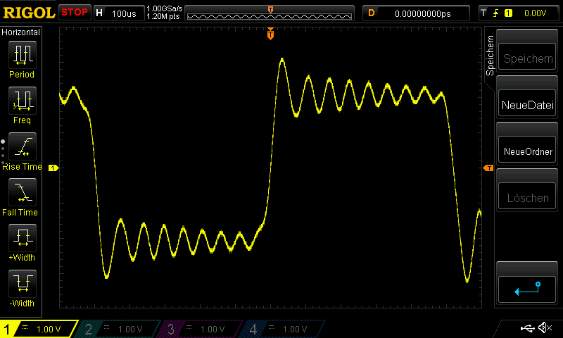

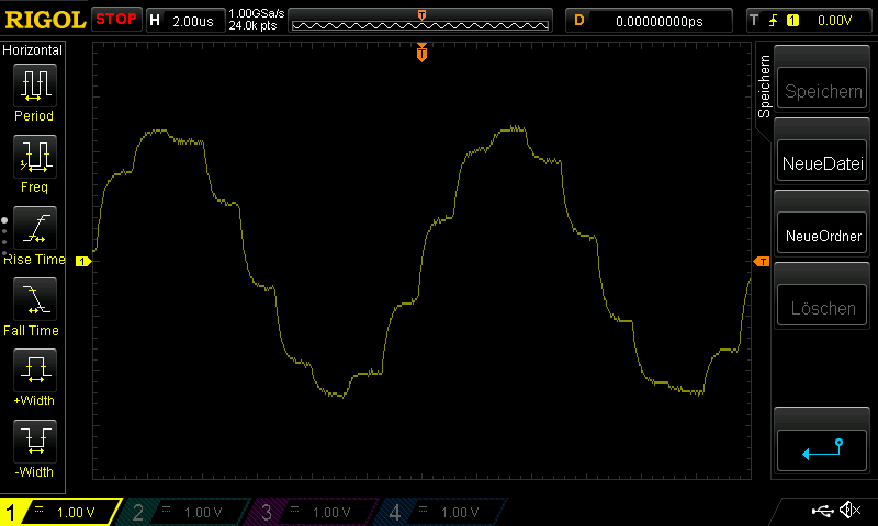

I completed my DAC with AD1862 DAC and it sounds great. I attach some scope shots taken at the analog out from Audacity generated files with both filter settings at the 16x filter board. I don't understand what's wrong with the 60kHz sine since the 80kHz looks fine. Also why do sawtooth and square waves look so damaged? On my other DACs the signals look much better, but I am still not 100% sure about Audacity. Music playback looks good on the scope.

@jpk73 By the way, since I got notified by response within this thread and I am sure someone will ask about your scope shots. If I recall correctly the internal coefficients of the filter attenuate the signal by 1 dB. This is enough for a sine, but not enough for example square wave (which consists of infinite amount of sine waves). In basic mathematical principle for square wave we need 3 dB of attenuation compared to sine wave. So to avoid overshoots you need to attenuate the input signal a bit more (by extra 1 or 2 dB, depending on the signal itself). This is perfectly normal and expected behavior. I chose only 1 dB of internal attenuation based on bunch of tests I did back then which led me to conclusion that most music signals will not create any overshoots after interpolation.
OK, I removed the scope shots and took new ones with attenuation:
