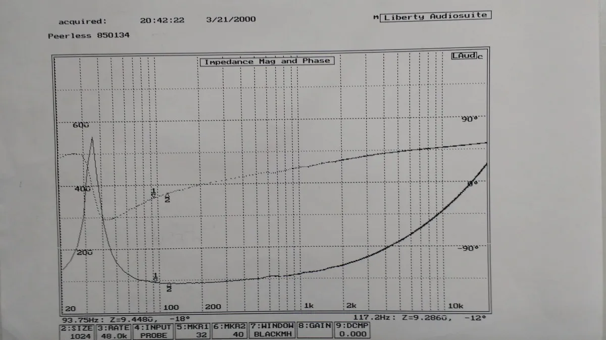

I am using
- Focal TC90 TD5B 91.5db sens (x2)
- PHL 2011 B201-16 (puchased at Orca Design about 15 years ago) 94db sens (x2)
- Peerless 850134 88db sens (x4)

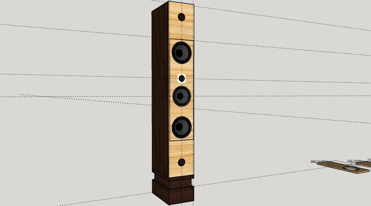

My idea is to built a WTMW Design. I already have someone working on the woofers Enclosure design. They will be ready this saturday.
It´s mainly going to be used in a Recording Studio. I am really tired of spending lots of money on cheep sounding studio monitors. If it is not ATC or PMC it´s not worth it. That´s why a couple of years ago I buildied my own with this PHL Woofers (actually someone else did it) But I just realised they are 16ohms! I like the sound though, a little bit midrangy, but very reveling at the same time.

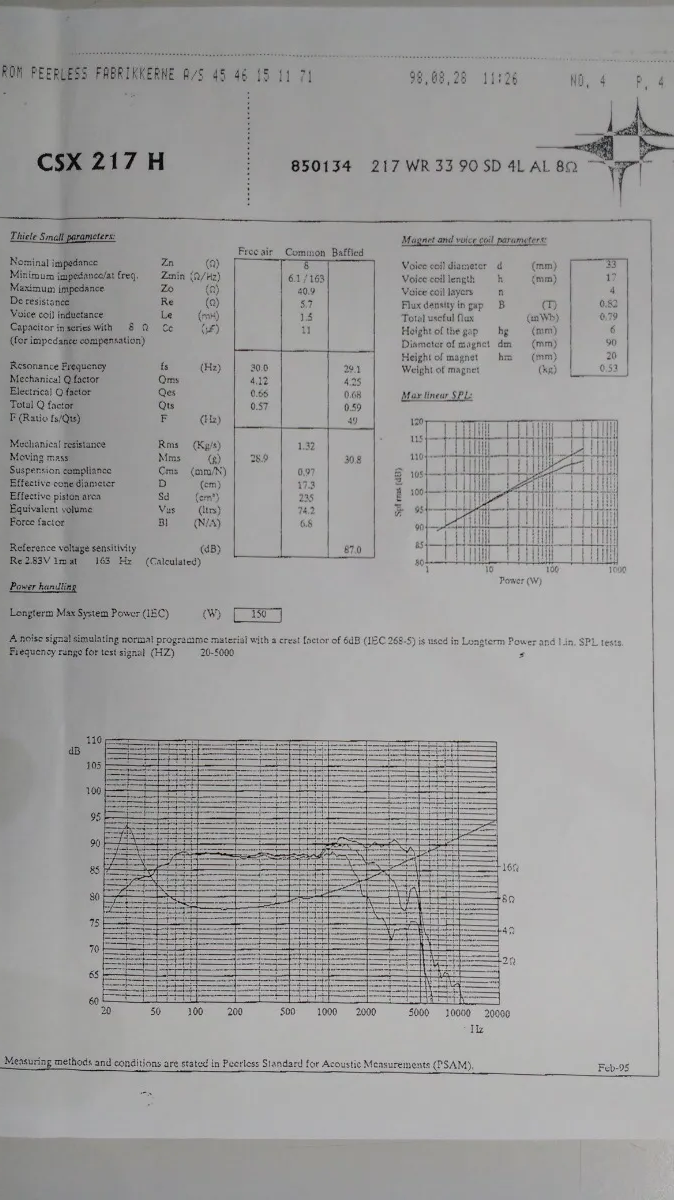

I´ll attach some documents! Some help and tips are more than welcome!
Here they go!
Well if you're going active then you might as well go three way, and remove all the confusion that passive components throw in there, especially if you're main hobby isn't filter design.
But I can see why you want to use that PHL, that's amazingly sensitive. It's the Focal that's going to be the laggard here, but it is the TC90, so not exactly awful, you have a potent set of drivers there.

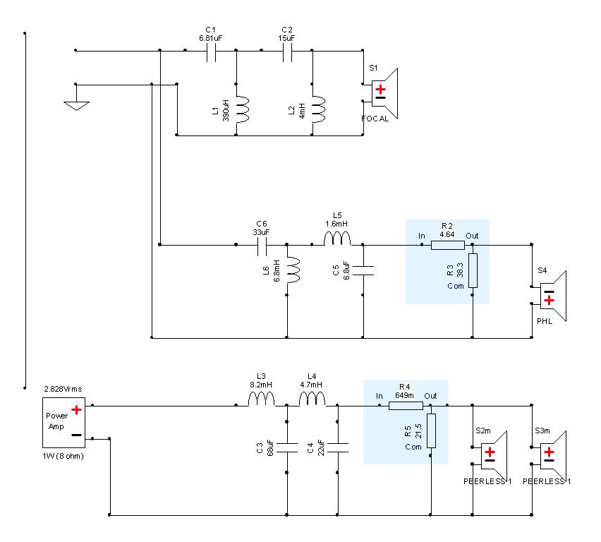

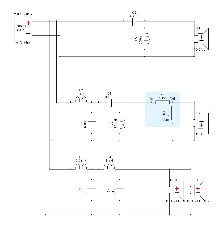

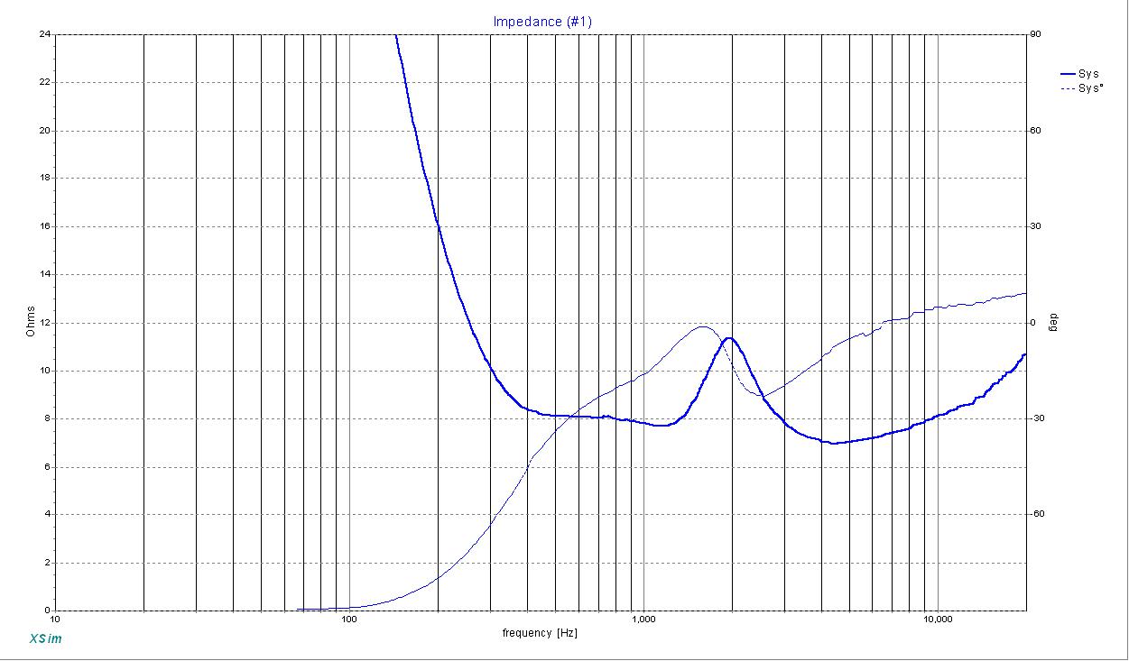

Talking about xovers. Using Xsim. Is there any chance of adding another amp in the system? It would be so much easier to emulate the system I want to use. Bi Amp Lows & Mid-Hi´s.
If not, I am always troubleshooting with Lows Impedance messing up my mid-hi :/

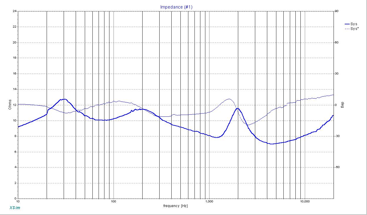

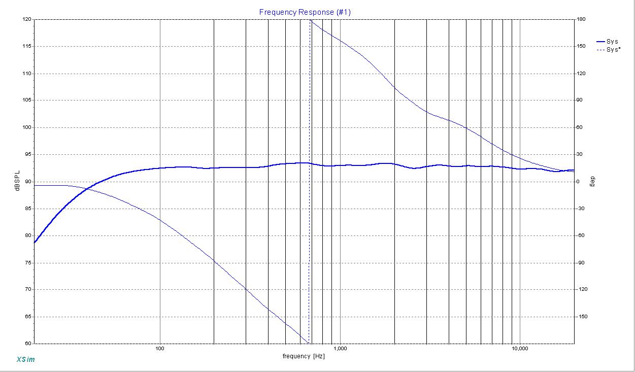

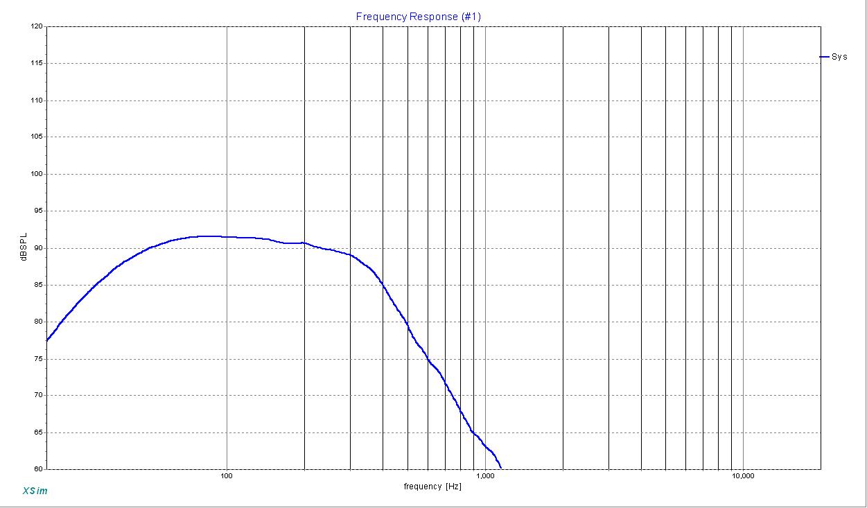

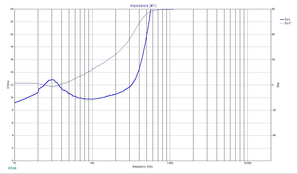

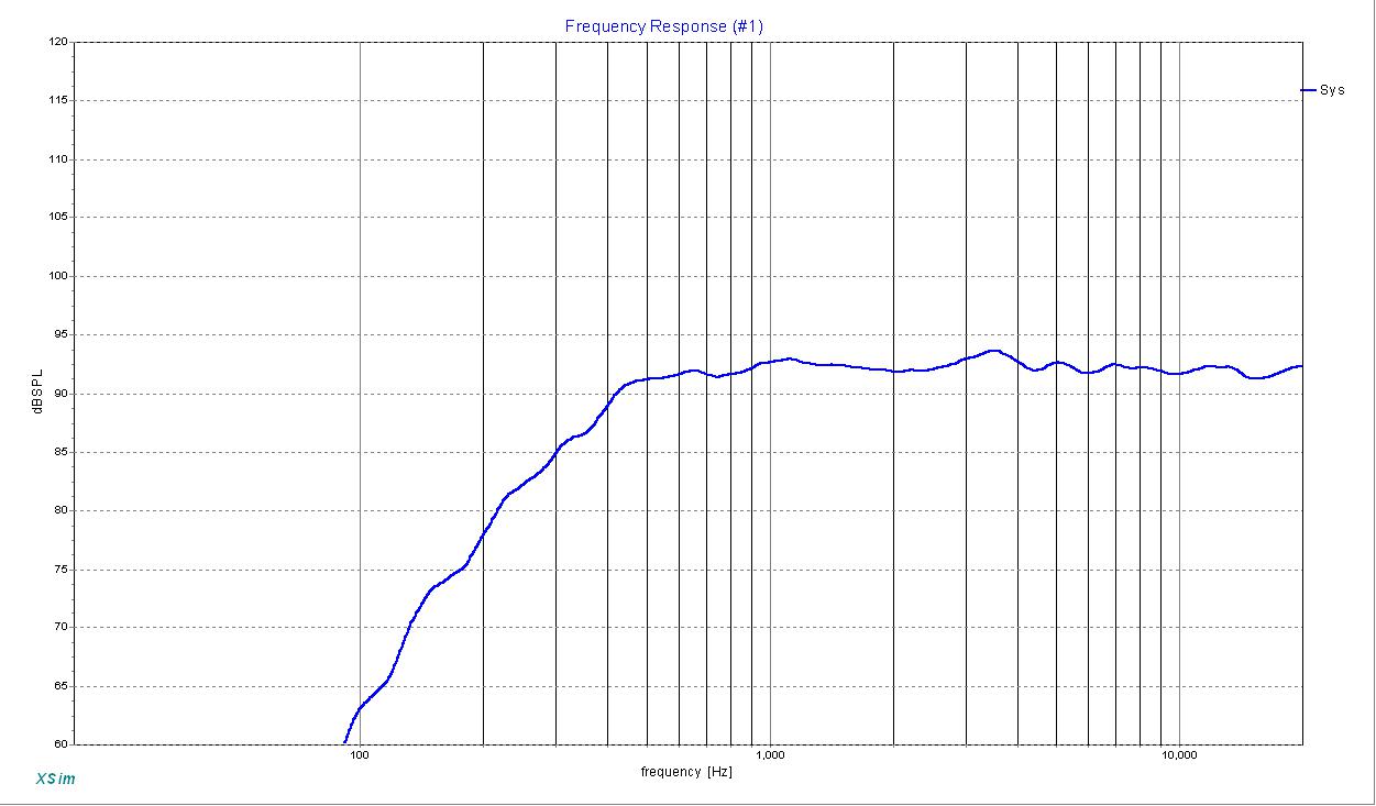

Here are some simulations I have been doing!
I like the RTA response. Don`t pay attention to the L-Pad on the Peerless. I just added to have a better view of the final RTA Response. It will be controlled by my monitor controller with a separate Stereo Output specially calibrated for it.

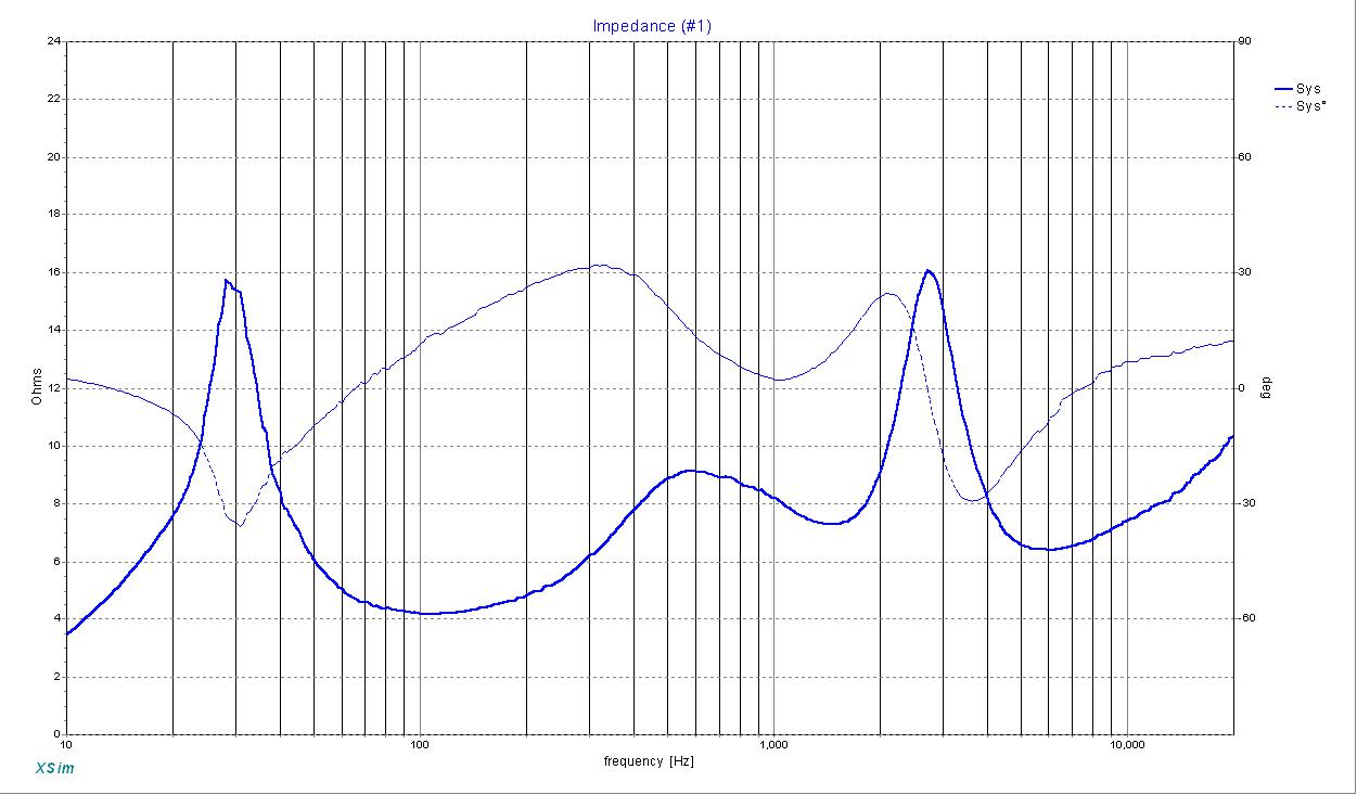

I am having troube with the impedance curve though. What do you guys think?
Cheersss!

You seem to be making progress.
I'm not sure your system wouldn't prefer a downward tilt toward the treble. What don't you like about the impedance?

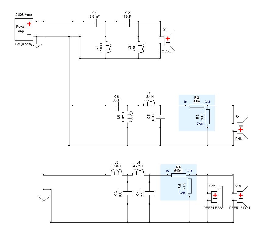

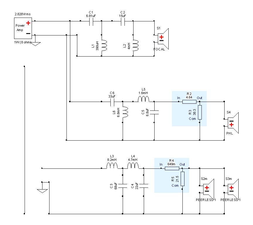

Hi Allen!
Thanks for that!
I saw the graph a little untidy respect to frequency. But I guess that not a big issue... Anyways, I have been studying the design this past week and got to this result (attached)...
I think I´ll go for a first prototype this next week. Hope it works well!
Any suggestions?
btw. I know what ESR means in a capacitor, but XSim gives you the chance to change this value. Which affects heavily on the design. Does anyone knows what standard value should I use?
Thank you all! :)

diyAudio Moderator
Joined 2008
I would worry more if there weren't any impedance variations in specific locations, or if there were variations where they shouldn't be. You seem to be within tolerance at the moment.
Have you considered that a box will not keep things consistent for you? Baffle simulation might give a minimum of information that you should consider.
