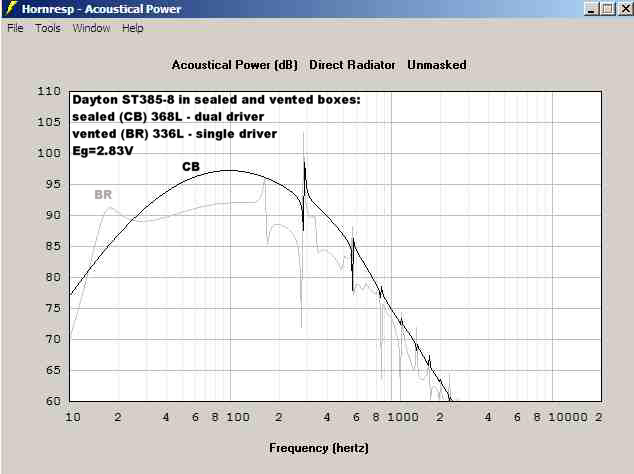

As you already have the amplifier, box and one driver I'd recommend getting a second driver, and running both in parallel in your current sealed box.
The alternative is a single driver vented version of your box, e.g.; using 2ea. 6"I.D. x 35" long ducts to tune the box low enough to get to your 16Hz goal. This should work too. There will be a strong group delay peak around the vented tuning frequency, and there will be strong pipe resonances from the tuning ducts.
Both versions will need a high pass to protect the driver from over-excursion; e.g.: for the vented box 4th order @ 16Hz.
Getting down below 25 or 30Hz w/ authority is just difficult. Ideally, you'd be looking for a driver(s) w/ much higher Xmax and power capacity.
P.S.: One graph @ 2.83V the other ~ Xmax.
