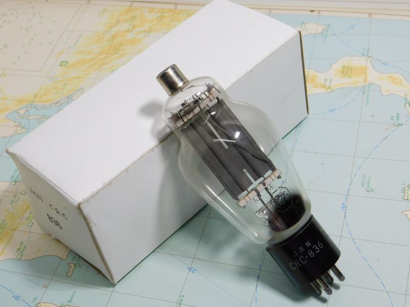

Yes,thanks for the suggestion! (drool) 🙂Food for thought. 836 (2.5V 5A - 5kv)
I don't have these but I see they can be found on eBay...great alternative!

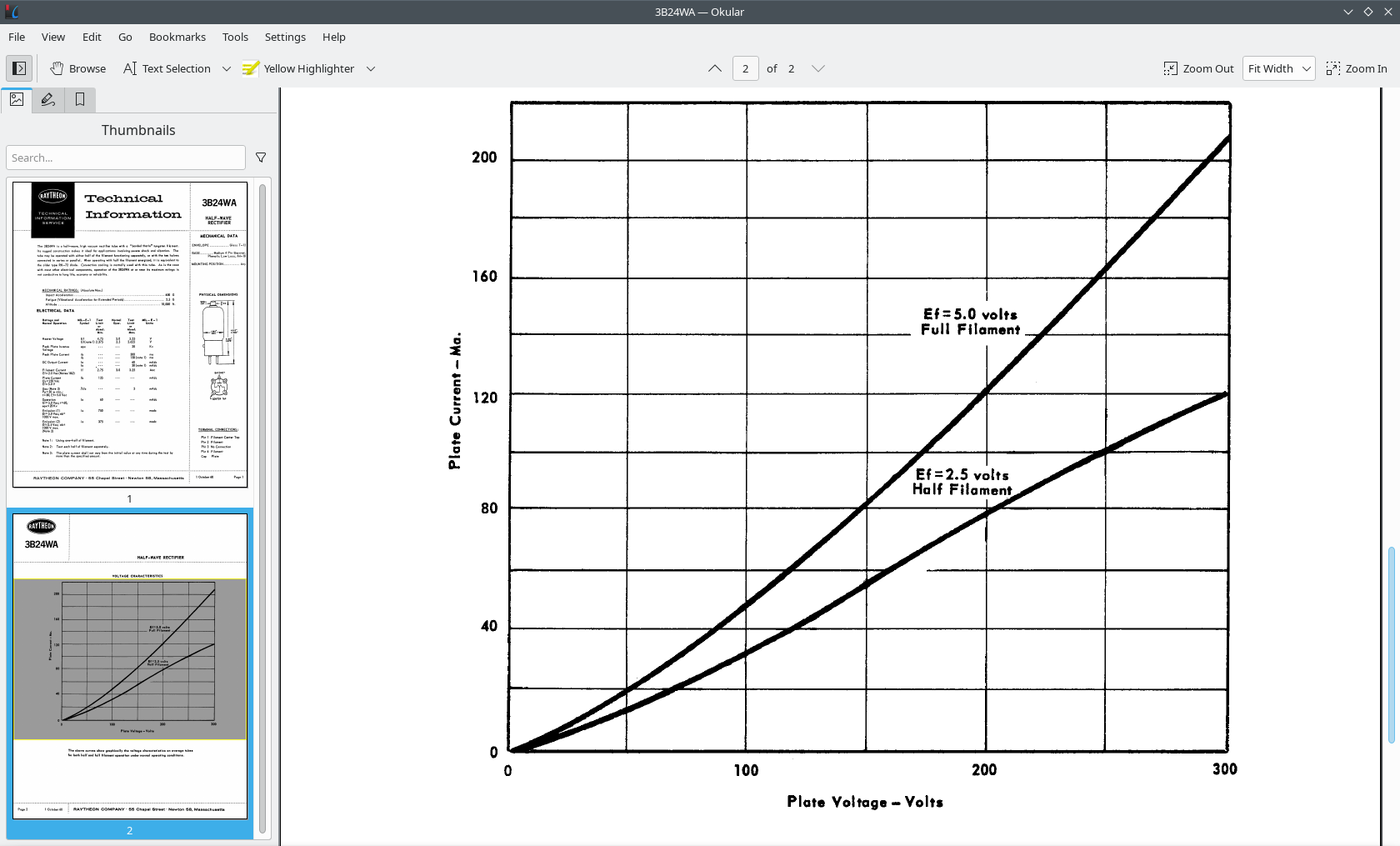

3b24 looks to be just a vaccuum rectifier without any sort of gas. More suited for a 5KV supply than 1KV. You would probably need to use four 3b24s to run a pair of 813s SE as far as plate voltage.

@ daqvin_carter I'm aware that the 3B24 is a vacuum,not xenon-filled tube.I was only implying that the're the "little sisters" because of the "3B..." mark,nothing else.Also,they have a 5V CT filament and heating really fast (specs indicate 2 secs. !) so it looks like the pre-heating issue is futile (please correct me if I'm wrong).
As far as my intention is to build monoblocks,I was thinking of use a full bridge of 3B24 per channel ,just for the output tube's HT supply so four of 3B24 might cover the needed current.Projections are centered on a SE 813 or GK-71 in triode mode,B+ of around 950-1150VDC @80-100mA per tube.The 1616 and xenon-filled 3B28 are next candidates (in a voltage doubler,of course - two retifiers per monoblock) only if the 3B24's don't deliver as hoped.As for the amp's config,the Millett's 12HG7/12GN7A suggested drivers are an appealing choice,both technically and for the sake of simplicity.However,the driver thing is a development subject as I have other candidates in mind (EL12 Spez. or even E2D ,both in triode mode,preceeded by some small tube w/ high transconductance ).The input and the driver,whatever they'll be,are of no concern because they'll get the "juice" from a separate HT section.

You have to look at the on resistance of the 3b24. It is about 1500 ohms. Rectifier losses would be fairly large. The 3b24 is made for higher voltages than you need.
I was a little off on my assesment that plate resistance was a little lower at 100 volts. Flatter horizontally means higher resistance.
