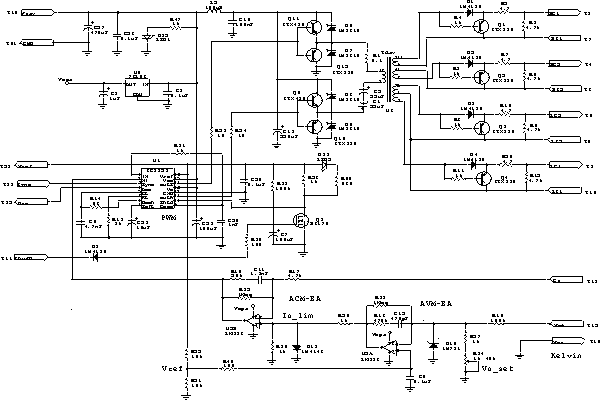

Ok, I already have results. The type of output diodes is essential and definitely the rectifier need freewheeling diode. This reduces rings significant. I am not sure that I have enough capacitors after the graetz.

Here is the PWM. I limited the output current with D15 to 7-8A. With some type of diodes(STTH3010) I am hearing a very bad sound from the transformer, no other bad effects, though (heat, fire, smoke, etc). With BYT30 it is working almost perfectly.

If the freewheeling diode before the inductor reduces ringing, then there is probably some room for improvement in the layout of the windings of the main transformer. How did you wind it?
The two secondaries should be wound bifilar, preferably in one layer. The primary should be split in two halves, one layer each, and the secondary layer should be sandwitched between the two primary layers. The right amount and gauge of magnet wires should be chosen to get a good filling of the width of the coil former, without gaps between wires in the middle.
Note that if you change the rectification scheme into full bridge, you may be able to use lower voltage diodes which usually perform better.

You are right as always. I will try with bridge rectifier. But I think that the close values of the primary and secondary windings cause hard sub harmonics in some load condition. On ocasions I see different ringing at odd and even pulses after the diodes and before the inductor. The current sense amplifier is trying to compensate this. With RC between hot secondary (without RC over the diodes) the pulses go in equilibrium, but the first sine becomes greater than half rectified pulse. Any way, the ps is stable, no heat.
My transformer is wery tightened, but consists of one layer primary and bifilar secondary in two layers. I will try bifilar secondary between bifilar primary, just for comparison and then go to bridge rectifier.
In this topology the secondaries should be perfectly matched (same resistance and leakage inductance), but it's just easier to use a single secondary and full bridge rectification (no more matching problems). Mismatched push-pull secondaries will usually result in suharmonic modes.
Sandwitched windings (1/2 pir - sec - 1/2 pri) will half leakage inductance. The primary halves should be wired in series.

So, it doesn't matter if I have 10 or 100 ohms resistors before the complement folower. The problem is average current mode controll with non ZVSw bridge and allmost 1:1 transformer. This brings very nonpredictive rings. But with proper RC dampfers its working fine. I am going to buld boards and all the mechanical stuff.

After a long period of experimentation I gave up on using average current mode with transformers, now I only use it in straight buck, boost and class D converters, where it works very well.
Consider peak current mode with sensing on the primary side, you can remove the coupling capacitor that way (and say goodbye to subharmonics). Some slope compensation would be required too.
Forget the turns ratio of the transformer, it's *not* in any way related to the problem.
