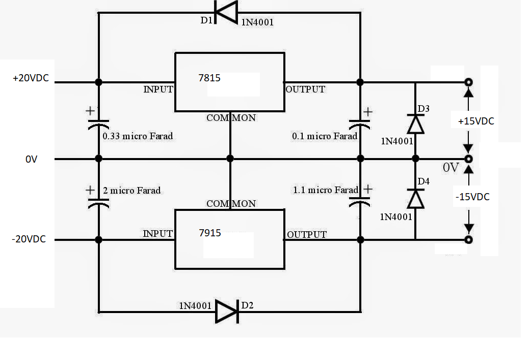

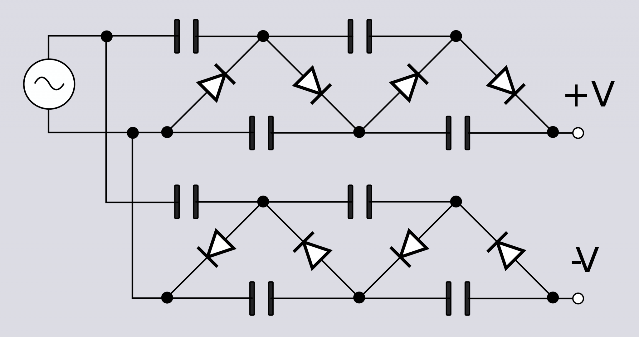

Maybe it's because I'm used to having 6VAC around, but I would just use a multiplier from a filament transformer and slap 7815 and 7915 on the end of it.

Yes, this is what I was talking about "slapping" onto the end of the voltage multiplier I posted in #22.

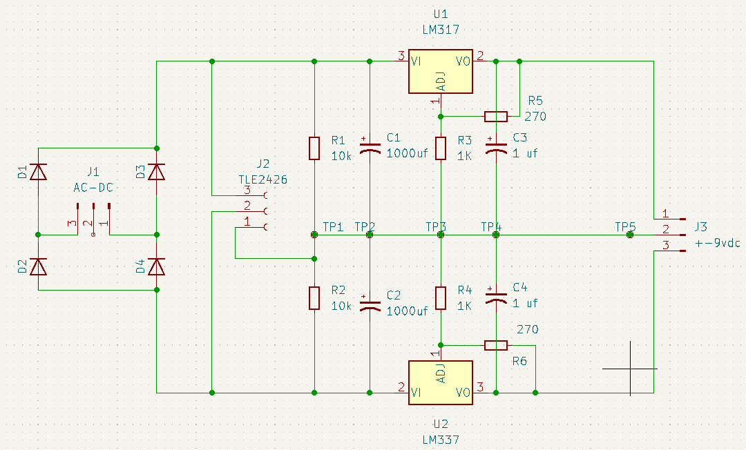

The typical AC-AC wall-wart does not have a secondary center tap which means the power supply caps are charging alternately 50 % of the time. Bigger caps are needed to keep the rectified DC well above the regulator drop out voltage.

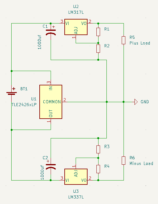

One option is to use a TLE2426 to split the rectified DC. The plus-minus loads must be balanced with the TLE2426 limits but you will have full-wave rectification which might be seen as better performance.

real ground results in a far superior spec. amp. Doubling the capacitors is much simpler than any virtual grounding schemesThe typical AC-AC wall-wart does not have a secondary center tap which means the power supply caps are charging alternately 50 % of the time. Bigger caps are needed to keep the rectified DC well above the regulator drop out voltage.
hhttps://nwavguy.blogspot.com/2011/05/virtual-grounds-3-channel-amps.html
one can buy 2 trannys and make dual isolated supply, if C.T. is hard to find

I reviewed the NwAvGuy article which is very good. I revised my model to have rail-splitter without shared ground. I do not like "virtual ground" since it is a vague abstraction. Absolute ground is always needed and exists before components are added to a circuit.real ground results in a far superior spec. amp. Doubling the capacitors is much simpler than any virtual grounding schemes
It is best to start with the simplest idea that can possibly work .. such as the O2 which has half-wave diodes and regulators. It is not necessary to worry about the lack of wall-wart center-taps.
There are a few use-cases where a rail-splitter is needed for portable operation from one battery. There are a few constraints such as the split loads must be equal. Crosstalk is more likely and must be managed in the PCB circuit structure. That is, the split supply sections must have own ground with a track leading to the absolute ground. I try to show this in the attached schematic.
I have seen some instances where a TLE2426 is used without regulators. I say don't do this since the TLE2426 is not a regulator like 7812 or LM337.

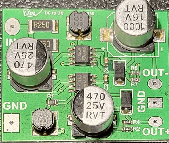

I found a board I bought that was designed to do 12V in, +-12 out.
I can't find it on eBay though.
Was it something like this one here?I found a board I bought that was designed to do 12V in, +-12 out.
That's about what I want to spend.
