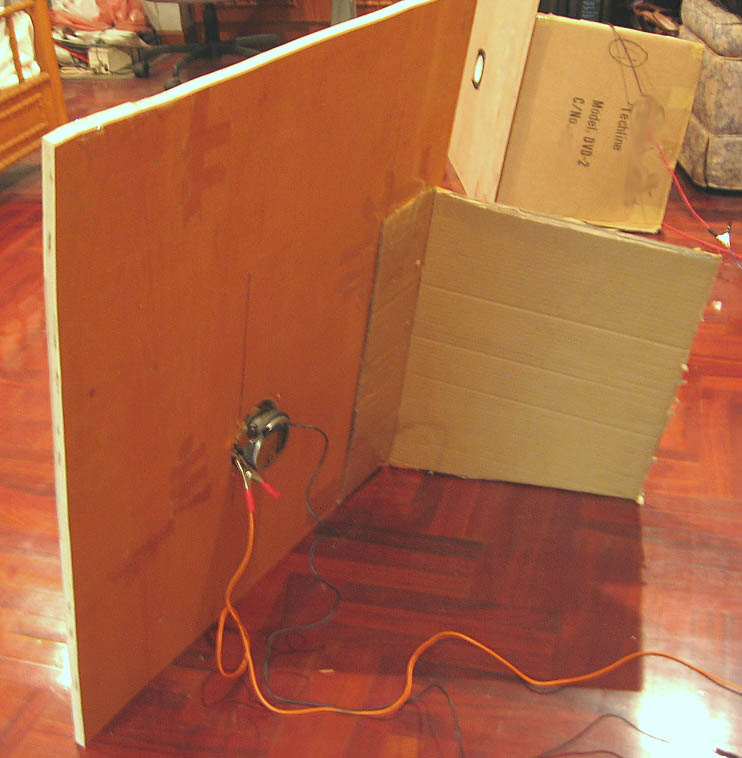

Test support of OB
since these were Tests to see
differences in Quality of Wood and
Thicknesses, i wanted MIN. Interaction
from anything else.....
hence, as you can see from the blurry fotos,
only one small cardboard pc attached with
good 3M tape on backside to angle it,
and point the plank at me.
thanks
k
Cal Weldon said:
Thanks for the update k. One more question: How is this board being supported? Is there any sort of bracing? Do you have a pic or two?
I guess that's 3 questions.
