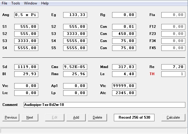

Right sub but its a D2 and the specs are a bit different...ill see if i can find a screengrab of the page.

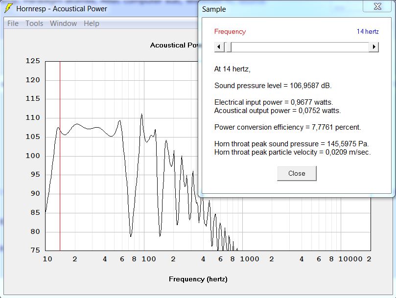

Hmm...the tapped horn sim looks cool about what id thought.

Hmm...This should get you started. Personally I would aim at 130 dB/m, which should be within the excursion capabilities of this driver.
FWIW, at down to 14 Hz I could only 'squeeze' ~127 dB [avg]/0.5pi/90 W out of a ~55 ft^3 net DSL concept TH and still get a usable ~ 1.5 octaves, though maybe one of those higher order TP/TH alignments can eek out a few more dB.

This one? I had to search to find it on pg. 8, post 221 of 422. Lately, this happens with every link from here to AVS 🙁: https://www.avsforum.com/forum/attachment.php?attachmentid=8298&d=1338330165
GM
edit: just noticed this is a single driver.........found this dual TH sim as pdf in post #1: https://www.avsforum.com/forum/attachment.php?attachmentid=10511&d=1338336683
GM
I think those 2 TH's are for the house. The TH on post #141 is for a pickup bed. Instead of 4 subs, build it for 2 subs to lower the tuning.

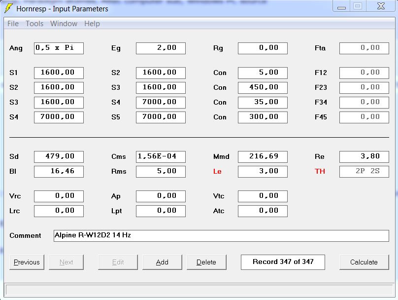

4 ALPINE R-W12D2 in a 3 cubic meter ROAR will comfortably hit 140 dB @ 14 Hz in a 0,5 pi environment. If your car cabin is structurally strong and stiff enough you will get upward of 10 dB cabin gain on top of this. 😱
The downside might be the 3000 liter box....
