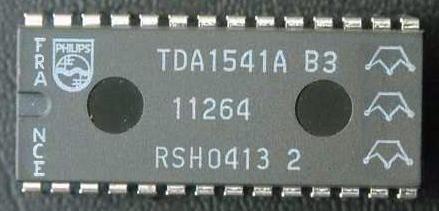

jean-paul said:Stamp them B1 😉
This joke is real stupid.
-51 and -56 are average values for harmonics in non os mode with 1kHz -60dB signal.
Nothing bad.
Bad is -47, good is -64.
Bricolo said:Why only B1? 😉
This chip must be
M
a
d
e
i
n
F
r
a
n
c
e

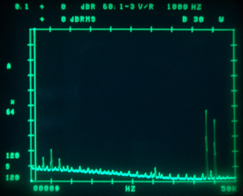

If you have the time, could you just show is the spectrum of a non os player, at a normal volume?
Just to see how big the 44kHz noise is
Yes, you already posted this
what I wanted to see is the amplitude of the 44khz compares to a full scale signal
Bricolo said:Yes, you already posted this
Yeah, send me a bottle of good french wine and I will see what I can do
Remember, this was with the analog filter that is inside the CD650, I did not remove it.

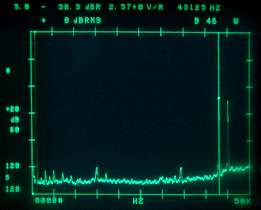

This is 0dB signal. Again 44kHz is -38dB.
It is displayed in the upper left corner
So it is proportional to the signal level.
That's what I was fearing 🙁
And this is with your player's analog filter? If you didn't modify it, I don't think it changes something, since it was certainly designed to attenuate the 4*Fs garbage

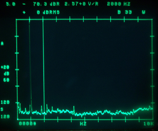

Bricolo said:But why do you test them with a -60dB signal? Wouldn't full scale, or at least half scale, be more appropriate?
For the chip, it wasn't written made in taiwan but only taiwan, do france would also be enough 😉
Not much harmonics to see with a 0dB signal. Just some garbage.
Bricolo said:That's what I was fearing 🙁
That's what is called amplitude modulation
