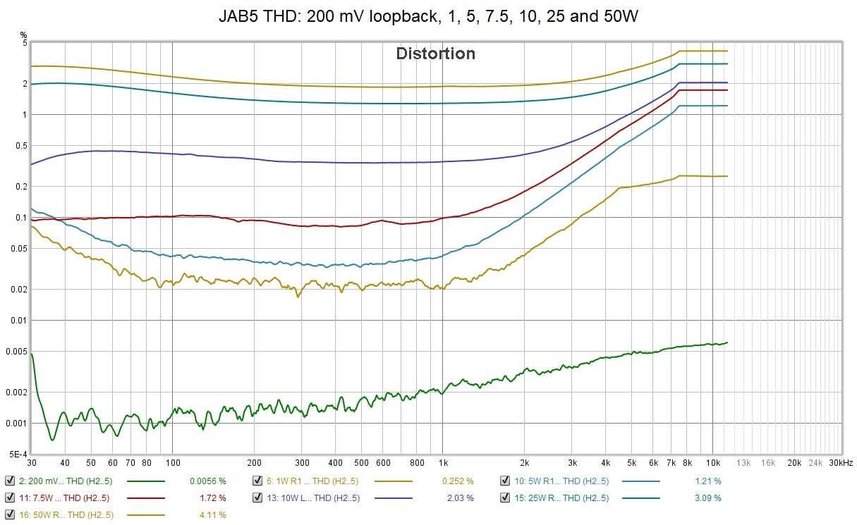

Manufacturers specify the chip's datasheet specs which is the best possible case. Inferior board design and components (cheap inductors and caps) can significantly degrade actual performance. As an example, I measured the Sure/Wondom JAB5 distortion at various power levels. I used the Meanwell LRS-350-36 (36V, 9.7 A, 350 W). I did use 4 ohm loads instead of the specified 6 ohms. In ay case, note that my 5W measurement matches what Sure published.

In some of the data sheet of the JAB-5 Sure writes the amp is a "TDA749x".

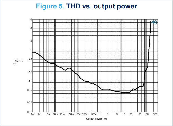

Which makes one suggest it is the ST "TDA7498e", because it is specified for 4 Ohm use at 36V. What not so many may know, the "x" Sure uses, includes a whole family of ST TDA amps, beginning with the TDA7481 at 2x10W! Which may explain your distortion figures.
I use some cheap 2 channel versions (not Sure!) of the real 7498e and this is an excellent D-chip amp. I'm quite sure it doesn't have any distortion problems.
This is from the data sheet, 4 Ohm, 36 Volt.
