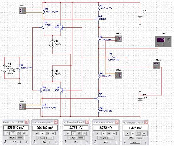

taking sreten's advice, I am posting the schematic I simulated in multisim. here it is.
not much of a difference, other than that I used an input resistor, and an output resistor. the key thing that I didn't measure until after reading one of sreten's earlier posts is the output offset. As you can see, there is a 1.4mv positive offset on the inverting ends of the LTPs.
edit: wanted to add that if I change R1 to 0ohm, and R3 to 22meg (effectively EVA's schematic), I get the same readings.
edit 2: DC offset is:
with 0ohm VAS emitter resistors: -217uv;
with 1ohm VAS emitter resistors: 31uv;
with 10ohm VAS emitter resistors: 910uv.
with 100ohm VAS emitter resistors: 1.423mv.
while the bases of non-invernting ends are firmly tied to 0v / ground.

So what voltage gain do you get with R1 = 0ohm ?
And V3 has an output voltage ?
(How does your simulator deal with the quandary ?
V3 = 0 ? or V3 = V3 ? )
Its not a good idea to ask simulators such questions.
(In Eva's original circuit the LTP pairs are forced to
be current mirrors as Vbe's have to be equal. Not
the real case.)
sreten.

sreten said:So what voltage gain do you get with R1 = 0ohm ?
only if you could figure out how to drive such a load,
sreten said:(How does your simulator deal with the quandary ?

maybe that's where the problem comes from,
the whole thing may work like this:
the system will change the DC offset. the DC offset will also change current on the two collector resistors: higher DC offset will decrease the current going through the upper collector resistor (R2) and increase the current going through the lower collector resistor. As voltage drop off R2 goes down, Q3 opens up less and decreases the DC offset.
the process stops until the two VAS transistors reach about the same collector current. and the DC offset will then settle.
the currents are likely to dependent on device characteristics more than resistor values -> not good for manufacturing.
on the other hand, the process appears to be thermally stable: a decline in Q3's Vbe will increase its collector current, which increass the DC offset. that in turn will lower voltage drop off R2 to compensate for the Vbe drop on Q3.

I've given the whole thing some thought and concluded the following :
For the double ended LTP and emitter degenerated VAS you
choose your design currents. You then calculate the base voltage
of the VAS asumming the design current of the VAS and use this
and 1/2 the LTP current to set the LTP collector resistor.
You then connect them together, the results
will be near design values, hopefully.
Compared to a single ended LTP and VAS :
Each LTP pair cannot be balanced as accurately, but exact
balance is not needed as the double ended nature of the
circuit (which is balanced) cancels distortion the same way
a near exactly balanced single ended LTP does.
Given the balance of each LTP pair is not exact the actual VAS
current is not exact, it cannot be set as accurately / predictably
as in the single ended case.
This on its own is not a big deal, but the thermal stability of
the VAS current may be depending the biasing scheme used.
sreten.

sreten, I think you are right. The whole doesn't seem to be as calculatable as single LTP/VAS. I wonder how much variance there is in production amps using complementory ltp/vas.
thermal stability is not a problem as the VAS current drops when Vbe of VAS transistors drops. so it is self-stabilizing.
what I observed is that there are always about 200mv of voltage drops on the degenerate resistors for VAS. Not sure what caused it but it is pretty consistent. it may be a useful thing is setting up this circuitry.
Hi Sreten, All,
I also had this impression, but running LTSpice for temperatures from 15 to 40 degrees Celcius gave less than 15% change. Not really problematic, I assume.
I'd suggest some other points should be looked at:
- If you aren't pretty sure about your signal source, perhaps a follower should be put before the input, so that the current summing works exactly.
- Output stage: no comments on my post #69?
