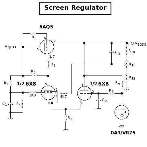

Yep. This was designed as a screen voltage active regulator. The 6AQ5 here is operating as a pseudotriode series pass element. It runs well below its PD rating for this application. Will need to be something else for this project. The reference voltage is from a 0A3 regulator (Octal type -- 75V) that doesn't need to draw much more than 7.0mA, as there is no current demand in parallel here. No need for hot, high wattage ballast resistors.
The error amp is an unbalanced LTP that makes good use of the otherwise hard to use 6X8 with its shared cathode. The pentode half is a high gain device which is what you want here, as it allows for enough NFB to stabilize the voltage and correct for ripple hum.
I'd totally use that 6X8 based regulator. I think I can make a noval tube socket fit in one of the holes for octal sockets. I'd have to buy a 6X8 or two, as I don't have any.
Would it be possible to use a 6AC7 and a 6J5 (or similar) so I can use up metal octals I already have lying around?

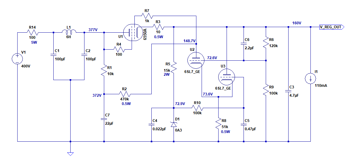

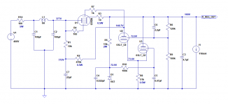

Thanks, I'm trying it out in LTspice. I can supply a .asc if that would be helpful. This circuit is attractive because I have all the tubes necessary in storage.
I substituted an 0A3 model (courtesy Stephie Bench). Fed by a raw B+ of +400V, and with a 110mA load, I get +171V DC at the output with the 50k pot cranked all the way.
Question:
Now that the 75V reference is in there, the 12AX7 triode on the left is running with its grid positive to its cathode by about 0.5V. The 12AX7 triode on the right is running with about -0.8 grid bias (still likely to draw grid current). Is this a problem in this type of usage?
Wait... Thanks to kward for bringing up 6L6GC or 6550 as a pass tube. These are good for 30W plate dissipation, and will drop a lot more volts than paralleled 6AS7 pair. Usually you don't want to drop that many volts, but here I do. I'm working on it...
OK, here's what I got.
400VDC in, 160VDC out. Its efficiency is ghastly.
Uses a 6550A-triode for the pass tube, a 6SL7 for the error diff-amp, and a 0A3 for the voltage reference. Those were chosen because I have 'em.
LTspice says the ripple rejection is really good. It also says the 6SL7 sections are both biased with a negative voltage on their grids, which I figure is a good thing. The 6550A is dissipating 25 watts. The 0A3 is drawing almost 6mA.
How's it look?
The 6550 looks like a much better pass tube choice here due to the very low VDC target output.
With the 6AS7, you must set the grid well below the cathode in order to drop enough voltage. The 6AS7 cathode is your output, so you're being asked to set the grid a good deal below the target output of 150V. The 0A3 sets the 12AX7 cathode to about 75V, so you have less than 150v-75v=75v to work with across the 12AX7. It just does not have the perveance to set the anode low enough. In fact, with a 400V input it doesn't look to me like you have any available voltage across the 12AX7 (just judging from plate curves here).
By contrast, the 6550 looks much better. To drop ~250V across it, the grid only needs to be 10-20V lower than the cathode. You still do not have much voltage room across a 6SL7 or 12AX7, but it's a much better situation than the 6AS7.
* A lower voltage reference would help, but I definitely understand the desire to add some glass for the fun/aesthetics of it.
* Although the gain of the error amp would be lower, you could also try simming other higher perveance dual triodes like 6DJ8, 5687, etc. That may give you more room to vary the output.
* A lower B+ than 400V will require you to drop less voltage across the pass device, both lowering dissipation and decreasing the negative bias required.
Cool parts bin project though!

I would go for a more simple solution.
Buy a cheap 24 or 25 volt 1 amp transformer and 'stack' the 115 volt transformer on top so you get 140 v ac or so. Then with silicon rectification you will have close to 200v HT which should be enough headroom for losses and proper regulation without the extra heat of another 150v at 110ma or so.
A VR150 /0D3 needs about 185v to work properly and 8 to 10 ma through it so it will need to go before the pass element. A 75 volt or 90 volt regulator might be better suited?

Also don't forget to bias up your pass tube filaments to the output voltage.
I think I would also consider biasing up the 6SL7 filaments. Since the pass tube filament circuit is biased at a different voltage than the 6SL7 filament circuit, it means needing separate filament secondaries. You might be able to "split the difference" so both heater-cathode voltage specs for both tube types are within tolerance, but I think that's a short cut measure. I would use separate filament circuits and bias each independently.

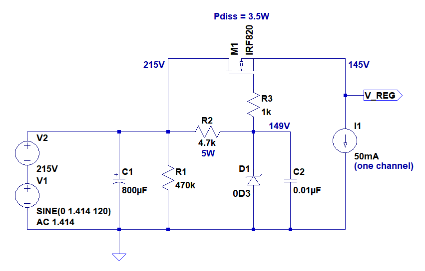

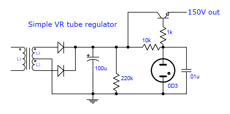

Here's a simple hybrid that I did recently with 0D3 and a MOSFET:
You'd still have sockets left over. Maybe use a tube rectifier or a couple damper diodes to use them up. Or build the above for each channel?
edit: IRF820 was what I used, I think. Ignore the transistor symbol.
Yes, I'd use two of these, one per channel. I have plenty of IRF820 and IRF840. I even have a few heatsinks. Two 0D3s glowing would be doubly fun. They also don't make heat, which is a plus. I'd still have room for a 5V4 rectifier or something like that, if I really needed to fill that last octal socket. But I don't, really.
I also have a couple of vintage 500VCT 150mA transformers with 6.3V winding (but no 5V winding). I could use a choke input filter and get about +215VDC raw B+, then use this source follower-plus-0D3 after that, right? Okay, some questions about this:
- How much ripple rejection should I see from this circuit? If I set it up with +215VDC at the input with a 1.414VAC 120Hz sine wave riding on the DC. I see +145VDC at the output, but with only about -20dB of attenuation of that 120Hz sine wave. It does perform some voltage stabilization; it keeps the output voltage within +/-1VDC as the input voltage is varied +/-20VDC.
- This is with the IRF820 dissipating 3.5 watts, so a heatsink will be required. [Edit: It's labeled "Pdiss" on the schematic, but of course that should be Ddiss. Was thinking tubes again. Oops.]

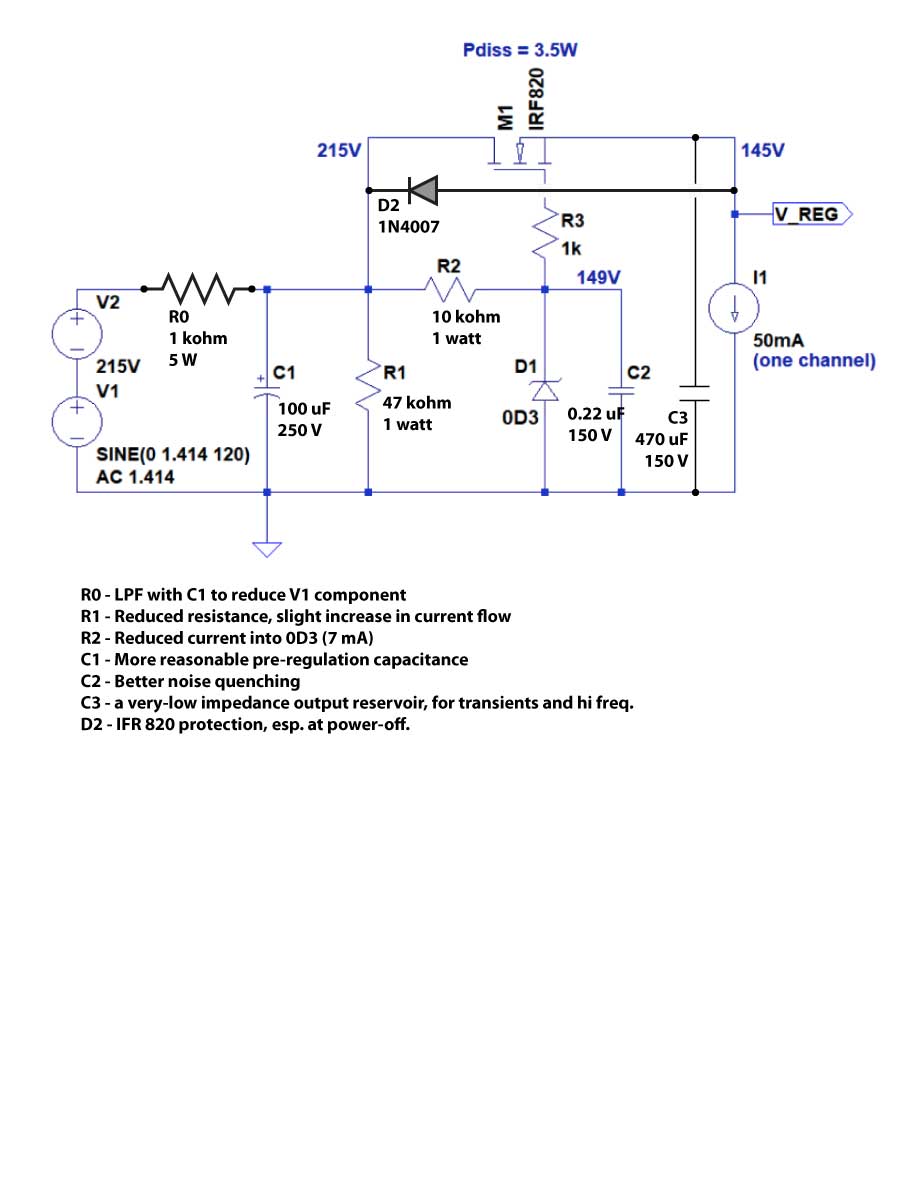

Does this attached schematic look right?

Looks correct! You might add protective zener to the source/gate or diode across the FET like GoatGuy mentioned, but what you have works.
The ripple rejection on this isn't as good as a feedback regulator like the series/pass ones earlier in the thread. Maybe a CCS feeding the VR is worth a sim?

Would the CCS replace R2 (4.7k 5W) in the schematic?
(Edit: If you meant just replace the whole thing with a series CCS and shunt 0D3, then no, that doesn't work nearly as well. Much higher levels of pwr supply ripple pass through.)

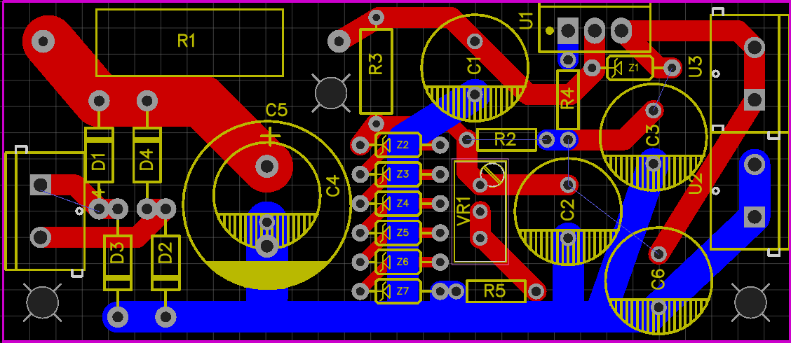

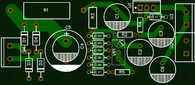

Since these types of circuits work so well, I decided to work up a PCB with the option to run a stack of six Zener diodes as a voltage reference, and a pot/resistor in series across them for some voltage adjustment functionality. I've breadboard six so far, and wanted a nice board to be able to have them easily lashed up for future builds. I'm even working on a negative version. Assuming you used six 51 volt Zeners (like the 1N5262) you get just around ~300 volts out with an IRF820. Could easily run wire off board to a VR tube to use as a reference 🙂
It's still a rough draft, but if anyone has anything to suggest, go ahead and swing by my flea amp thread and let me know what you think. I'm wanting them to be a nice option for the DIY community.
(Note- I'm not actively selling anything at this time, simply throwing out the idea, and taking suggestions for anyone who has something constructive to add!)

Right, I was referring to replacing R2 but maintaining the MOSFET pass device.
Lingwendil's board looks good too. I recently made some boards that use an LR8 in place of the zener string (yet to stuff and test though). Only problem is these don't glow 🙂
