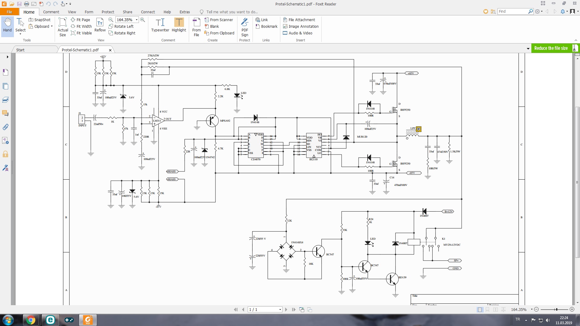

I could not measure the frequency of the circuit had run.

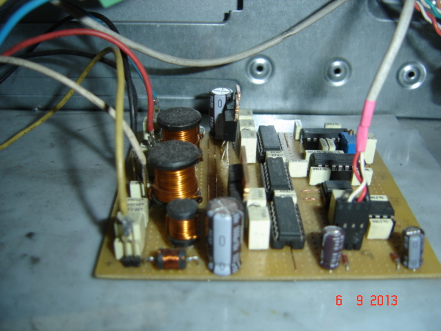

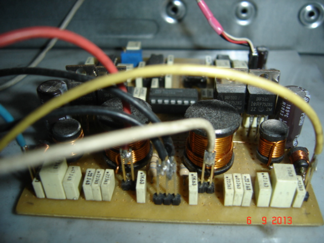

It is a very important data, because the kind or type of core to be used depends on frequency. As a initial test, try the drum cores from (Mainly) PC CRT monitors, as they are open magnetic circuit with large air gap, it will not saturate.
I use them in my intra-PC class D audio amplifier.
