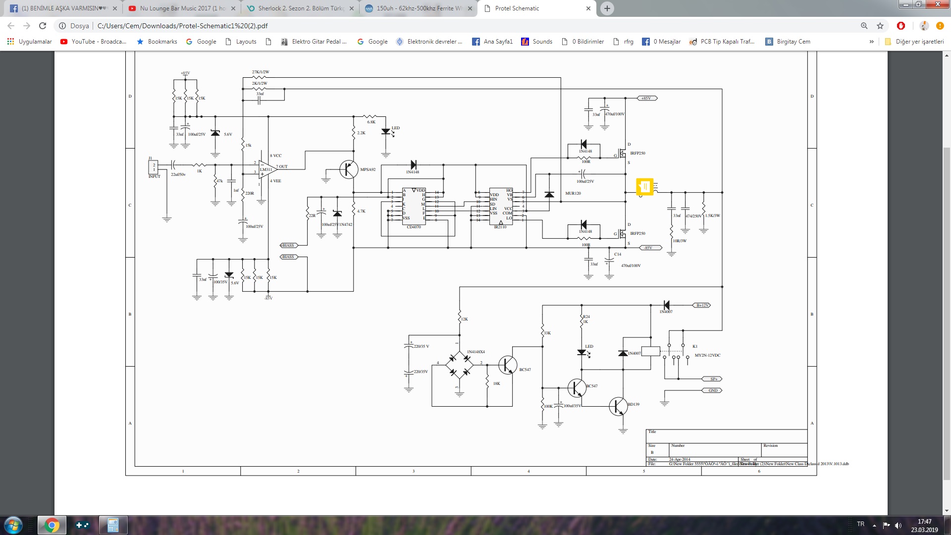

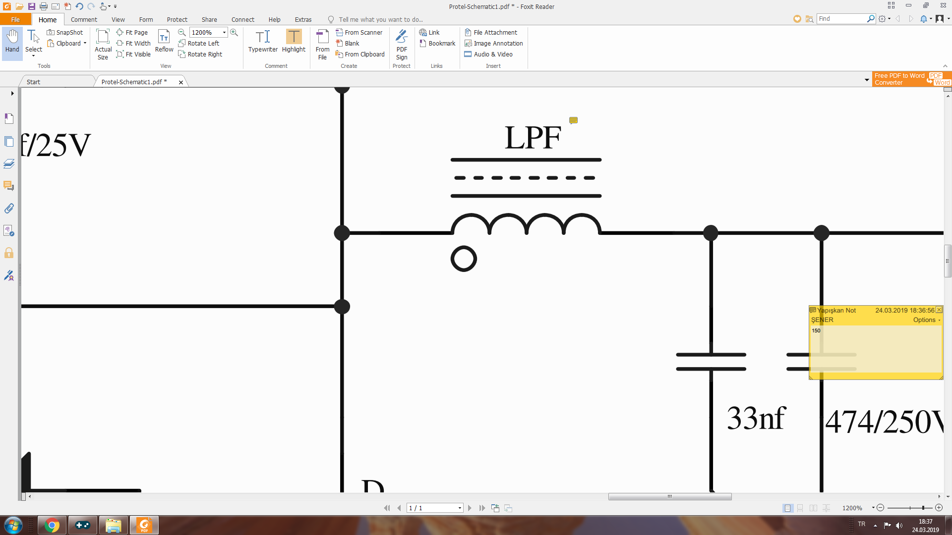

The picture just shows a yellow blob over the component. There is no value. If the filter were to be 40KHz cut off with a 4R load you might expect 16uH with 1uF.
If you just have the circuit diagrams then ???. You suggest you have measured a coil. Was that on a physical example of the amplifier? I assume that is the case because you suggest you have already blown one up... Or is this something you have made yourself based on an incomplete circuit diagram?
The circuit diagram shows a 470nF output filter capacitor which, with a 4R load, would suggest an 80KHz cut off frequency and an 8uH inductor.
However the above applies to fixed frequency operation but it is still the case that 150uH in that position is a huge and likely to be wrong value. Given the circuit is self oscillating 150uH is going to make it go at some silly low frequency in the first place.
I would be inclined to go for a 1uF filter capacitor and a 16uH filter inductor and see if it manages not to die so quickly.

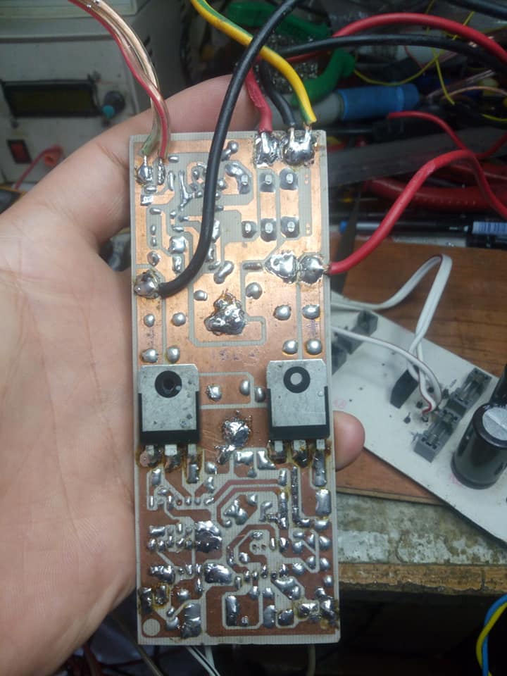

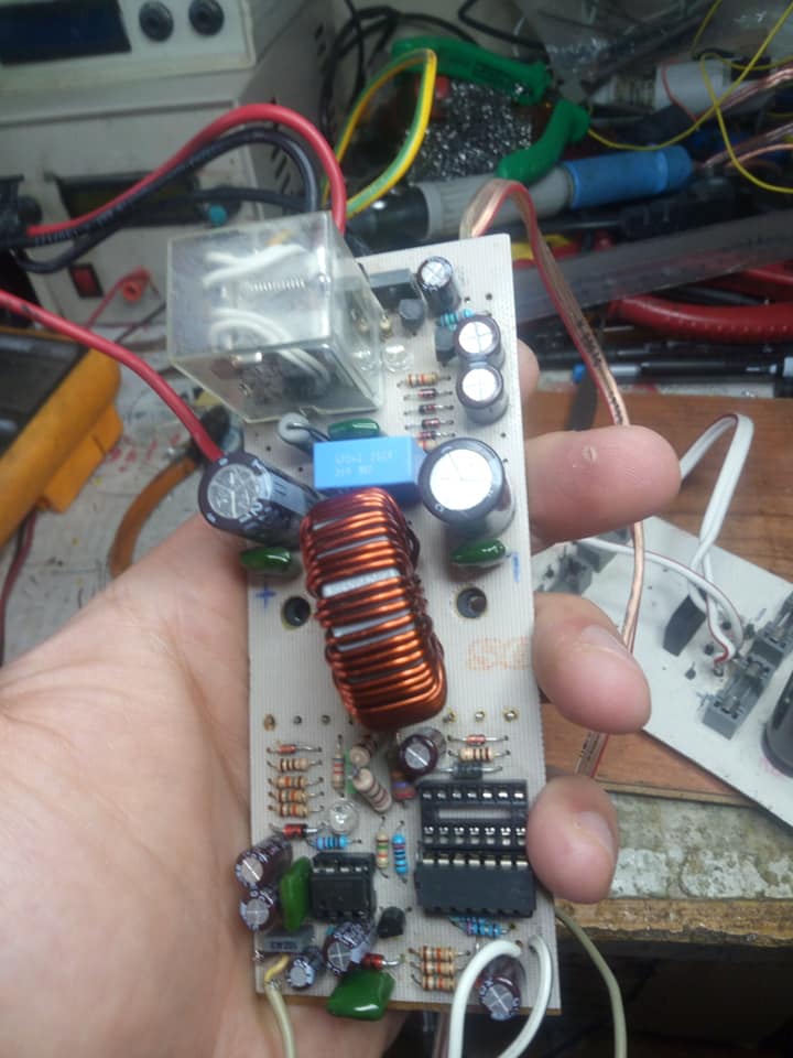

Do you still have the originals and can you provide a picture or at least a more complete description... shape of core, number of turns, thickness of wire. It is possible that they used a soft saturating material.
I assume you are trying to copy the board? If the zero bias value of the inductor is in fact 150uH then as previously suggested it is possible that it is a soft saturating material... a swinging choke. I still doubt that. Have a look at,

Sorry? I don't really mind if you are copying it. I assumed you already had one but perhaps it had blown up. However inductors are, more or less, indestructible. I presented the other circuit as being similar. I'm not suggesting you use it instead. It just demonstrates that a reasonable value for the output inductor in this sort of circuit is 30uH rather than the 150uH that you are suggesting you need.
Red-black Original Behringer D-Series Amplifier Nook Connected 22 UH. She was cremated shortly after she arrived. What would be the reason?
