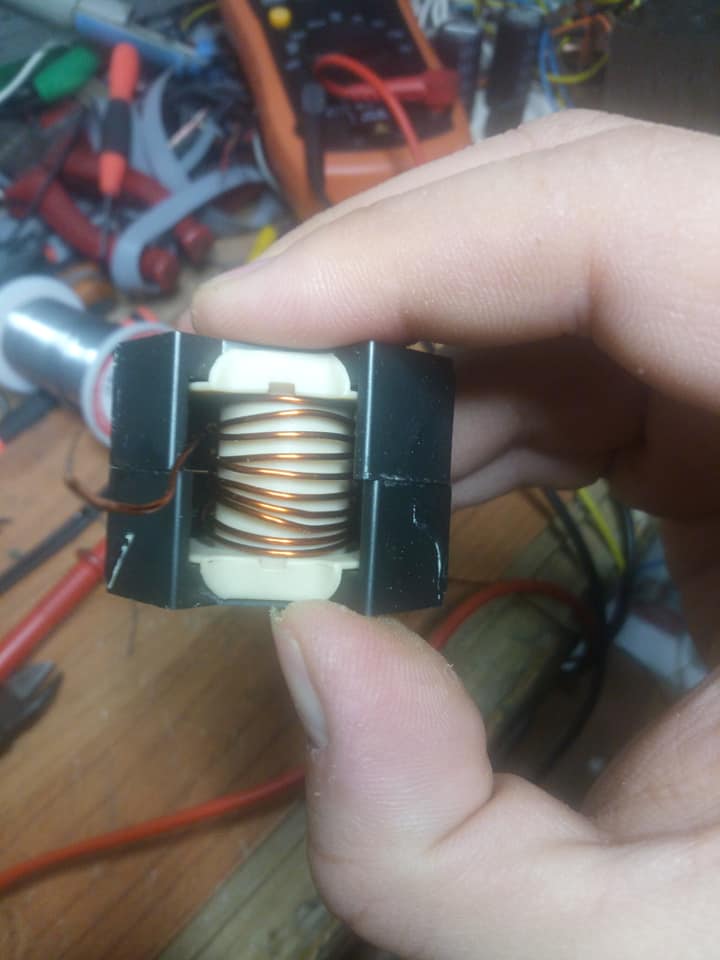

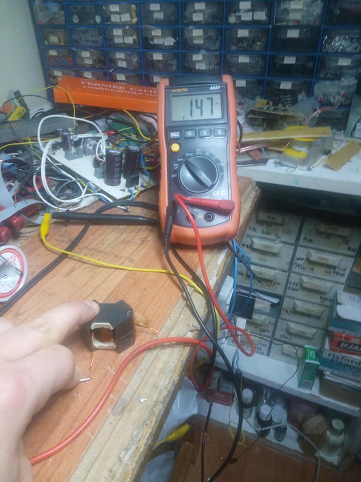

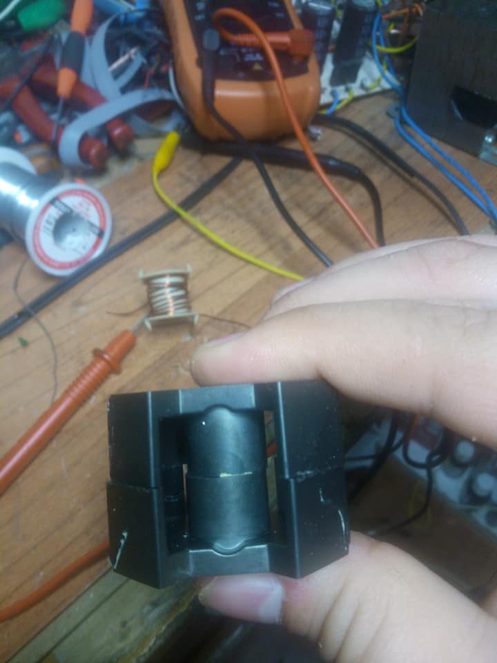

rm14 with 0.80-1mm wire with 10 spiral coil. The value was 150uh. I left the air gap with paper tape for core.
Since the number of spirals is small, will mosfet transistors and ir2110 be damaged? I'm worried?

IIRC
Nmin = LI^2/Bpk.Ae
I^2 = 10 x 300E-3 x 198E-6/150E-6
I^2 = 3.96
It looks like your inductor will saturate at 2 amps.
More sums... might be wrong.
Work out what your peak audio current will be. Root2 * Irms.
Work out what half the ripple current will be. Vs/4FsL
Add them and call it Ipk
100W into 8R
Irms = 3.54A Peak audio current = 5.
Fs = 100KHz L = 150uH Vs=40
Half ripple = 0.67A
Ipk = 5.67A
Nmin = LIpk^2/Bpk.Ae
Nmin = 150E-6 x 5.67^2 / 300mT x 198E-6
Nmin = 81
Al = L/N^2
Al = 23nH/root turn
Unless there is something about your application that is very different from the approximate numbers I have used the core you have is not suitable for the task.

10 spir will also burn in 2 / amps. If I did what I did, I didn't hold 150. What could be the ideal core?
You have to calculate a core area product. Winding Area x Core Area. Aw.Ae

Your core might well be suitable but you need to have a much bigger gap. Try five layers of paper tape.
I tested the Rm14 core with five paper money. I left it after the transistor IR2110 failure. Not working, lit
