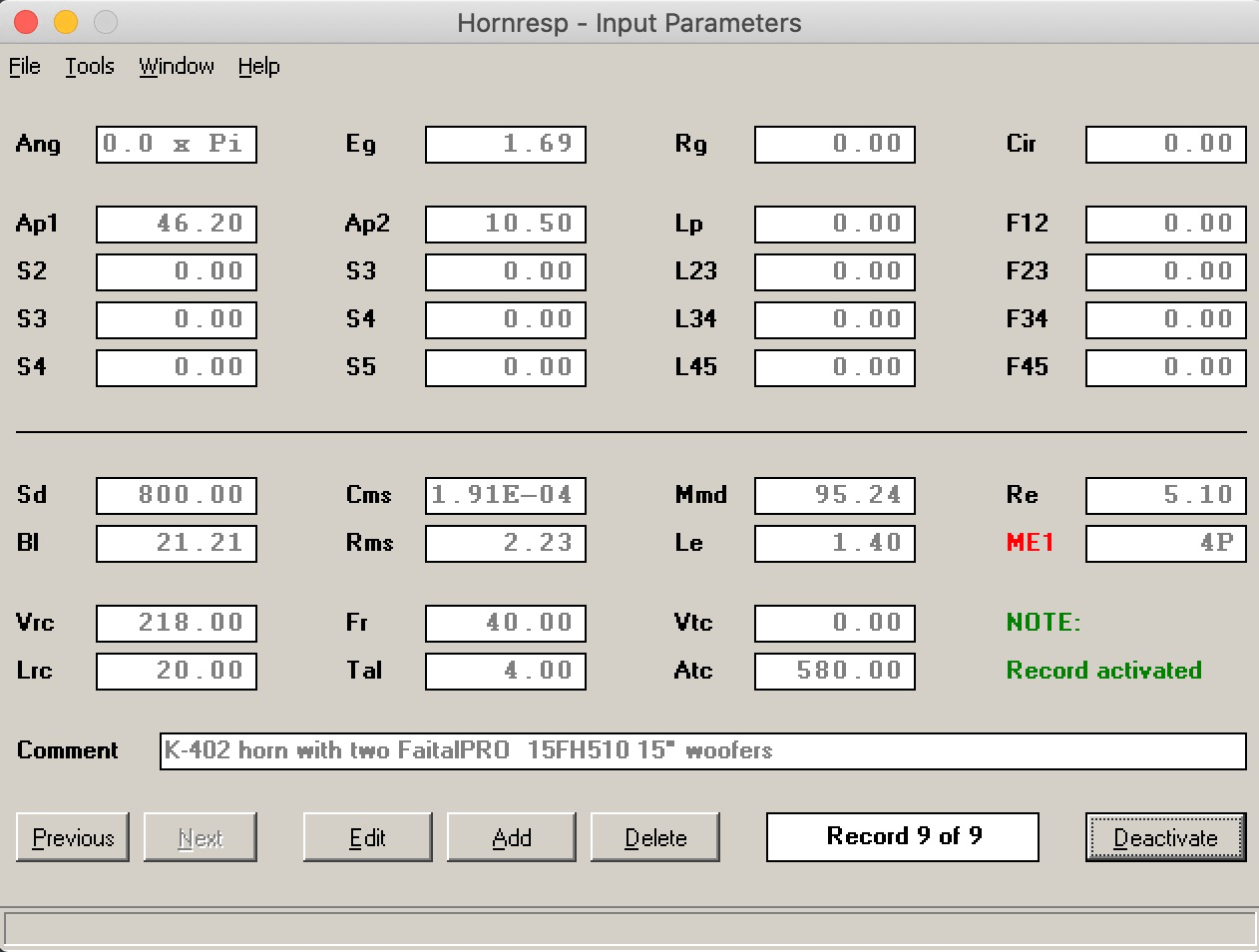

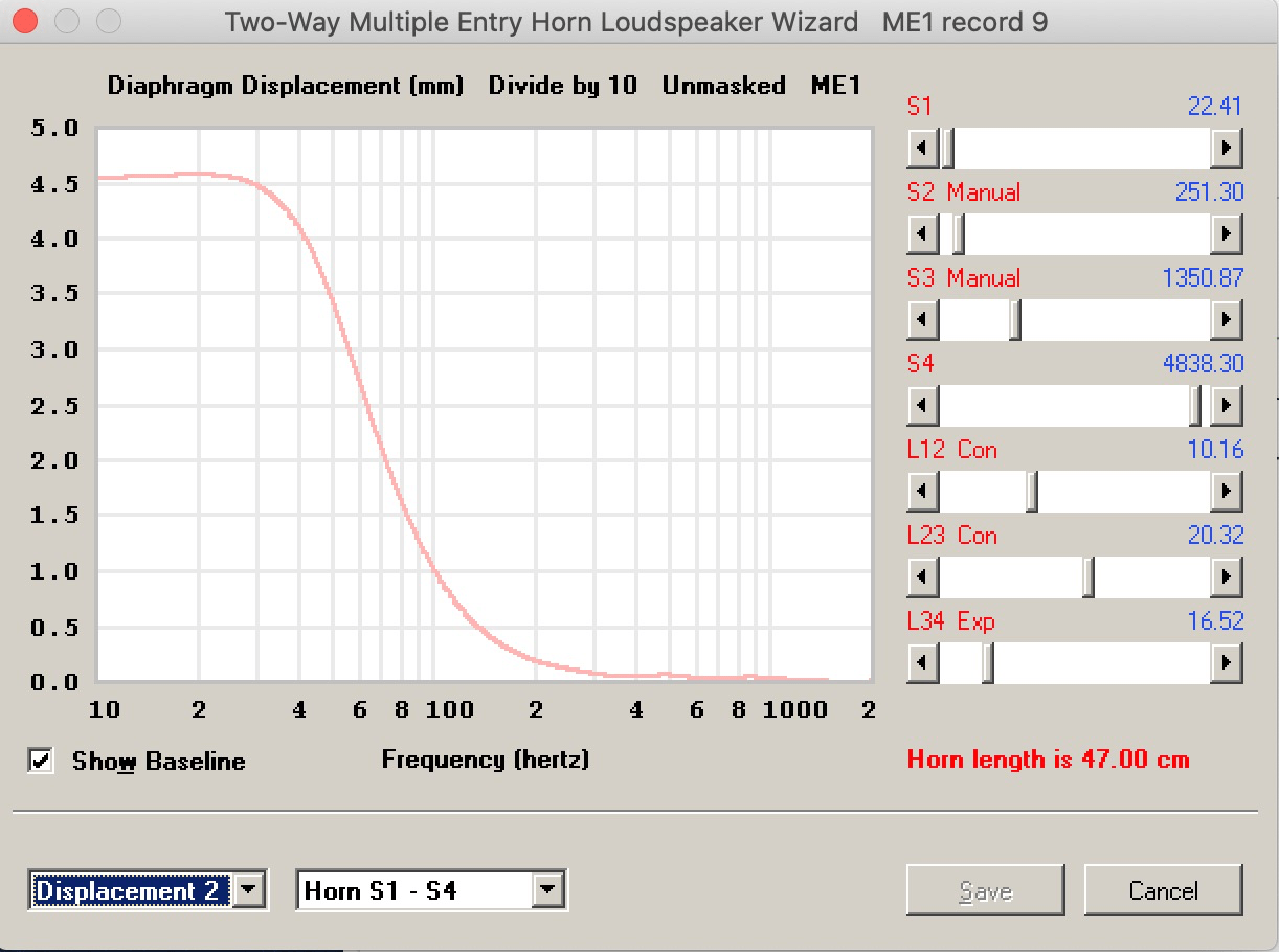

Looking for 2 x15" woofers for a 2-way K-402 based MEH. Would like the following specs:
8 olm with a free air resonance around 25-35 Hz and a Qts of 0.25-0.3
Found 11 here:
http://www.loudspeakerdatabase.com/search/15.0_size_in_15.0/8_z_8/25_fs_35/0.25_qts_0.30
I've modeled a couple in Hornresp (see below) that seem readily available in the US.
My questions are: 1. Can someone double check my input parameters to make sure I'm modeling these correctly for a MEH? ...and 2. If #1 is satisfied, what are you favorites of the ones below and why (I'm trying to learn)? ...and 3. Are there other woofers I should consider not on the list above?
I really hope the Dayton one will work as it's the cheapest option... they all look really similar to me
K-402 Horn w/ TAD 4002
K-402 horn with two Eminence KAPPA PRO-15LF-2 15" woofers-Total Power
K-402 horn with two Eminence KAPPA PRO-15LF-2 15" woofers - Displacement
K-402 horn with two Eminence KAPPA PRO-15LF-2 15" woofers - Input Correct?
K-402 horn with two Dayton Audio PA380-8 15" woofers - Total Power
K-402 horn with two Dayton Audio PA380-8 15" woofers - Displacement
K-402 horn with two Dayton Audio PA380-8 15" woofers - Input correct?

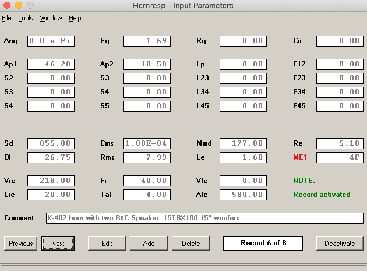

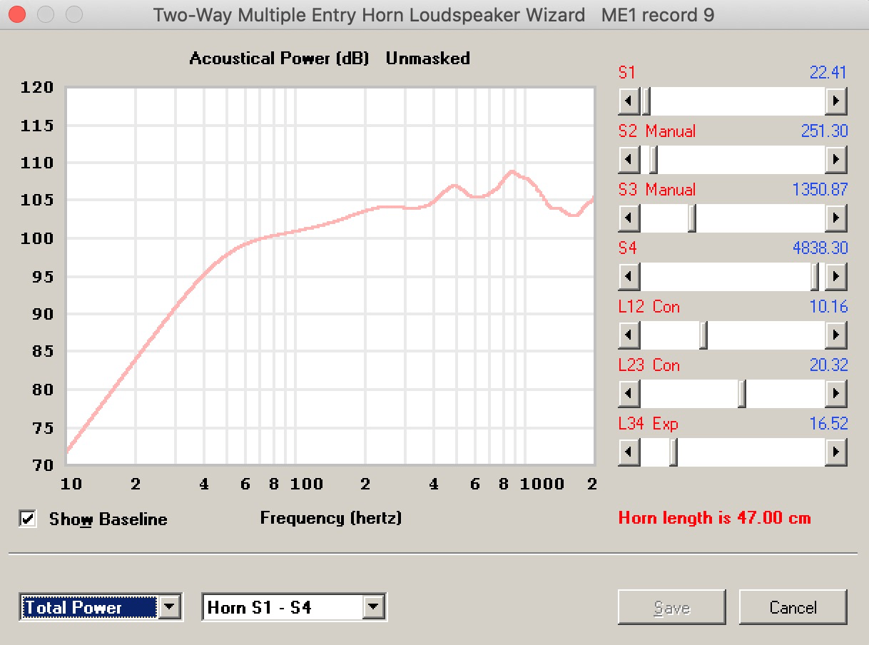

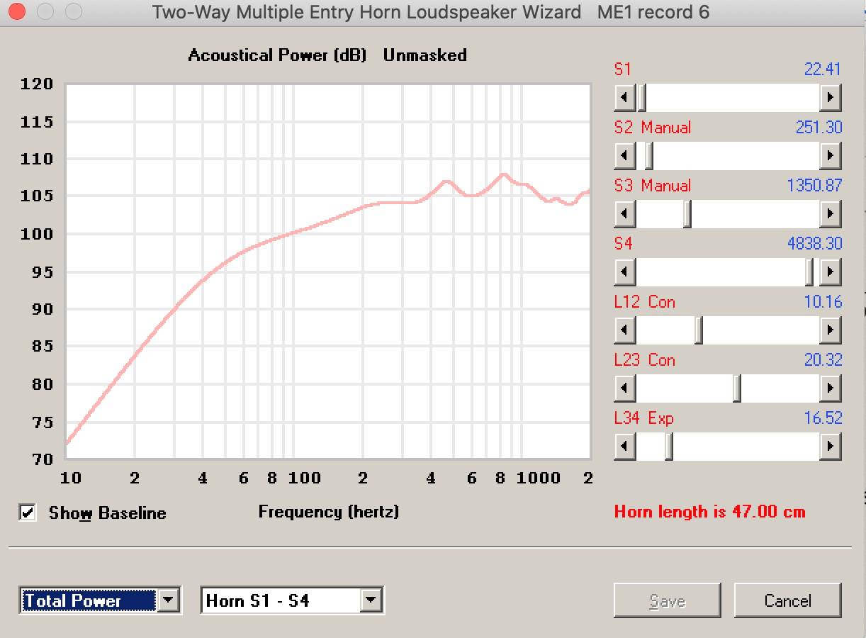

Here is a couple more I modeled:
-402 horn with two B&C Speaker 15TBX100 15" woofers - Power Response
K-402 horn with two B&C Speaker 15TBX100 15" woofers - Displacement
K-402 horn with two B&C Speaker 15TBX100 15" woofers - Input
K-402 horn with two FaitalPRO 15FH510 15" woofers - Power
K-402 horn with two FaitalPRO 15FH510 15" woofers - Displacement
K-402 horn with two FaitalPRO 15FH510 15" woofers - Input

The Faital 15FH510 would be my choice, it has good overall performance for the money and the mounting depth is fairly shallow compared to other drivers. I've used these in a few vented 2 way builds with 2" driver crossed at 900 hz. Fairly efficient too and goes pretty low in a reasonable sized cab.
Right, pretty much any prosound mid bass horn driver will work with the highest Vas, lowest Qt the most efficient, though for HIFI/HT not all that important, so any cheaper than the $320 pr. Crites CW1526?
You are showing 4 drivers connected in parallel (4P) in the ME1 records. Shouldn't it be 2 drivers?402 horn with two B&C Speaker 15TBX100 15" woofers
I was under the impression that if you have two ports per woofer that you have to model it this way? I’m very new to modeling however and won’t pretend I know what I’m doing yet… particularly when you wrote the software! Please let me know the right way of doing it…You are showing 4 drivers connected in parallel (4P) in the ME1 records. Shouldn't it be 2 drivers?
I’m very much leaning towards the Crites… especially since I can actually drive there and pick them upRight, pretty much any prosound mid bass horn driver will work with the highest Vas, lowest Qt the most efficient, though for HIFI/HT not all that important, so any cheaper than the $320 pr. Crites CW1526?
He did... he is also the one that suggested a 8 olm woofer would likely work better hence my due diligence here. The more I look at it however, the more I think the Crites are the best choice in terms of price and the fact that they model really well compared to the other six or so I've looked at. I have a Crown XLS 1502 that I'm thinking of using to drive the woofers so should have enough juice to drive them I think?Didn't ChrisA/Cask05 use the Crites in his K402 MEH?
I don't really think the driver matters all that much in this application unless you need a lot of EQ applied passively to get it flat.
Which did he suggest?he is also the one that suggested a 8 olm woofer would likely work better
He didn't suggest a particular one.. only that an 8 olm with a free air resonance around 25-35 Hz and a Qts of 0.25-0.3 would be on target.Which did he suggest?
For two woofers with two ports per woofer,I was under the impression that if you have two ports per woofer that you have to model it this way?
In the Nd record:
Set Nd = 2P
In the ME1 record:
Specify a throat chamber with Atc = 2 * Sd and set Vtc to an appropriate volume.
Specify a throat port and set the port area equal to the total area of the four ports.

Thanks for the lesson! I'm now going to try and figure out what to use for the throat port and Vtc... I have some more learning to do!For two woofers with two ports per woofer,
In the Nd record:
Set Nd = 2P
In the ME1 record:
In the Nd record:
Set Nd = 2P
In the ME1 record:
ERROR CORRECTION
I don't know what I was thinking when I posted the above .
I should have said set ME1 = 2P in the ME1 record, not set Nd = 2P in the Nd record.
My apologies for any confusion caused.
