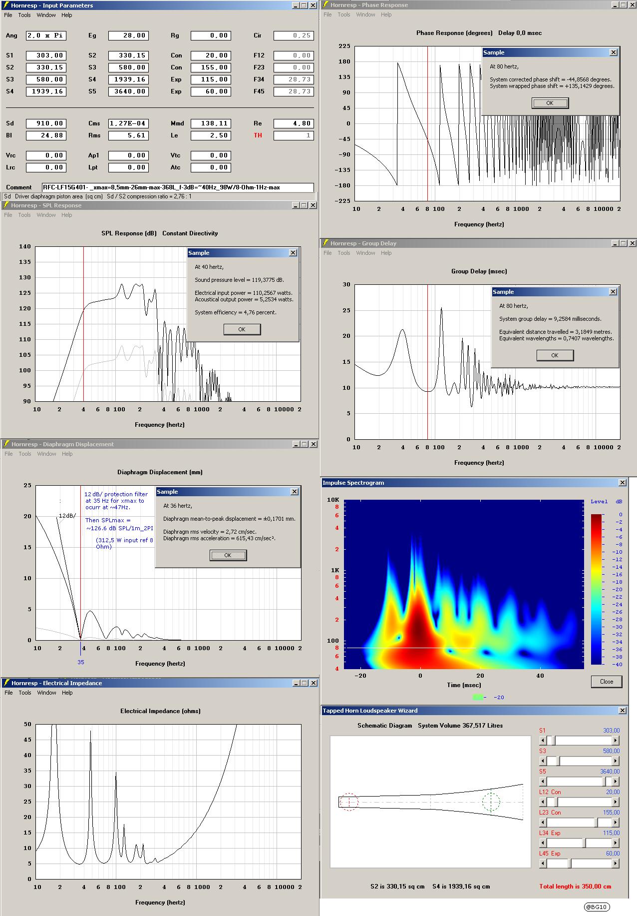

My goal was to build something goes down to 40 hz, and has more than 100 db/w/m sensitivity. I played around with hornresp and decided to use the RCF LF15 G401 in a 40 hz tapped horn.
Excursion powered with 800W

I would very much like to see your input parameters for Hornresp.
Also I an very interested in the parallel horn section that is adjacent to the driver. I like how with that extra folded section you have managed to increase the length of the horn and not waste any internal space.

Going by the Hornresp plot I'd have said the LF15G410 was short of Xmax (8.5mm) for 800W handling -- there are numerous 15" drivers with similar T-S parameters but bigger Xmax (BMS, Ciare, Beyma, Faital Pro...) which would handle considerably more power.
Of course they could also be more expensive, or just not model as well in a tapped horn...

At 400W the RCF driver would be fine.
If you follow the usual recommendation (for PA) of an amp with a power output of double the continuous driver rating (to allow for music crest factors) the BMS15N850 is the only 15" driver I've found that can handle anywhere near this without running out of Xmax (16mm using the usual formula).
Ian
I dont think this RCF reaches the Xmax limit, even if i drive it with 800 W. Note, that u are playing music, not sinewaves what the hornresp predicts.
For example: The hornresp Displacement graph says, that the excursion of the LF15G401 is 13,2 mm if the total 800W RMS(!) is on a 50 Hz sinewave.. Thats never gonna happen.

Indeed he is -- whether this is an issue or not depends very much on the type of music you're playing and how big the amp is, instruments like bass guitar or kick drum probably won't have a problem, synth bass on dubstep (not that I play this but some people do 🙂 probably will.
Since one of the tapped horn advantages is low distortion, it seems a shame to run the risk of adding distortion back again by running out of Xmax -- which is what will happen with the RCF if you do hit it with 800W sinewave at 40Hz, that's why it won't reach 13mm.
Given that they're available, I'd pick a driver with more Xmax -- *if* I was going to drive it heavily -- to make sure this didn't happen. If you're not doing this and don't play music where the bass resembles swept sinewaves then the RCF driver will be fine with 800W, as is the B&C with 1000W (or more on most music).
And as I said, more Xmax usually means more money...
Ian
P.S. The driver in the TH118 has >2x the volume displacement of the 15TBX100 as well as more power handling, so this is less of an issue.
