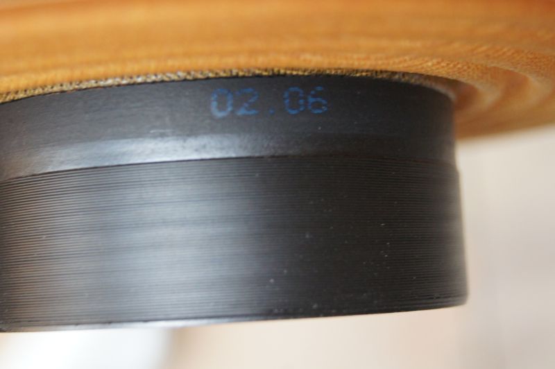

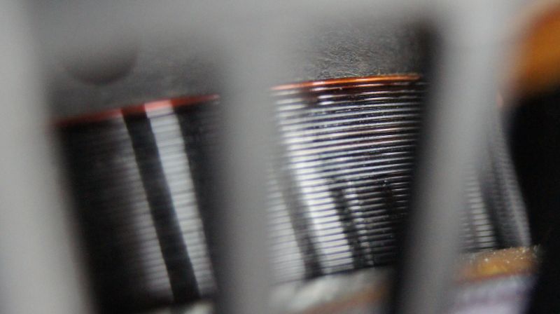

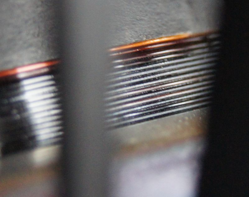

Thanks to the generously vented spider, I had a clear view of the VC. I was even able to pull all windings out of the gap thanks to a large maximum excursion. Their outside showed no signs of burned resin or other deformity. The coil was dull black with the exception of the upper winding (which happened to be on the inner layer), so I assumed it was blackened to improve heat dissipation.

The voice coils are not normally black and I suspect the resin has been burnt and become loose.
Not normally, but they can be. I have a couple of mint P-Audio recone sets (for a pretty humble driver with a steel basket) and they have blackened copper wire.
The VCs in question look very similar, but I will take a second look.

A voice coil *may* be black (although I never saw one) but it will never be black for part of the winding and enamelled copper colour for another section of same winding.
In that case the copper coloured is the good one, and black is toast.
Meaning *the VC* is toast.

You probably have something similar to this:
this one also bottomed so it's slightly crushed:
Compare these:
I have experienced this kind of problem (ferrous particle) before, and I could always feel the VC scraping, and the sound was also quite different. Also, what is the likelyhood of two such drivers feeling and sounding exactly alike?
Thanks, those pictures are helpful. I would say the transition is more aprupt in the case of my VCs, consistent with black paint applied with some sort of roller so it couldn't get to the first turn that happens to sit on the inner layer. As I said, I will look more closely.

I'll take everything back. Looking at the VCs in bright daylight, I have to agree they were toasted even if no single turn is sticking out. I removed one of the dust caps so I can use my fingers to expand the VC former. When I do this close enough to the pole, the chattering stops whereas it doesn't when I do it a few mm above the uppermost turn. So I suppose there are indeed some loose turns.
One of the coils measures at 3.9 Ohms which is almost high for a 4 Ohm driver. The other one measures about .35 Ohms lower so I am not sure if this is regular tolerance or I am facing one or several shorted turns.
