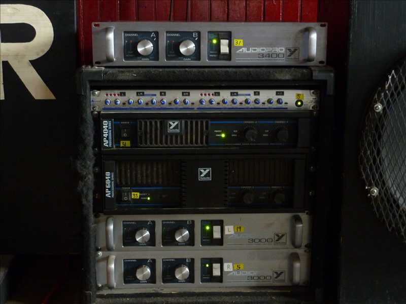

I have disconnected the 18's and ran the 15's down to 30 hz with the same results, even with the speakers outdoors so there are no walls effecting cancellations. I have changed my crossover frequency from 45 to 120 hz with the best results at 60 to 65hz but still not exceptable, have also change the cabinet size and tuning on the 15's fron 40hz to 85hz. the best performance is tuning the 15's to 40 hz and crossing them over at 60 to 65hz.
I substituted the present 15 cabinets with altec cabs with 416-8b drivers and the problem was basically fixed, but the Altecs can only handle low power. This is why I am considering the Faitalpro 15FH520 or the Beyma 15LX60 which both have frequency response curves on Bassbox Pro almost Identical to the Altecs when tuned to 40 hz. I would really like experienced speaker builders to model these and tell me their opinions .

What enclosure volume and what frequency would you tune these to? Please be detailed about the emclosure and port. I used bassbox Pro and tuned them to 40 hz both with a 6.25 cu. ft box The 15G40N Had a 3db rise from 45 to 200 hz and reaches xmax at 400 watts, 122db.
The L15S801 had a 4.5db rise from 42-240hz and reaches xmax at 350 watts, 121db.
I plan to get a Carvin X Drive XD88 someday, but I want to get the system as close to perfect as possible without it first.
I would really appreciate your input on tuning.

My 18's are fine the way they are, they roll out floor shaking bass. The area my system is in is a 29' x 59' foot room with a 10.5' ceiling. When I crank it up everything in the house moves on this floor and the floor above it, even the toilet turns into a porcelain massage unit. You can feel a breeze at over 20' from them at 118db.
The 15's are my only concern in this forum. I think the Beyma and the Faitalpro may cure my problems unless someone can express a reason why they won't.
