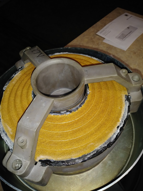

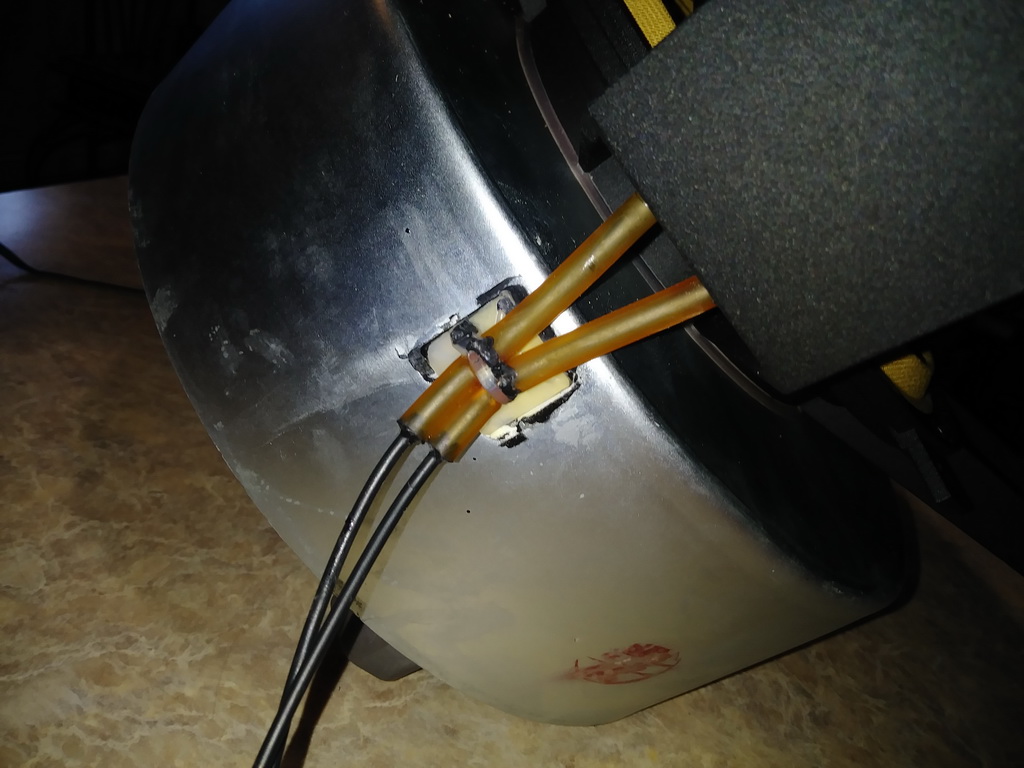

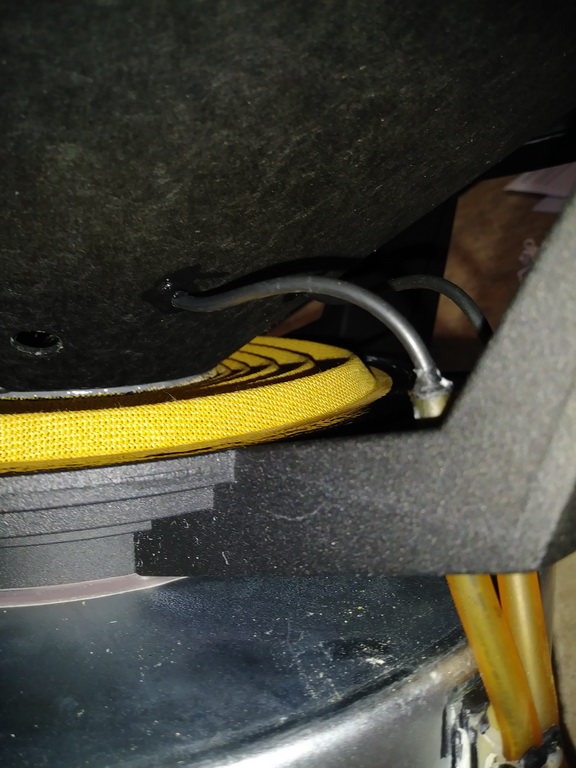

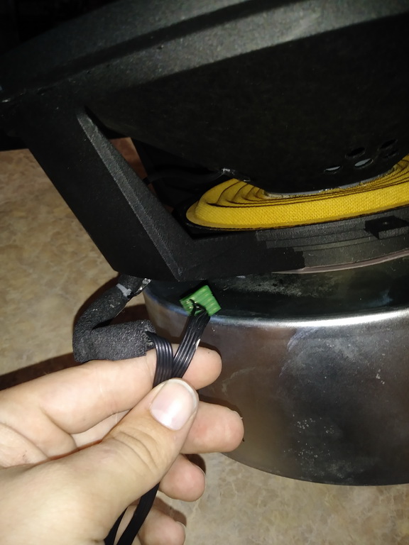

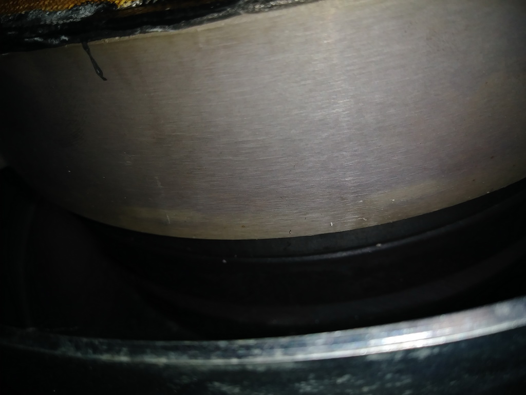

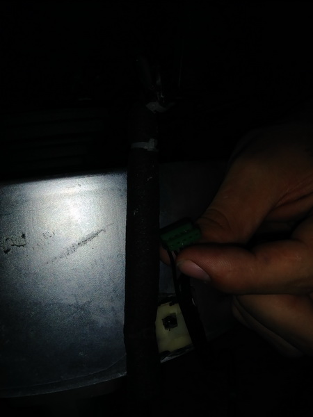

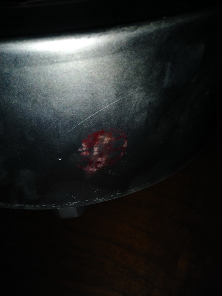

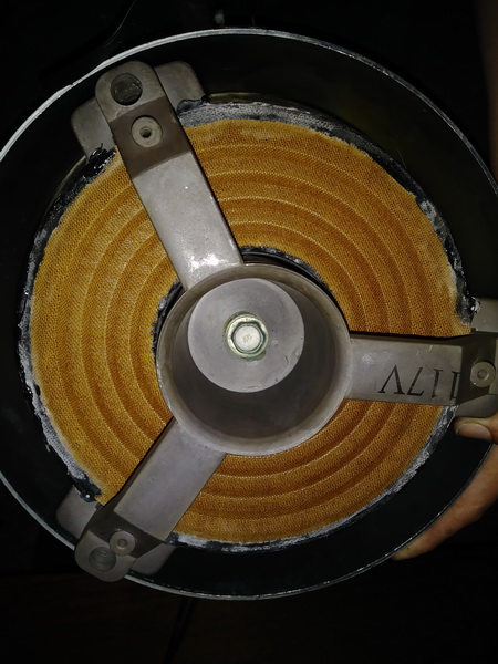

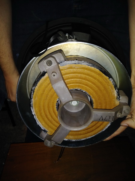

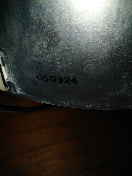

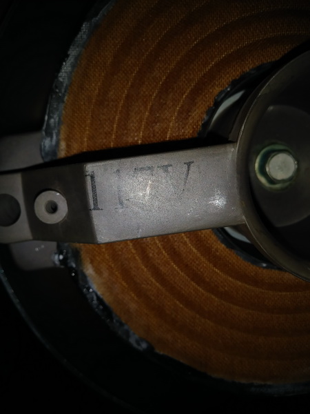

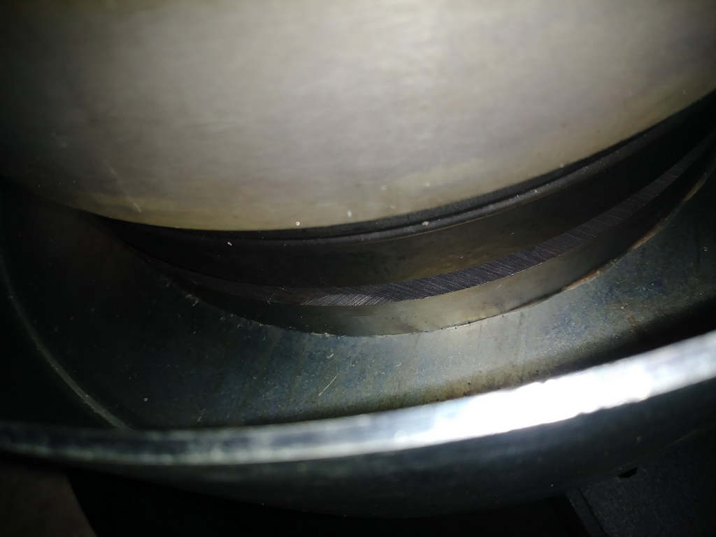

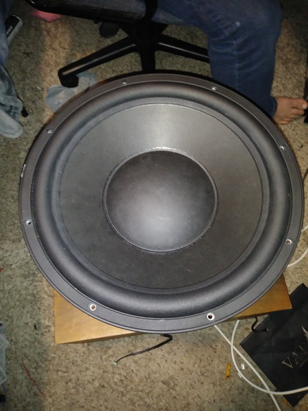

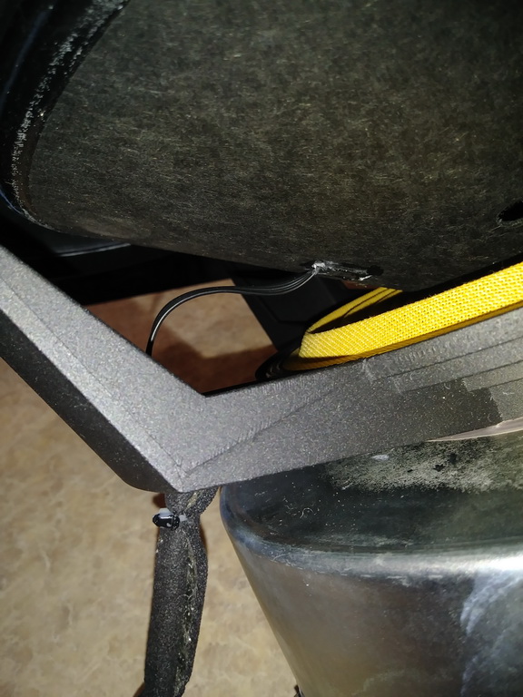

Does anyone know anything about this woofer. It is double spider Numbers on it are 117V and 050324.

Velodyne, maybe? I can't make out some of the basket details in your pictures, but the 3-spoke structure on the back looks right. The ribbon cable makes sense if it's a servo system.

That looks a lot like it.
It has a very low free air resonance and draws gobs of current. Structure is very sturdy. My son has blow up 2 amps testing it. They were small crappy amps but they are cooked.It has triple stacked magnets. a 3" Voice coil. About 2" of excursion. 4 Ohms single coil.

It is the Velodyne DD-15

Thanks for pointing me in the right direction. Now I know what kind of box to build.
