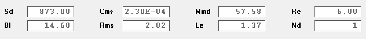

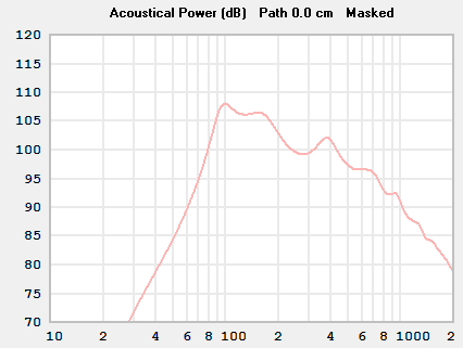

Anyway, moving right along........this kick bin only really loads ~ an octave (~90 - 180 Hz), then shelves down ~6 dB down to ~250 Hz, so for 90 - 250 Hz 'flat' will require EQing, though of course will still have an extra +6 dB dynamic headroom in the bottom octave if needed for some apps, otherwise have ~ 100 dB eff. from ~70 - 700+ Hz vs the driver's ~95 dB mid-band eff.; or EQ the whole BW to 'taste'. 😉

Hey there, just wanted to offer input on the cubo kick bin.
Works as intended, covering the 80-160 region very well (have built two of them for PA apps), the sharp rolloff on the top end helps a lot with harmonic distortion, although I'm not sure for home use that would be a concern. Additionally the ports can be blocked for greater flexibility with the high pass function of the cab, I'm sure you could overload them easily with 1 or two ports open, but again not an issue with home use imo.
Gm has a good approximation of the data with his hornresp Sim, although I will note for the sake of accuracy that it is in fact an offset horn and as such has the corresponding qw notch around 200hz or so - I can't remember exactly where it is, it's been a while since I've looked at the Sims/measurements. Just keep that in mind if you're looking at a high xo point (above the the primary bandwidth of 80-160), as it will introduce phase shift/inversion, which will mess up most xo's.
Thank you...so they should work decently with some eq. I will build one and give it a try.
