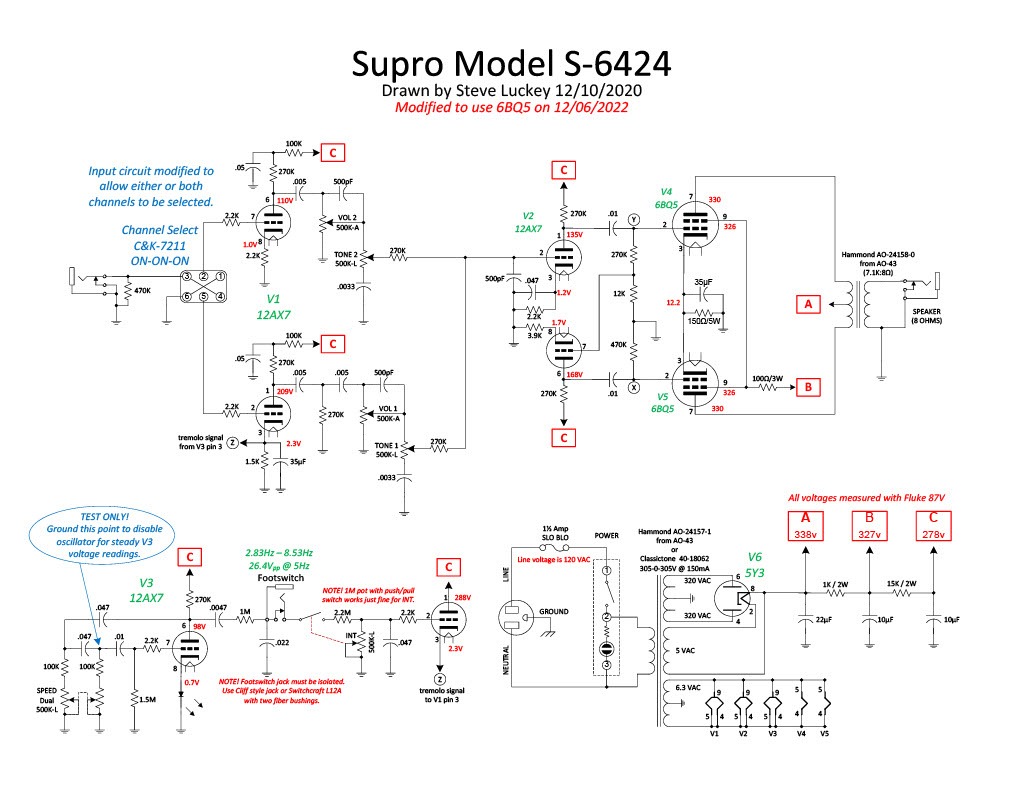

I have collected up most all the parts to build a S-6424 style Supro amp using El84s. 600VCT hammond PT #272FX and a Hammond1760H OT. I had in mind to bias the amp at about 18 watts.
I will only use the amp at home to record with.
I was considering using a 15"speaker.
Can someone comment on this idea and what brand of speaker?
Thanks,
Billy
