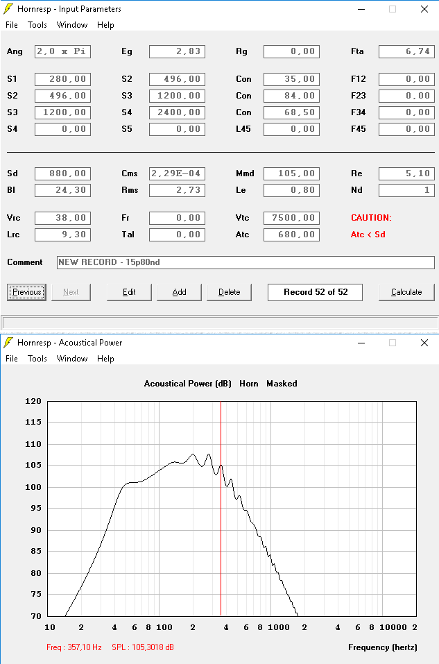

So I ran some hornresp simulations on the cowan design.
It will not be corner loaded so the last section was removed from the simulation.
The driver I would want to use is the Beyma 15P80ND.
QTS is only 0.178 and the EBP is 181.
BL is 24.3 so I think it would be a great horn driver
Xmax is 7.5mm.
Xlim is 26mm.
So My first simulation gave this
I think it's actually quite good. The enclosure is only 60cm x 60cm x 70cm
It does 101db at 50Hz. After that it goes down relatively fast.
The driver is rated for 800w aes and 1600w peak.
So when used for continues operating (800w) i get the next simulation.
So that gives 135db of output. Falling to 130db around 50Hz.
It still does 125db at 40Hz ....so a little bit Eq is possible.
Simulating the 15P80ND in a BR enclosure only gets me to 122db at 40Hz....
Looking at the excursion it goes a little over Xmax around 80Hz but it's only 0.5mm so not a big problem.
Even without a Highpass filter the woofer is well within the Xdamage Limit altough I would not do that.

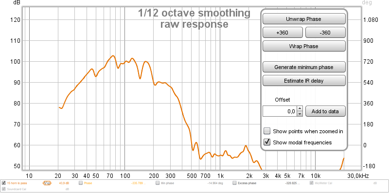

Last weekend I had the chance to make some measurements so here they are,
First the raw response with a lo pass at 200Hz
That doesn't look to bad actually. Need to investigate why the dips are there but I think it's because it needs bracing.
Mind you this was measured standing on the grass not against a wall. There was a wall at one side at a few meters.
So 40Hz is really no problem at all 😱
I was hoping to reach 50Hz but seems like it goes a little bit lower. I really didn't expect this from 1 Cab standing on the grass.
Speaker used was the Beyma 15p80
Microphone was calibrated and to get to that level the amp didn't even blink a signal lamp so it was at very low power

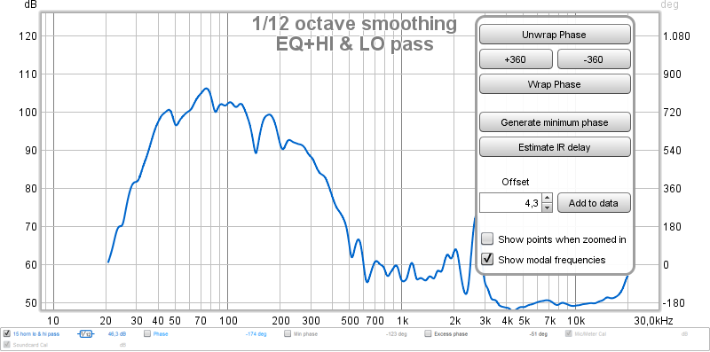

So next up I added a High pass at 40Hz and a little bit of eq.
Only that nasty dip.... for the rest it looks great.
Next up is to add bracing and wait untill the neighbours are gone to put some more power on it.
