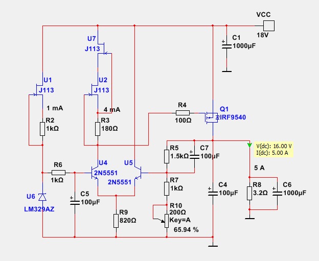

2V dropout for e.g 3A = 6W of thermal disipation! I would look for some buck predregulators and some low dropout linear post regulators instead : )
i have been reading more these couple of last days here and there - the thing is i could probably get away with LT1084 only (properly implemented)- one example is Fidelizer Nikola 2 - that is a preety simple power supply (sometimes there is no need to be to complicated) and according to some listening tests, sounds nice....
Have to think - maybe in reality i really don't need any superreg or complicated mish-mash - maybe it will be enough to just use a regular LT1084 and finish the story
LT1084 dropout voltage = 1.5V, you said you need 3A, so 1.5x3 = 4.5Wats of thermal disipation. Your audio thing consume 13.5Wats at pik at 12V so your power supply reguirement let say 1.1A. add some small amount of reserve let say 1.5A. 1.5x1.5 = 2.5Wats of thermal disipaition, so its ok but still need some heatsink e.g. you can use case for thermal disipation. Other than LT1084 you will need transformer, diode bridge, biler capacitors, filters and things = cca 50eur minimum. Retail price for Nikola 2 is USD $849 for an you say simple psu. You can buy 16 items those one I linked you on ebay, think about it. I'm unsubscribed, those silver-gold-criosilver-snakeoil and things and in addition it also "sound", sorry I can't stand it, too much for me.

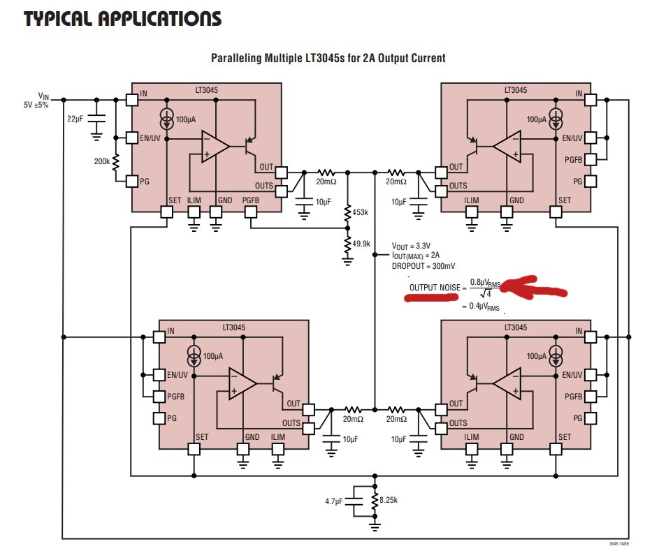

I would go this way, ideal diode controler, buck predregulator and paraleled LT3045 for e.g. 5A power supply, and will cost me cca < 200eur and thermal disipation small and small alu enclosure which will be almost cold, misery noise... in case I need some snake oil power supply.

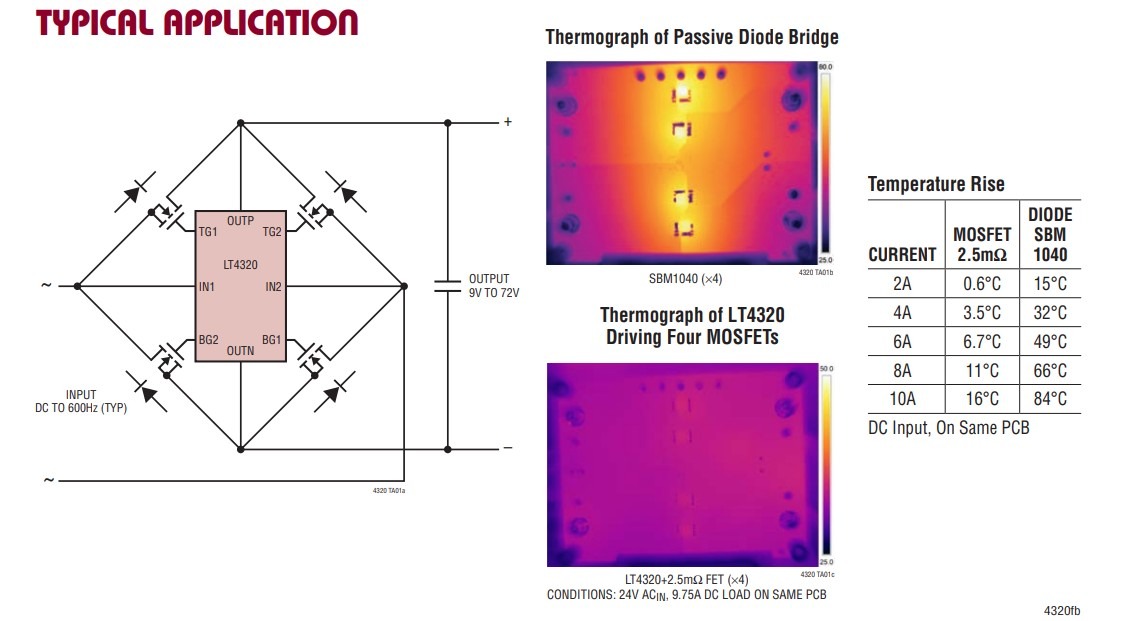

Savan - that LT4320 - anyone tried it - how it works - "sound" of it?LT1084 dropout voltage = 1.5V, you said you need 3A, so 1.5x3 = 4.5Wats of thermal disipation. Your audio thing consume 13.5Wats at pik at 12V so your power supply reguirement let say 1.1A. add some small amount of reserve let say 1.5A. 1.5x1.5 = 2.5Wats of thermal disipaition, so its ok but still need some heatsink e.g. you can use case for thermal disipation. Other than LT1084 you will need transformer, diode bridge, biler capacitors, filters and things = cca 50eur minimum. Retail price for Nikola 2 is USD $849 for an you say simple psu. You can buy 16 items those one I linked you on ebay, think about it. I'm unsubscribed, those silver-gold-criosilver-snakeoil and things and in addition it also "sound", sorry I can't stand it, too much for me.
I don't know, me too not tried and to be honest my interest for clasic power supply not interest me, found those ic 7 days ago and to be honest I wont to build one ideal diode and try. : ) Opamps and things not interest me anymore, I am working on something diferent, plan for a longer period after I finish some unfinished analogye things, search for DDPD on this forum! About LT3042 (LT3045 I mentioned), and their output capacitor, see this post https://www.diyaudio.com/community/...ow-noise-vref-the-gled431.285346/post-4589769
I've experimented with it and currently incorporate it into my dual channel hybrid.
6xLT3045 per channel

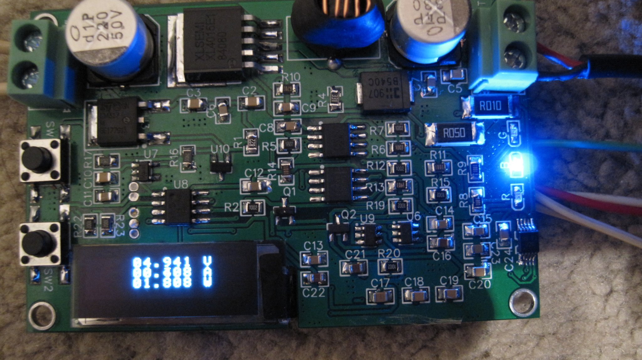

LT1084 might be used but do in mind it have not that low dropout voltage, prety high power disipation while 3A, ideal diode have no sense that way. Search for an example of buck type. I found XL4015 nice buck regulator for use as predregulator, even XL4015 have allready nice regulation and it can incorporate booth CC and CV control, see some articles about them https://circuitdigest.com/electronic-circuits/diy-xl4015-dc-dc-buck-converter-module , yes there is similar regulators even beter for example ones which work on 1Mhz switching frequency even smaller and more efecient, higer input voltage...etc, in my opinion XL4015 is nice one : ) Even I have made digital one using xl4015, using them for many things, charging, charging car battery...etc, very durable, nice protections, an multi-purpose buck regulator, even I have added ina226 ic for measuring voltage and current, oled display... etc, and it do not have heatsink : ) Somebody will think its bad because cheap, wrong. Add him an nice filtering and an nice post regulator and you are done. There is even xl4016 of 8A and VinMax=40V capability and 96% eficiency. There are literally hundreds of them, you can even buy them at some kiosks : ) You can design your own nice clean power supply prety cheap including enclosure for around $100, for example one from ebay, their enclosure+torus tranfformer, capacitors, filters, alu enclosure, allready finished, so if you not like pcb put your own pcb inside and use 70% of their parts, its cheaper than making your own enclsure, torus transformer... etc. Some thinking of mine. : )
