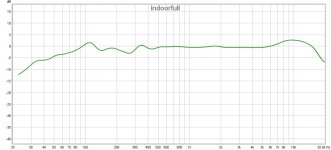

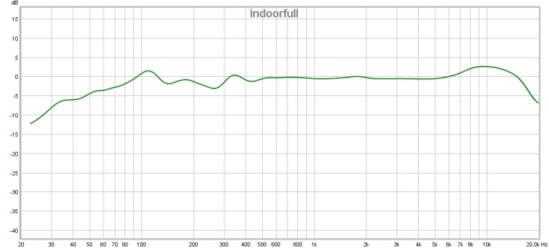

Also, even a 3/4" tweeter is going to start beaming around 6Khz, so that little tilt up will help compensate for the off axis losses a bit. I don't add them, but if there is one up there I usually do not fix it.
SB Acoustics SB19ST-C000-4 3/4" dome tweeter, 4 ohm...just happened to be the first one I found.
Makes sense to me.

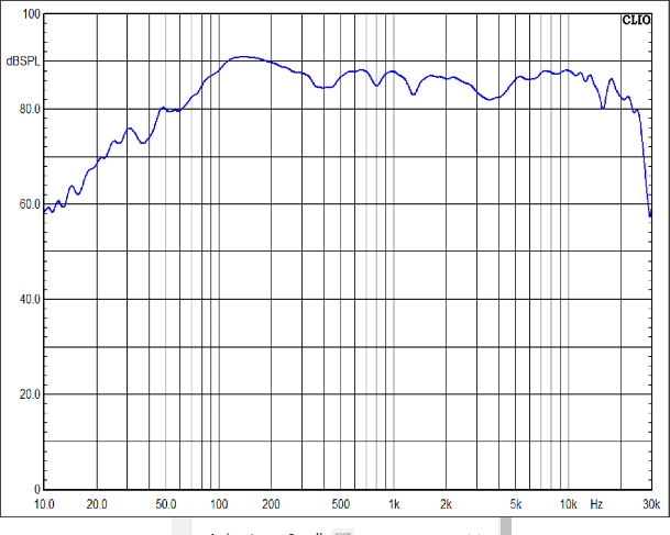

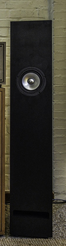

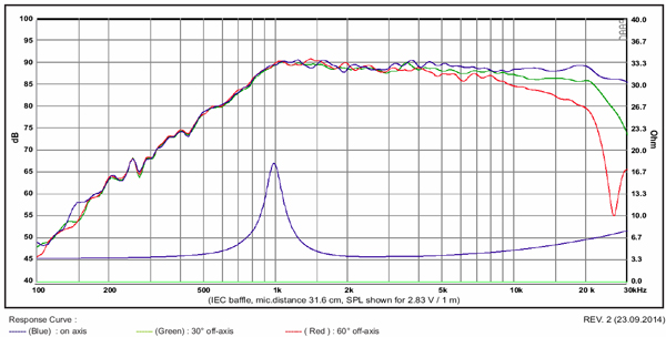

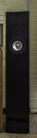

Just referring to myself, not speakers I build and sell. Although no one has ever complained about a scan 10f without a tweeter.
I also tend to roll of the highs a bit, but not that they are not there, just a few dB's less than the rest of the sound. And many seems to like it, not all.
And the set i'm listening now most to and enjoy the most is a test MLTL i build with the new CHN110 fullrange driver, that is also not flat on top, but the treble is there. The response is the published (i still need to measure the MLTL) but it gives an id.
