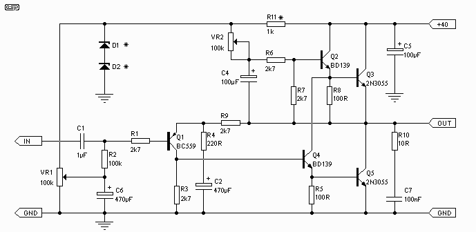

Hey guys i found out the circuit i wanted to do. It meets all my requirements but i just need some clarification from u all. The preamp and power amp is as figured below.
1) how do i noe whether this thing is stereo or not.. is this amplifier stereo!!
I still couldn't figure out which equlizer to use cos there are so many out there. Let's say i were to get an equlizer circuit.. the equlizer circuit has two output channel(stereo).
2) My question is where do i put my equalizer.. in between the preamp and power amp?
3) If dat's the case, both the channel output will be connected to the input of the power amp.. Is dat correct?
4) Lastly, the figure says resistor value says 200R in the figure. Huh.. is it 200 kohm or 200 ohm?
Sorry for askin such stupid questions. As u see, i'm really at the basic of learning this. And btw, thanx for answering my queries. Its been a massive help for me! 🙂

wreck_gag said:
How do i chg to a stereo?
Make two of everything. If you buy ESP circuit boards, the preamp board already comes as a stereo unit, you just need twice as many parts.
A warning about this power amp: it makes a lot of heat! I have built up one channel and ended up doubling the output transistors (now 4 per channel) and moving to a larger heatsink just to keep it at a reasonable temperature. Pay close attention to Rod's article.
wreck_gag said:
(1)Meaning have to do two preamp,two power amp and two equalizer.. is dat it?
(2)U ended up with 4 per channel.. what does it mean?
(3)What i need is an amplifier less than 1.8 kg. With a gd heatsink, do u think it's possible?
(1) Yes.
(2) I mean 4 power transistors per channel.
(3) Not this one. The heatsink for one channel alone would probably weigh that much. And then you need a power supply. I think it might be a little ambitious for your experience level.

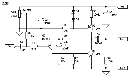

Please look at Project 72 from the same site you got this schematic, and consider buying circuit boards for it. You can feed it directly from a CD player (with a volume control) and add an equalizer later.
I decided to do project 72 like wat paulb recommended with the Doz preamp. But then i will have two input channel of the amplifier. My preamp output only have one output.
1)Where do d other input of the amplifier go?
2)What about the volume control..is it the cd player volume control or is it integrated with the amp or preamp?
Thanx Lisandro and paulb!!
