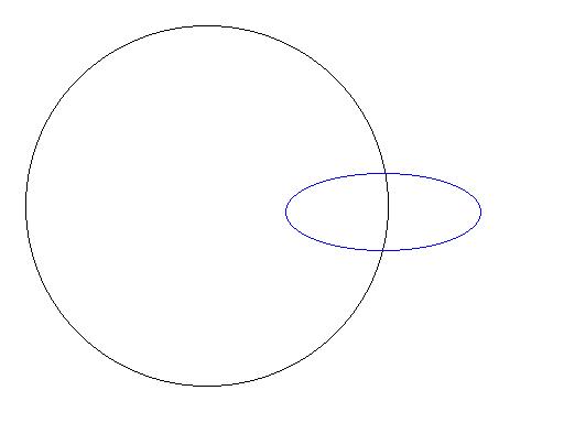

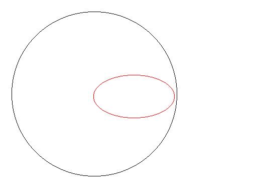

Here is what happens if the fresnels are not working right. The blue oval is all of the light going through a corner pixel. Half of it is falling outside the triplet, so it will not get to the screen.
There are other factors that all contribute to making the corners dim:
1) The condensor fresnel geometry: A 220 mm fl fresnel for a 15" LCD makes the corners 1.8 times dimmer than the center, just by the inverse square law of light intensity.
2) In a non-split design, the LCD may not pass as much light at the corners because the viewing angle is higher.
Many people have built great projectors using the 450 mm triplet and 15" LCDs, so I think your 24 degree FOV figure is too low.
