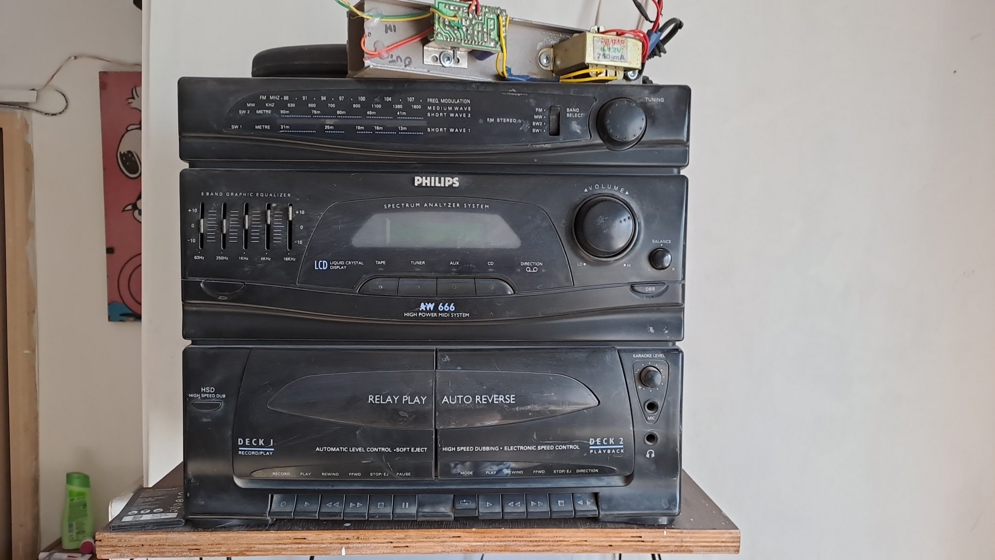

Buy an old amp...I paid about $2 each for these, I have several,

You can have a LOT of fun with the 12V car-sound chips. They work even better in the home because they don't have to compete with the potholes, ratty muffler, and truck/bus blatt. I have actually nailed (strapped) a car booster-amp to the top of a 12V 6A "for CB" power supply and the guy was the envy of the whole office.
Get an old car amp / radio / whatever, and connect it to a 12V / 10A transformer / rectifier, and be done with it.
Very common solution here for people wanting to use car units at home, some people even made boom boxes, speakers on either side of the unit, plywood enclosure.
The thing on the rectangular aluminum section in my picture, above the amp, is another amp...the section is the heat sink.
0-12V / 750 mA transformer, feeding a 6283 amp board (it has rectifier and smoothing cap on it), cost me all of 1.5 US Dollars, the section was free from scrap, wire and labor were mine.

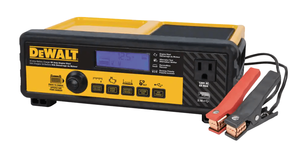

Astron linear supplies were/are commonly used for 2-way radios by hams, CB, marine, and commercial users. They're dead simple, built with 1970s electronics, so a broken one should be easy to fix. Maybe less common in Europe, but there's likely to be some equivalent. Take a look at amateur radio buy and sell forums or classifieds, or visit a ham festival that has a swap meet.
Or you might get away with a Wii power brick; I run my T-amp off one (paid a buck for it at a thrift store).

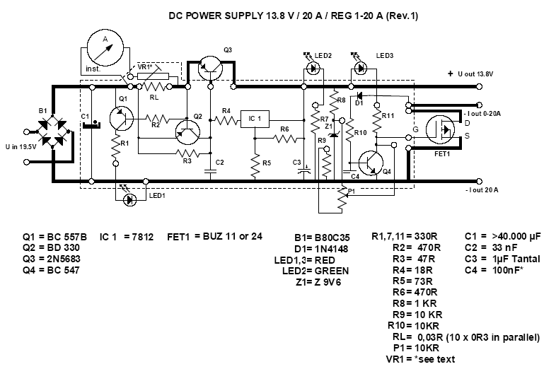

Normal charge is 2.2 V/ cell, so 13.2V.
13.8 is the minimum (2.3V per cell) needed to charge, 2.4 is better (max. really) for cyclic charge. 2.3V per cell is for trickle (float) charge. So 13.8 is correct for a nominal 12V battery .
I built a circuit based on 339, controlling a relay, that switches the charger on and off, and is not depending on battery rating.
It was for emergency LED lights...I think I can make one for 3.7.
The circuit above looks fairly heavy duty, for auto or fork lift batteries.
