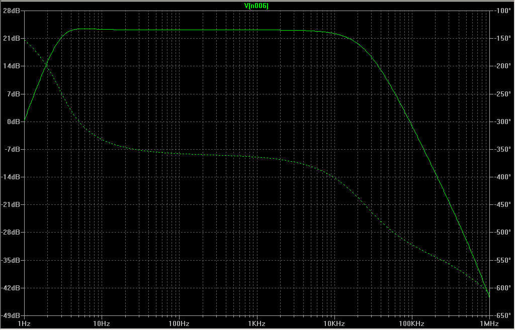

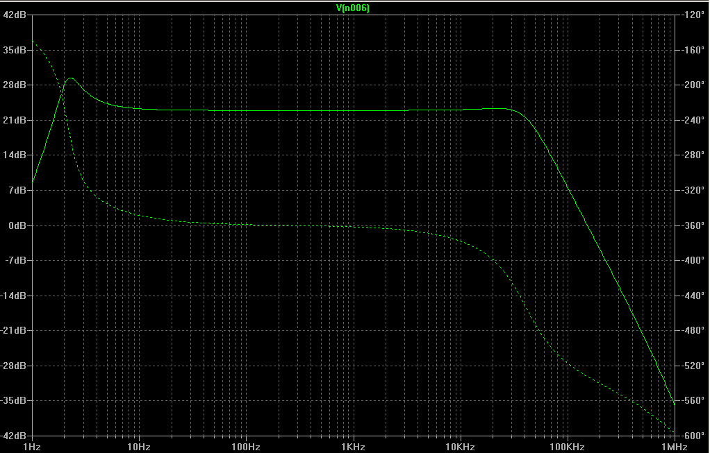

ECC81 vs. 6SN7 or 6H8C
As I have Philips Miniwatt ECC81 I also simulated the circuit response with that tube as first stage.
Right one is ECC81, left one is 6H8C.

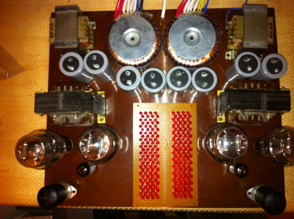

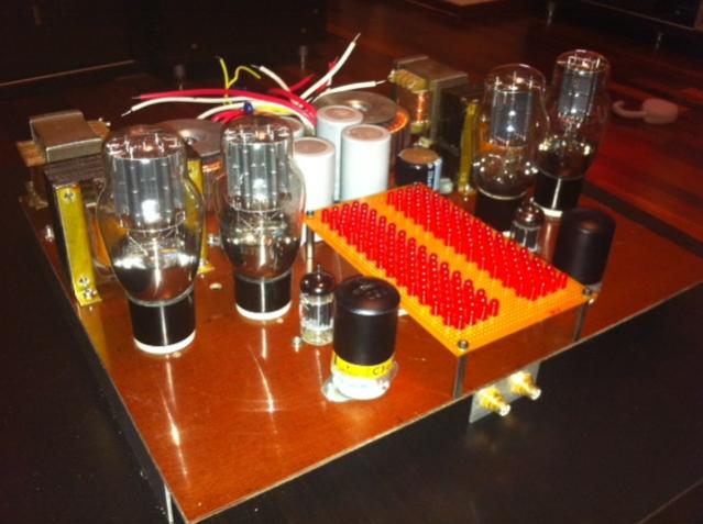

First approach to a component layout
Major components placed on the board 380mm x 320 mm.

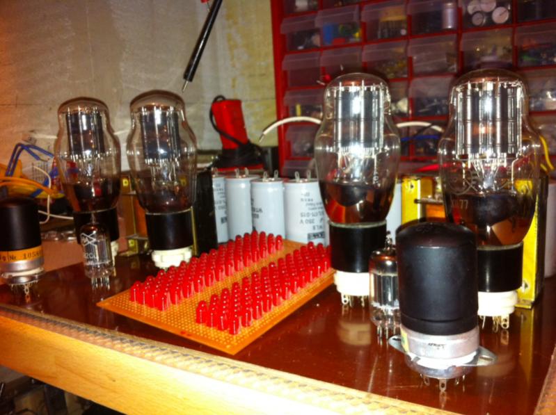

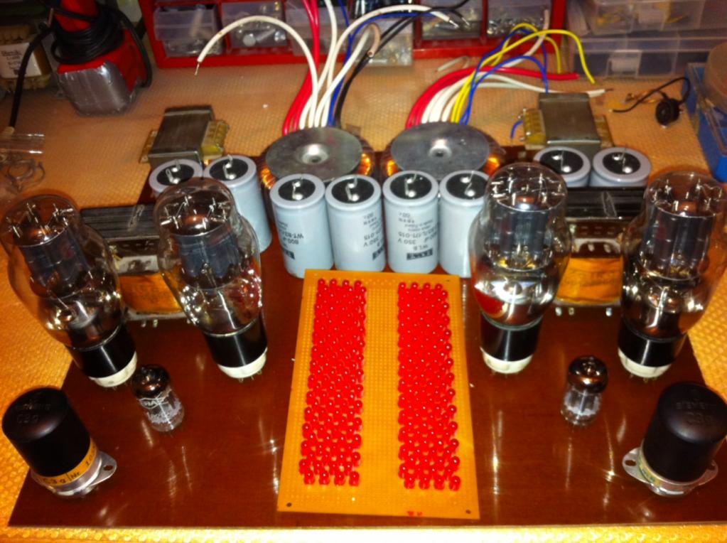

Led Zepp
Tube sockets, transformers, inductors and el. caps assembled.
Found 8 KS 20nF/630V caps which I will use as coupling caps. Two in parallel x 4. Next step - PSU, filament wires, GND bus.
Hi yagoolar,
what's the purpose of using these LEDs in the cathode circuitry of your finals? In my humble opinion you pair the main disadvantages of fixed biasing (i.e. inherent possibillity of runaway due to floating mains voltage, tube deterioration etc.) with those of cathode biasing (voltage and thus power loss).
Best regards!
Thanks for the question. There is no straight answer to it, so a couple ones below:
1. I have 2 PSU trafos with 2x 320V winding at hand ( actually they are 230/220 x 320V, as mains voltage was raised in Poland after I had bought them. And no turning back 🙂 ) - so the rectified and filtered voltage is to be around 400V DC. If I wanted to go fixed bias I should drop 50V.
2. LED array compared to RC in the cathode has lower dynamic impedance - results in better LF response. And I have already had this array and tested it in RDL and 6C4C SE parafeed. And it suits me fine.
3. If I went into fixed bias I would need another source of voltage, i.e. another transformer or voltage multiplier plus good filtering. I wanted it simple and to finish by Christmas, yet I won't ...
4. LEDs also indicate clipping.
That is a proof of concept (PoC) and it may end up in fixed bias the other day.
