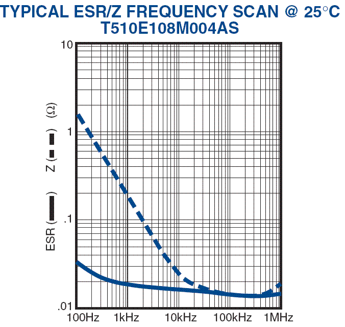

One question: what type of output caps are you attempting to use?
500 Khz is way too high a frequency for electrolytics, even lo-Z ones. It may be even borderline for low-Z chip tantalums. see attached image from Kemet's catalog.
The problem is aggravated with the boost topology, since it delivers pulsating currents to the output.
Your best bet is to bypass them with MLCC caps.
10 uF, 25 volt X7R devices will do a wonderful job.
Otherwise, you'll have to decrease your frequency substantially.
Sorry, here is the image.
500Khz would be fine using a combination of electrolytics and ceramic in parallel. I have made many boost supplies using electrolytic and ceramic combos at this frequency and higher, with decent output ripple (<150 mV). Just be sure to "double stack" (place two ceramic caps in series with the output and ground). Ceramics have been know to fracture and cause shorts. This case is extreamly bad in a boost topology since they are connected to Vbat through the inductor and diode.
