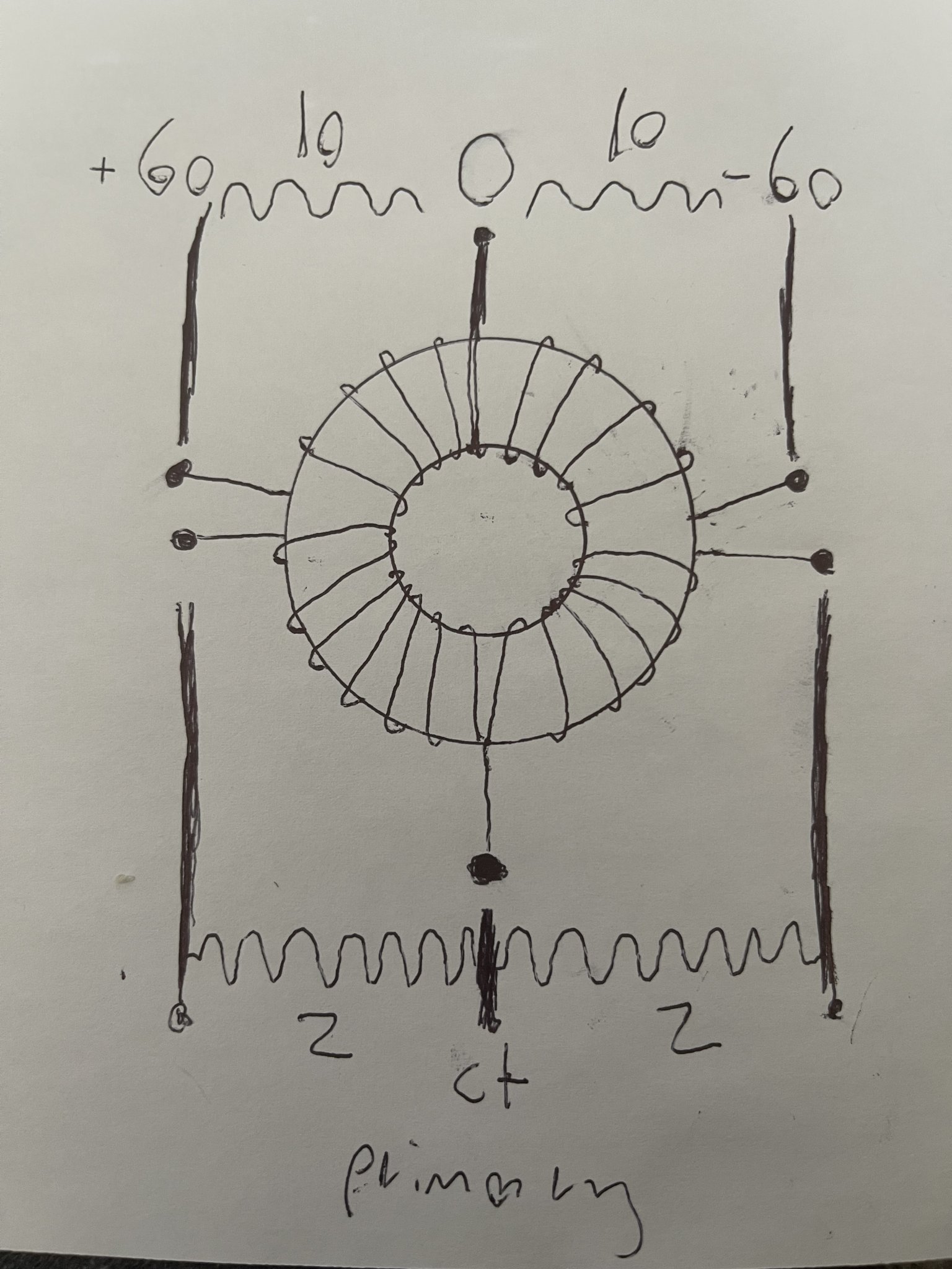

Roughly speaking, i was going to wind my transformer like this (ignore the number of turns drawn onto the core) with the primary side taking up half the core, and the secondary taking up the other half. I have also seen some designs where the primary and secondary run alongside each over, covering the whole core.
If i should wind it like this, i assume that i would have to use multiple strands of wire with their ends soldered together, to make 4 turns take up half the core.

The winding on both the primary and secondary are wrong assuming the winding is as drawn. As drawn, the winding direction reverses as it traverses across the center tap. The windings for both the primary and secondary should start and finish without a reversal as it crosses the center tap.
Think of it as one continuous winding with a loose loop where the center tap occurs.
With that change the transformer should be functional. Get to that point first.
There are several winding techniques that can improve the efficiency of the transformer if you are not satisfied with performance. Get it to work first, and we can explore those techniques when needed.

You can use multiple strands of smaller gauge wire and connect them in parallel. Litz wire is made up of many strands woven and insulated from each other. Litz is ideal for high frequency transformers like this. It is preferred because a single fat wire suffers from skin effect. At higher frequencies, current only flows on the surface of conductors due to skin effect. Skin thickness is a function of frequency. Any configuration of multiple strands in parallel needs to have the strands insulated from one another ( until the terminations ) to reduce skin effect. The strands should be no thicker than twice the calculated skin thickness.
