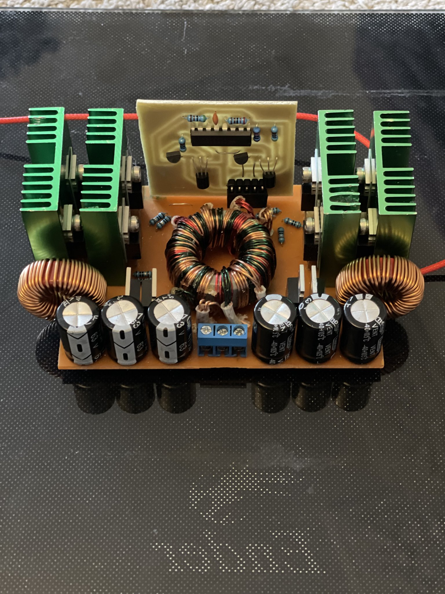

Added in what inductors i could find, im not lucky enough to have any spare atx power supplies however i did find these two filter inductor toroids from an amplifer board - you can see them hanging off the sides of the board.
Added in further irfz44n mosfets, now with 4 mosfets for each side of transformer.
Ambient current draw is slightly higher with the extra mosfets. The upgrades with the added mosfets and inductors has definately improved the maximum output volume off the amp, before i have the issue where a single mosfet blows. Considering that only one mosfet goes when too much current is drawn makes me think that their might be a shoot-through issue? perhaps increasing dead time might help? open to ideas.
The board has optionable feedback, so far i havent tried with feedback enabled yet as i think some improvements to the tl494 pwm module are necessary, such as as you mentioned slowing down feedback, modifying dead time.
Just to clarify, should feedback from the tl494 connect between the diodes output and rectifier filter input?
Diode dc output - feedback connection - filter inductor - output caps?
Totem poles seem to be handling 4 mosfets pretty well, each with 10 ohm gate resistance.
Looking good . Question - when running at high power are mosfets hot ? If so , then problem may be too small toroid transformer core ,not able to output the amount of power you need . If you have another identical toroid core ,you can glue them together ,or just tightly place ,and wind same turns, and check what you have . Probably by trying to get maximum power ,you getting core too close to saturation ,and that makes current through mosfets very high ,then Rds ON resistance is very important ,if speed parameters are enough good . If a single mosfet blows , it can mean it has lowest RDs on and taking most of current ,another mosfet is just helping a little . Shoot-through is possible too ,you can try to add diodes , like UF4007 or at least 1N4148 ,in parralel to each 10ohms gate resistor ,anode to mosfets G ,cathode to driver ,to improve turn-off time .But with mosfet failure totem pole will be destroyed too . Without this additional diode ,it may survive . Also another reason of mosfets blowing can be too long rise and fall times ,and due that mosfets VGS opening voltage is very important , mosfets must be matched ,all whose are in parralel ,must have similar voltage . Remember when i measured mosfets IRF540N ,for amplifier ,it was almost impossible to find similars for pairing . One had 2,8V turn-on voltage, another had 4,1V and so on, IRF540 without N was good in this plane and i was able to find matching triplets . For parralel operation to have advantage , all devices must be open very very fast ,until transformer primary current not rised enough high .Otherwise who opens first ,will blow ,not withstanding power .You need to get very very sharp waveform at mosfet gate ,about 100ns ,from 1V to 10V .At oscilloscope screen fronts are almost invisible with good waveform .
You have added output inductor ,it will reduce the output voltage ,but will increase output current .It needs to have big core too , able to absorb energy from transformers secondary winding ,and not saturate .When saturation occurs , primary current increases ,and output voltage too .Again ,overload for mosfets .

yes, the tranformer im using likely cant handle the current draw, it was taken from this cheap plate amplifier with fake ratings. it has worked fairly well but it is probably about time to upgrade to a toroid transformer that can handle more current, could you recomend a core type and wire gauge? i will buy them off amazon uk/ebay, then work on winding from there.
earlier in this thread i wound my own transformer, and i now know the reason that did not work was not only the winding method, but also because i was using a filter inductor toroid core rather than a power inductor toroid core, leading to the high current draws. i was probably also using incorrect coil wire type.
I would recommend to try use ready core first, with turn's, from dead or unused car amplfier, whose have 4 channels . It will already have primary winding, you just need to rewind secondary, calculate turns ratio by pulse voltage at output/ voltage at input. With inductors more turns needed. Most amplfiers have +-27V suplly voltage after rectifier, so without rewind no go. I have little experience with toroid cores, so can't recommend any . There are many manufacturers, many models, datasheets, and output power is rarely listed. Also power increase with frequency, but till some frequency, after that core heats up ( losses). There are transformer calculation apps available , allows choose core and play with parameters, frequency , output power, wire gauges etc, calculates if wire will fit.

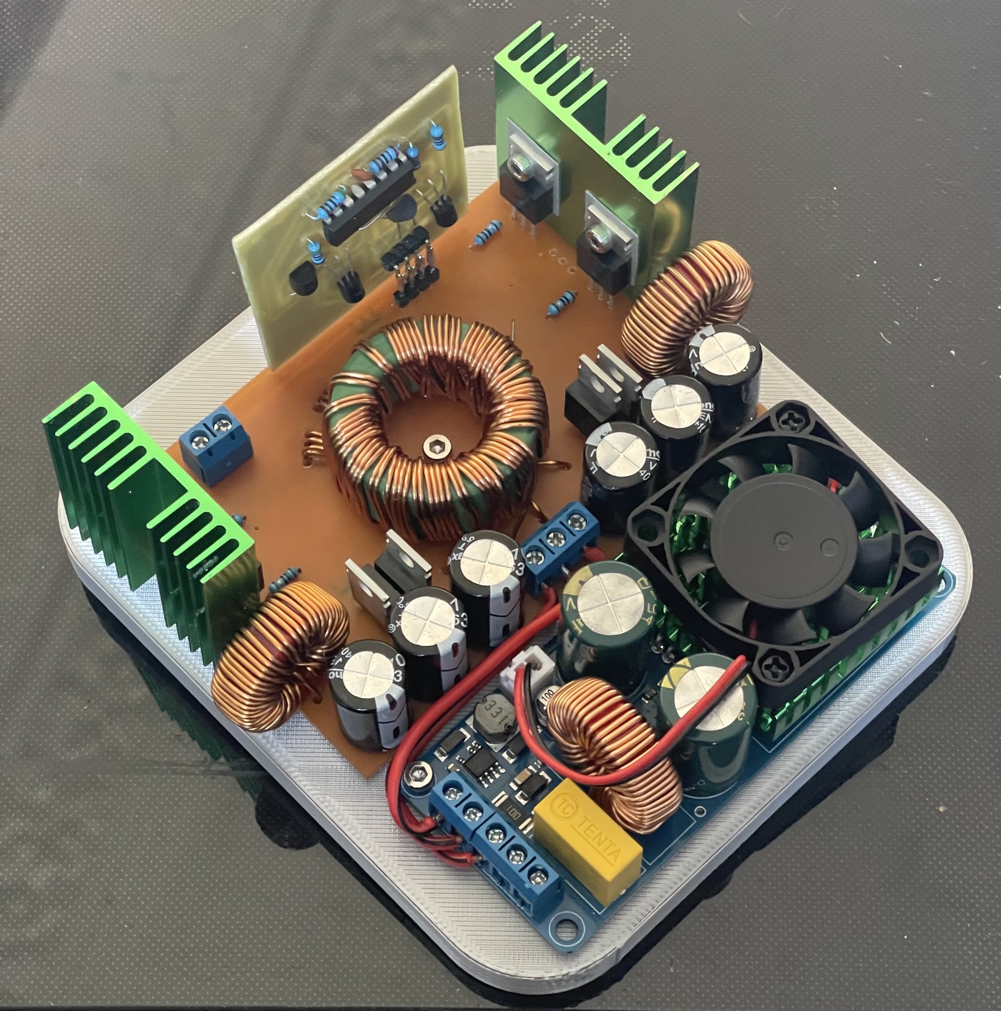

Finally completed it, eventually bit the bullet and wound my own transformer.
Dc to dc converter Mosfets stay cool and dont really need the heatsinks, however the transformer needs a bit of air cooling as it does get quite hot at high load.
Measured the maximum output (of irs2092s amp module) at 350w into 4 ohms, ran this for 10 minuets and everything except the dc-dc
converter transformer stayed cool enough to touch 😀.
Currently the dc-dc converter is putting out +/-55v and In theory, 500w rms amp output could be achieved by once again using a larger dc-dc converter transformer core, with greater primary:secondary winding ratio to give +/-85v.

Nice work and progress ! About the transformer , maybe i would slightly repeat, but you can try to add another core of same size on top and wind turns through both cores ,so making one bigger core . Then decrease all turns count . Also , if you can get powerful atx psu (500 + Watts), you can try that core too .Those are not toroid ,but ER or EI , and depending on topology it had ,may have air gap , which may help to fight core saturation.
Also one thing i see from photo - you wound turns with big diameter wire , which by itself is not good for switching frequencies ,but it's ok for DC filters. Try to make litz wire ,by twisting lets say 100 wires by 0,1mm as example ,few meters each ,using electric drill or similar tool. Such 0,1mm wire can be found on 12v car relays coil ,mains frequency transformers primary winding and so .The smaller wire diameter , the higher frequency it allows to work with small loss . Other thing is heating of core itself .EI type ferrite core with air gap is less prone to that ,and by adding insulation tape layers ,you can increase saturation current ,by making I part a little distant from E part . Same apply to ER cores ,just they are different shape .Remember i've tested unknown massive EI ferrite core from old unknown power supply ,and output exceeded 500 Watts . Used halfbridge topology while testing and unregulated output,just diodes and capacitors .
ETD-59 is also massive core ,available to purchase (i think).
