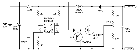

OK,... well let be 250V/(6...10)mA.
Is this schematic can?
Do the maths 🙂 W=I*V so that's 250*0.01 which is 2.5 watts. That means you need to draw at least 0.2 amps at 12 volts (I=W/V) if it were 100% efficient. Such devices are not though.
Two small transformer just might get you what you want though. Expanding on what I mentioned earlier, the transformer voltages would need to be chosen either to give you enough overhead to use a simple regulator or calculated to give around 250volts DC under load.

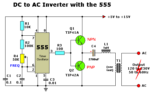

This one is simple, gives you galvanically isolated HV on the secondary of the transfo. For 12V operation you will need a 9V to 230V transformer with the necessary power spec. Because it works at a few kHz range, you can use a smaller transfo (2.5-3 VA) On the 230V side use fast diodes , and HF electrolytics to get the 250V DC.
