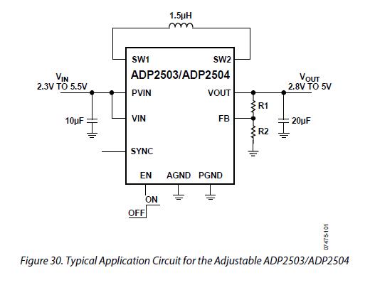

Would a BUCK-BOOST with just a single inductor be better instead, using MOSFETS for switching
you need Boost-Buck
Simplest topology is a single MOSFET, two inductors and rectifiers. As used in one MPPT DC/DC controller that I know of. expensive stuff ! you don't really need galvanic isolation but full blown transformer gives more grounding choices should noise issues raise their head.
also DC range doesn't need to go below a flat battery ( really don't want run a SLA battery lower than 50% many times!) and reasonable drop. so 13.6 VDC nominal and range of 12.0-15.5 VDC would be better spec.
off grid stuff > if you used two batteries in series, then much simpler single Buck topology can be used.
you need Boost-Buck
@ 50-70A ?
boost-buck = Cuk' converter (inverts polarity), so you will need to isolate the input or output. I don't like "buck-boost" cuz of the inputs buck conversion losses means youll be operating at boost mode constantly IE not ideal for eff. more switch losses.

boost-buck = Cuk' converter (inverts polarity)...
Really?

your image isn't a real Cuk' converterReally?
You are correct that the image is not a Cuk' converter but it is a buck-boost converter and to say "boost-buck = Cuk' converter (inverts polarity)..." would mislead readers to think that a buck-boost converter is the same as a Cuk' converter and that both invert the polarity.
Just trying to clarify a statement here.
I don't think any of my statements above implied that a Cuk (boost-buck) and a buck-boost converter are the same thing or that they both invert the polarity...I think that's why they tend to use the name Cuk' converter.Cool, meets his requirements except for the DIY part.
