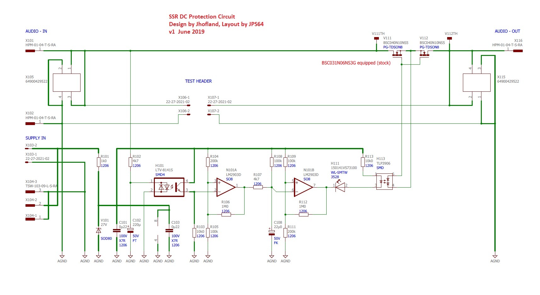

The SSR from post #1 should work, just keep the triggering cable not more than 10 meters. Do not daisy chain it, better use a splitter from the AVR 12V trigger output.Audio Video Receiver with 12vdc trigger to switch on two separate power strips, each power strip has one power amp and a fan.
