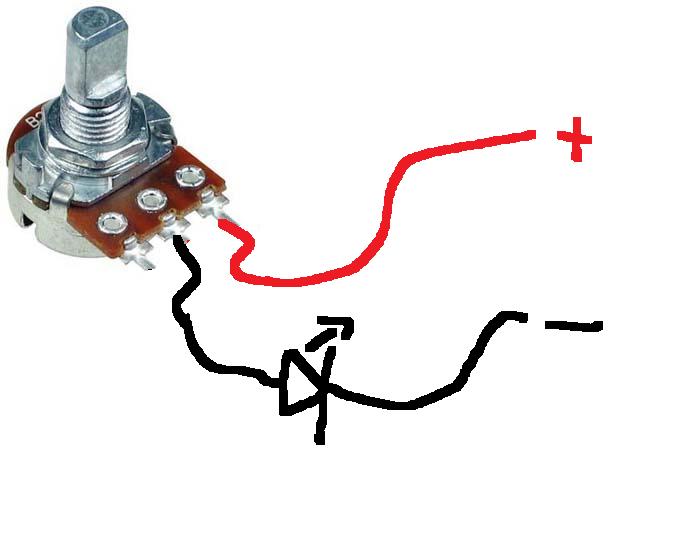

So I think I can direct the neg led wire through the 100K ohm rheostat, then to ground; so the light is energized first (upstream), and then connects to the rheostat, see below:
picture.php
The black part of the sketch was pre-existing. The blue ink was added on today, after you posted your rheo. All I'm really doing is feeding the (+) LED from the n/o terminal of the sw. After current passes through the light, it hits the rheo (Red + wire) goes through the resistor, and leaves through the middle (center) wire to ground. I think it will still work, any thoughts...
PS: Thanks Mooly, for moving all these threads around! I just saw what you did about a min ago; I was busy drafting this post... glad you didn't delete this before I was done 😀
cheers!
I think I follow you 😉 The switch, the LED and the resistor are just a series circuit and so it doesn't matter what order things are connected.

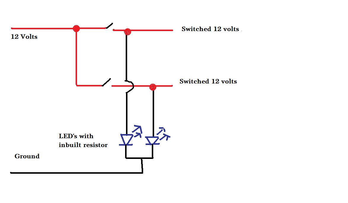

Everything seemed to be just fine, "with both amps turned on". What I didn't realize yet was, when imposing resistance on the ground circuit, if only one switch is on (while dim), both icons will light up! Doesn't matter which one. I need to say that again. If both switches are on (pushed in), there's no problem. But if I'm dimming the status indicators a bit w/only one switch on, you'll watch the other switch suddenly light up. This doesn't happen when I have the potentiometer dialed to zero ohms (brightest).
Now I'm sure it's "feeding back" (somehow) through the other circuit, likely due to the fact that it's looking for a ground, I'm just not sure how it's cross circuiting. I've considered trying to use the rheostat on the hot side (that probably would solve the whole problem), but remember that this circuit is really there for one thing, to start/run the amps; you can't do that with 8 or 9 volts. So the hot wire (trigger) which feeds the sw common terminal needs to be @12vdc all the time: the ground circuit is only there for the light.
Well anyway, for now I've left the dimmer circuit in tact because these switches do still do their job, which is to allow me to check the amps individually when I need to. And the dimmer allows me to see where I'm going at night w/o that blazing 'Kriptonite' electric green blinding me wherever I go. Has anyone ever had this happen before?
Greg, (rig) regards

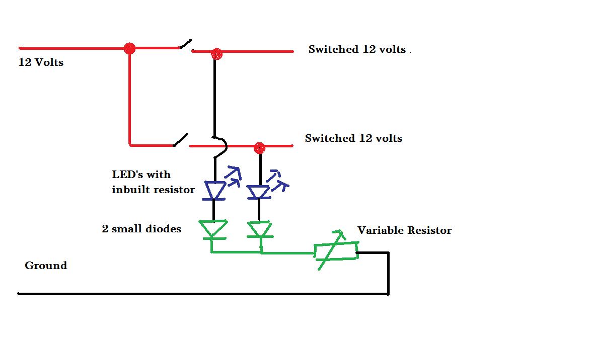

OK, a bit hard to visualise all this from descriptions but here goes with a couple of suggestions...
One option would be to use a dual gang (stereo) pot and wire each LED separately to one gang.
Another option, and this is where I have to guess how it really is, is to connect as shown here and add a couple of diodes to prevent the LED seeing a reverse bias. If the switch (or raher the LED) is suitable for AC operation as standard then this diode would already be incorporated in the switch.
So guessing how it all looks, here is the original switch with nothing added and then a possible workaround. The stereo gang pot would be a definite option because the two LED's couold never interact.

"...So guessing how it all looks, here is the original switch with nothing added and then a possible workaround. The stereo gang pot would be a definite option because the two LED's couold never interact."
I'm still with you on that, however I did 'unintentionally' leave out one important detail. When I disconnected/broke the ground circuit (through the pot's N/O contacts), the led still demonstrated this same strange behavior; that same dim glow on both leds no matter what you do. So I'm not sure if adding diodes to the gnd circuit can address this issue; I may need to approach this from the hot side 😕
If I were to use a fixed resistor across the "N/O and (+) LED" terminals at the switch base, could I use a low value resistor (1K-4K)? 1. there's not a lot of room to play with there, and 2. There is a good chance of burning the switch's entrails by reheating them, so I was definitely hoping to avoid doing that... if I burn them, it'll be a good month before "Hong Kong" can ship me more (only cost about $9 bucks though): Amazon.com - 16mm 12V Car Black Aluminum LED Power Push Button Metal Switch Latching - Electronic Component Pushbutton Switches
Thank you so much for all your help, this is a great learning/training experience for me!
rig
Again, its very very difficult to visualise all this. Do you need the option of "dimming to zero" ? or using the switch to cut the LED's off completely ?
Back to the second drawing I did...
That should work. If both switches are on then both LED's see 12 volts applied. The lower end goes via a diode and into the common pot. That should work and dim both OK. If you turn one switch off then the 12 volts to that particular LED is removed. This is where the diode comes into play. With no 12 volts on the LED anode (top lead) and with a variable (depending on pot setting) voltage on the lower end of the diode, then the diode is non conducting and no LED current flows. So that one LED is off while the other is still on and dim-able.
One possible problem (something for you to check) is to make sure that the switched voltage really does fall to zero when off and that there is no back feed from somewhere else via the amp and back onto that line. Even 3 or 4 volts would make the LED glow. So that is worth checking.

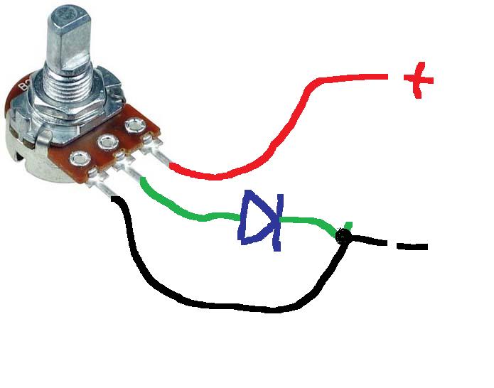

...crimp a male and female stake-on onto the two wires and connect a new dual pot between them. Again I'll report back after picking up what I need/installing. If this doesn't work, for whatever reason, I think I'll put the original "green ring" switches back in and mitigate my troubles. :crazy: Thanks again for replying.
