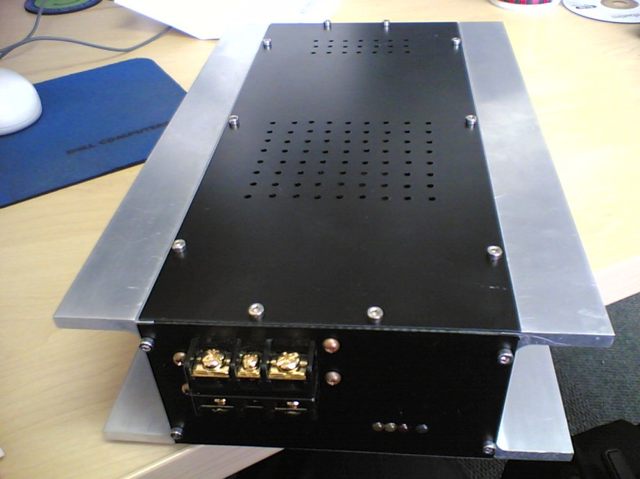

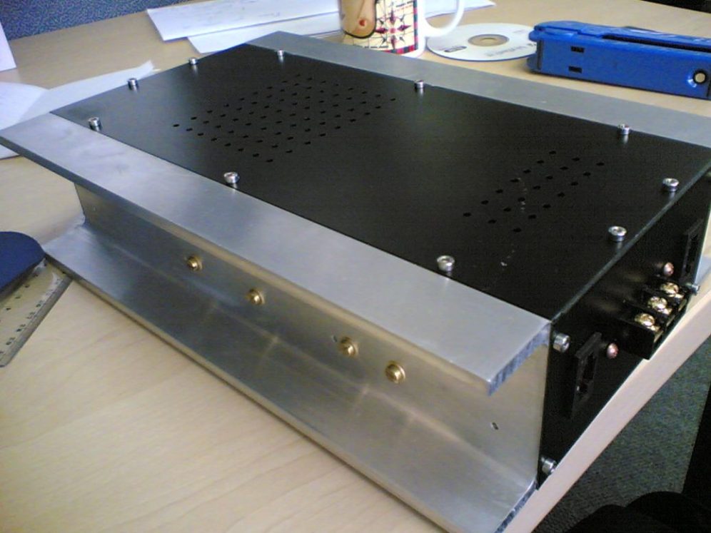

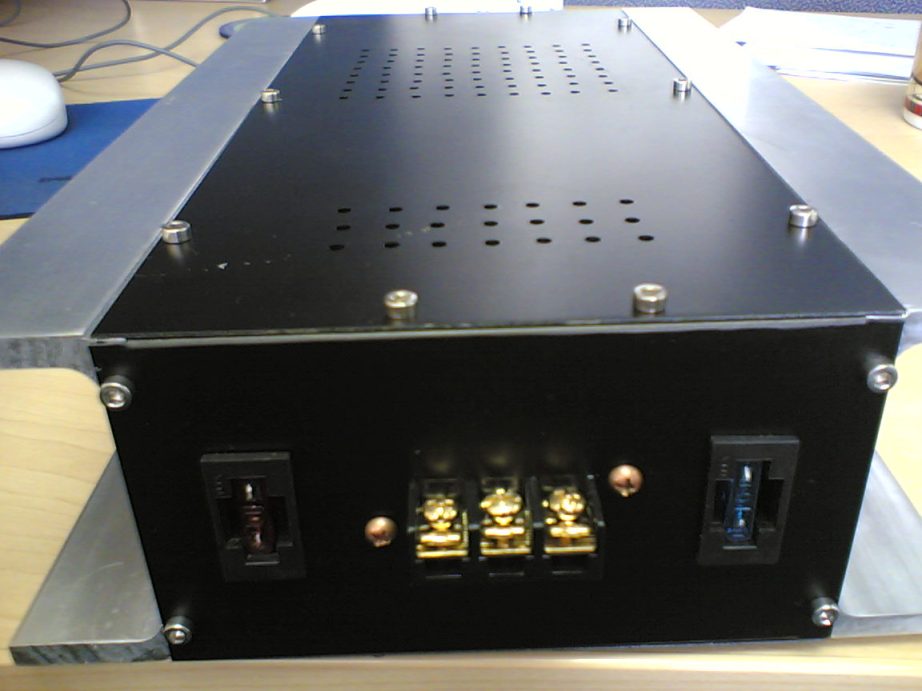

Your prototypes look even more interesting now. Where did you get those car-audio like heatsinks, terminal blocks and fuse holders?
Eva, i think the heatinks are regular aluminum U-girders, nothing car audio spesific. Thr fuse holders and terminal blocks i guess is either bought on a car electronics store or salvaged from a broken beyond repair car poweramp.
The gate resistors are 20R.
Yes the heatsinks are 8mm thick aluminium girders as finding suitable aluminium extrusions are a pain in the butt. These were machined by an engineer to fit the steel plates and PCB. At full power they remain relatively warm after a while +/- 45 deg C.
The connectors are not second hand I assure you. They were obtained from a manufacturer in China that specifically makes terminal blocks. Beats the other forms of connecting power hands down and looks a lot more professional if I may say so myself.
There is nothing in that psu that is not new.
