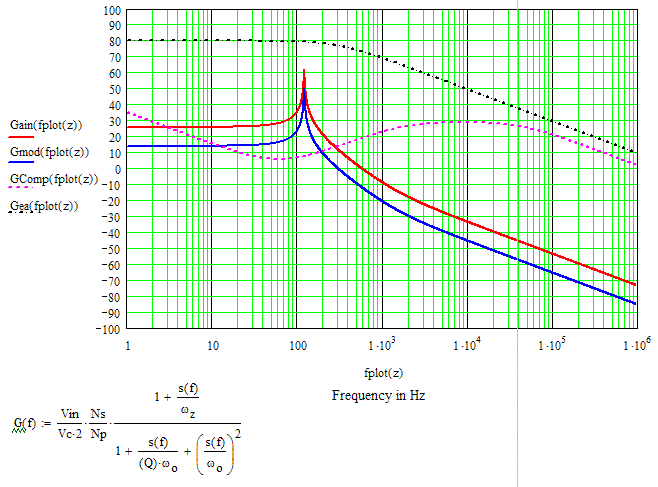

In attachment, is calculated closed loop bode plot of this PSU(type 3 compensation). if ground are not separated. There is a peaking. Is that good?

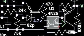

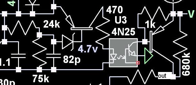

I am quite specialized in my theoretical knowledge, but I will offer what thoughts come to me.
I use a PNP transistor on the diode side of the optocoupler instead of a TL431. The output from collector of the second transistor could connect to the controller IC you choose, but I use my own more discrete control method and am not sure how well it would work on a standard controller IC.
Iron powder has a lossy aspect which you may find difficult to reproduce with ferrite. You may be able to help the situation with damping circuits across the windings if you end up with a problem.
I suspect that, according to that bode plot, your loop will be unstable. It is just my impression and am not sure.
In the diagram, the output voltage is determined by the ratio of the 24k/75k resistors. You would need to change the ratio. The 470 current limiting resistor needs to be increased to at least a few k since this circuit is for 12v. The emitter of the second transistor goes to the reference power supply. The 680k sets the maximum duty cycle. Its value depends on the PWM frequency.
Powered iron is much lossier than ferrite and I agree your bode looks like it will be unstable. You really need an inductor since the output caps will see the reflected switch current. Unless of course you are running full pulse width.
Can you post a schematic?
