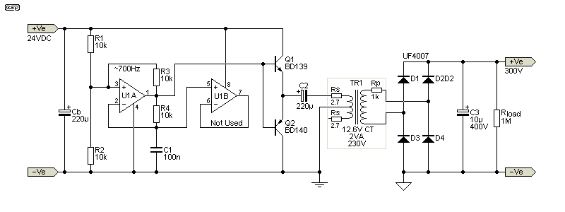

Yes, it could work, but you need to add 4 diodes between the outputs and the supply rails to protect the chips against inductive kickbacks, and you have to derate the output power to take into account losses and the non-unity cos phi of the load: for example, if you use two 20W capable chip amps, the final usable will be ~20W, not 40WSo you think the idea using 2 to-220 style amp chips with inverted phase driving each side of the coil will work well as in post #2? I personally can't think why it wouldn't work as speakers are coils, just maybe with lower inductance.
If so I will order the parts and try it out.

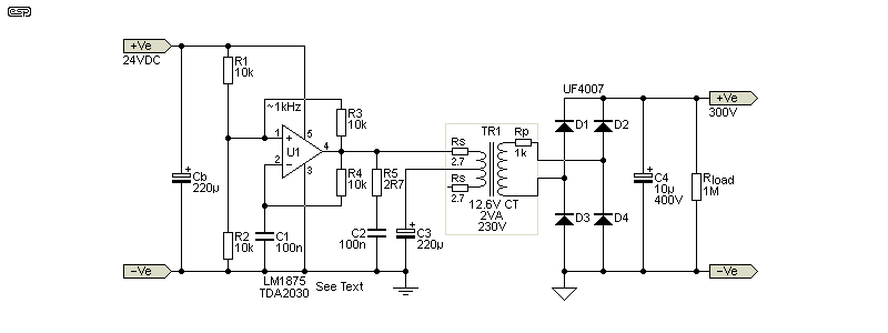

I found something similar at ESP Projects:
The differences being that my idea proposes 2 amps driving each side of the transformer in bridge mode thus no AC coupling cap would be needed. (C3/C2 in the above schematics).
I only hope ~20W amp chips have enough power to drive the transformer (should only be about 1.6A RMS).

Yes, but the idea is the closest I can find, that is driving a transformer with a power opamp. I will be using a sine (thus no harsh transients), but the above design's a square.
One concern I do have is any DC voltage offset between the 2 amp's may result in early saturation of the coil if not kept to a minimum? And I want to avoid the coupling cap if I can.

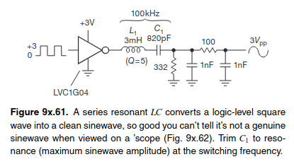

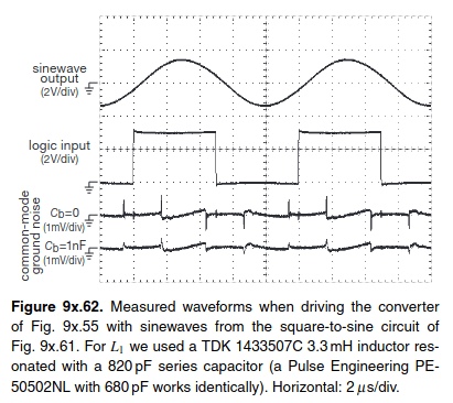

There's an open-access X-chapters section on this on the Art of Electronics website.
I think they used a square wave, which was then passed through a resonant RLC filter to get a sine wave output.
I think I found it.There's an open-access X-chapters section on this on the Art of Electronics website.
Link: https://x.artofelectronics.net/wp-content/uploads/2019/11/9xp14_low-noise_isolated-pwr.pdf

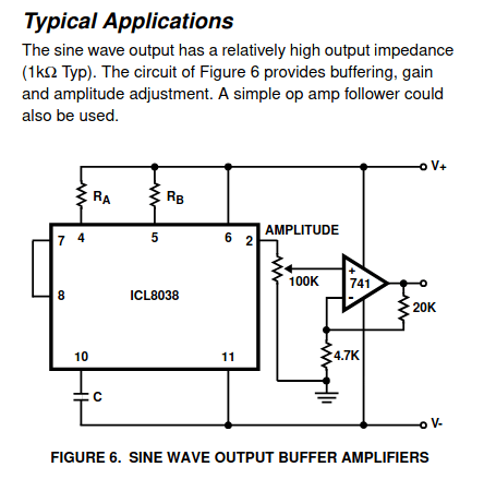

Seems it could be a good method if it will work well at low frequency's, but would still need something like a classic 555 to drive it?
But in terms of simplicity and 'just works' the ICL8038 looks hard to beat, here's a buffered sine from the datasheet:
Link: https://www.mit.edu/~6.331/icl8038data.pdf

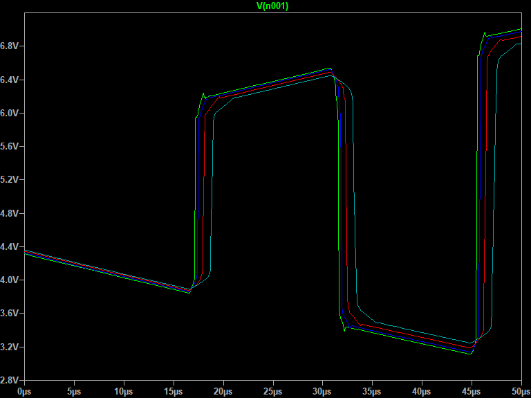

Will mention again, you don't need a sine wave to get a low noise DC output. (I cited some of the white papers done by the late Jim Williams on low noise high voltage circuits for Linear Tech, now part of Analog Devices). Chips like the LT3439 modify the transition time so that the edges, the rate of change rounds the top and bottom of the pulse so di/dt is slowed. The picture below shows how stepping the value of the slew control resistor (on the example from LTSpice). As the resistor value increases, di/dt is slowed.
The advantage of slew control over sine wave is much greater efficiency.
