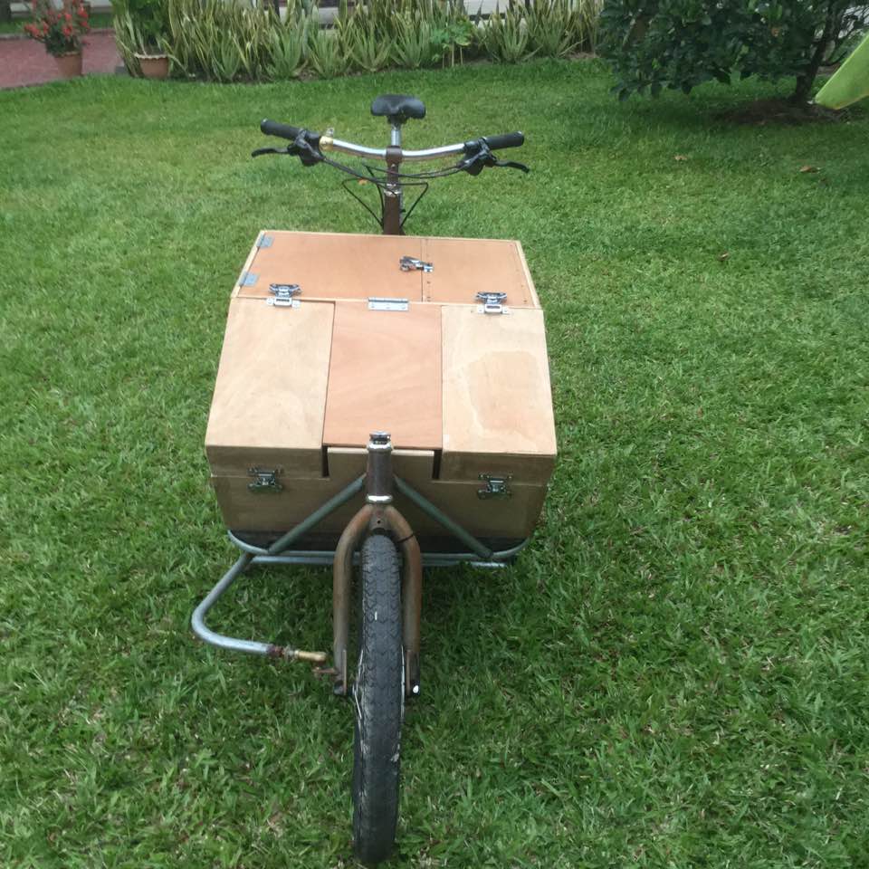

12v Party Bike
Hi folks
I'm looking to combine my two passions (audio and bike building) and would really appreciate some assistance. I've recently built my own bakefits style cargo bike, and now I would like to kit it out with a 12v sound system so I can take it to friends houses/the park and crank some tunes (both on the way and while we are at our destination).
I have some 12v components from an old Car sound system that I salvaged and would like to put to use. Namely a 12" pioneer car sub (TS-W308D4), some JL audio 6.5's (with tweeters), all run off a Sony Xplod 4 channel amp (XM-GTR4A). It is unlikely I will be able to find a suitable deep cycle battery where I am living (Laos) so will likely have to use a 2nd hand car battery. I already have a battery charging unit that I will include in the install so I can plug it into wall mains where possible (house parties).
My current thinking is that a simple slot ported sub tuned to the 35hz region would be a sufficient cornerstone for this application. That being said I have no experience with this style of sub!

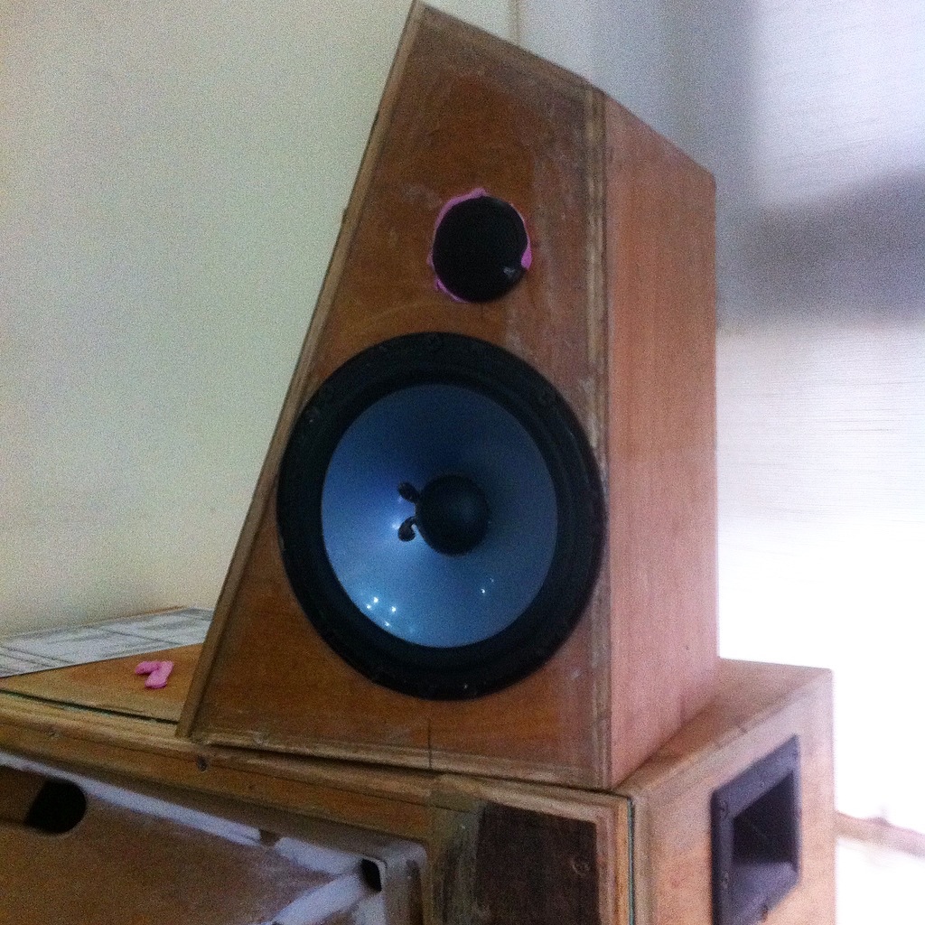

Yesterday afternoon I was able to put together a prototype HF for some testing. Had a chance to listen to it last night and this morning. Impressed with it's extension when run full range, but it does start to run into excursion issues when I put more than 30W RMS through it. Once a sub is dealing with everything under 120Hz it should be able to take the 50W ok.
Mark

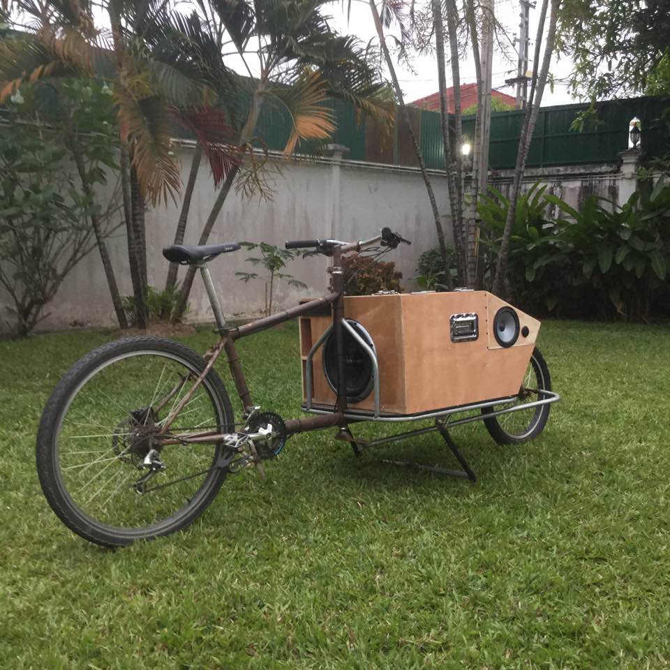

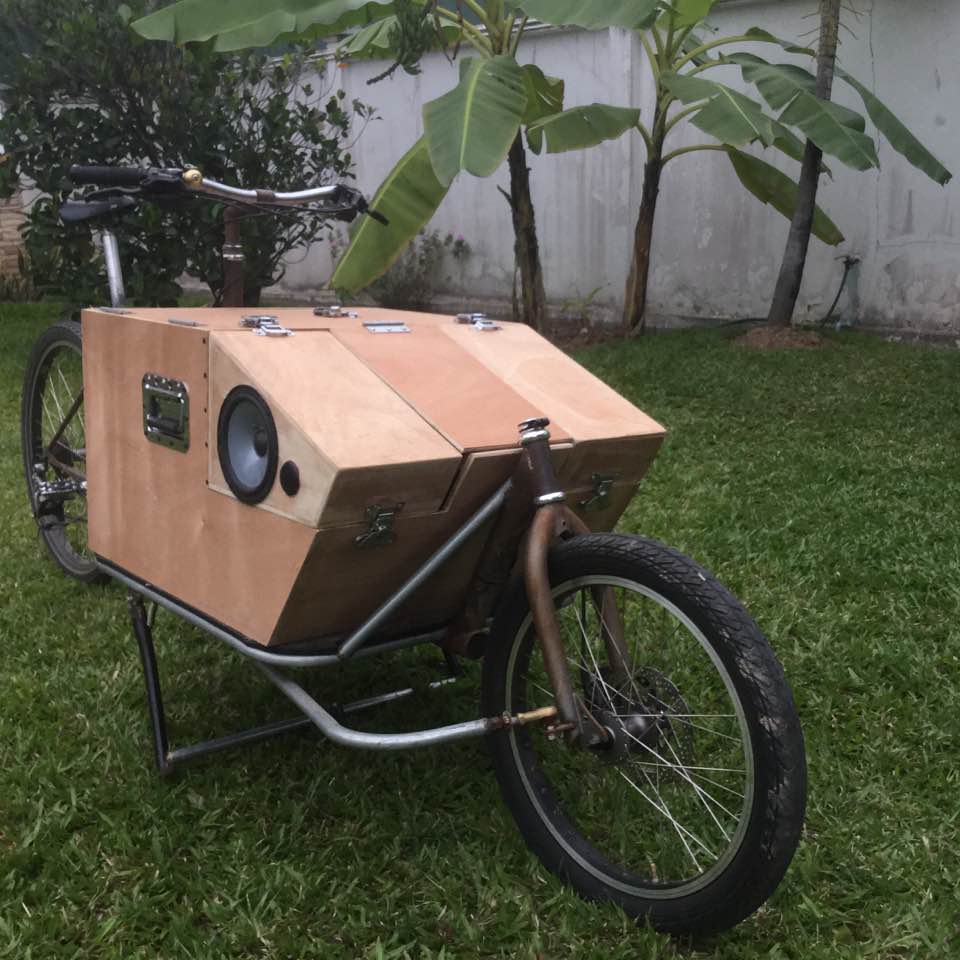

Well seemingly against all the advice here i've gone ahead and done it anyway. Got a draft of the final product up and firing this afternoon. Still need to wait on some little electronics (voltmeter, kill switch and usb charging ports) before I can do a final electronics install. Got to spend some time making new cables to make it all neat.
Got some more panels to install, clips to hold the 6.5s in place when riding, clips to hold the whole thing to the cargo tray, strapping for the battery and battery charger. Probably have to install some handles as it is a tricky one man job to get it on the cargo bike tray. Once that is done its time to un-install it all, putty, sand, prep and paint the sucker.
Got a video on youtube if people are interested to see/hear it in action.

Hi folks
I'm looking to combine my two passions (audio and bike building) and would really appreciate some assistance. I've recently built my own bakefits style cargo dirt bike advisor, and now I would like to kit it out with a 12v sound system so I can take it to friends houses/the park and crank some tunes (both on the way and while we are at our destination).
