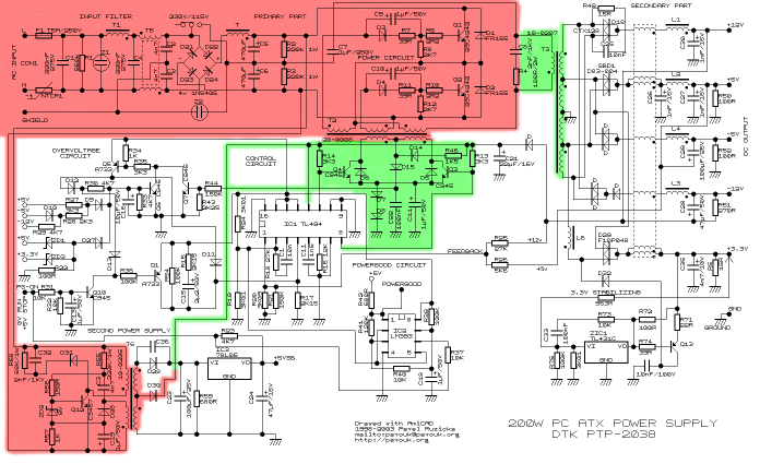

Such a PC power supply should have to provide 5V for standby even when off, and the conventional outputs: +5V, +12V, +3.3V, -5V, -12V, all cross-regulated. A power-good signal to inform the motherboard when the rails are settled at power-on and when input power has been just removed is also required.
This is not a simple project. Forget about linear regulators since that will provide very poor efficiency and a hard to manage amount of heat, particularly with modern CPUs above 1Ghz. Forget also about switching ICs if you want to take audio or video out of the PC and feed it to some car-multimedia system, this is because the PC ground must be floating for that and not connected to the car ground. A good option is to modify the primary side of a conventional ATX PC power supply, but this requires transformer rewinding and routing a new PCB, and you don't seemn to have the required knowledge and experience to do that.
So the more time and cost effective solution for you is probably to buy some 150W to 300W, 12V to 120V or 230V inverter and to power a conventional PC PSU with it. Note that AC is not even required since nearly all 230V PC PSUs work fine with DC (320V), and there are some simpler and smaller inverters, intended to power that kind of electronic gear, that output DC instead of AC.

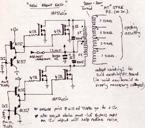

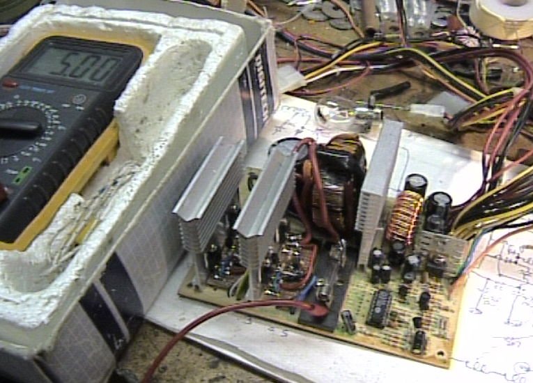

As always, EVA hits the nail on the head. Tomorrow, I will post some pics of exactly what EVA describes as an extensive ATX modification from AC-DC to DC-DC.
Everything on the Primary (Hi Voltage DC) side is eliminated, and the transformer re-wound for 12V input, and the high voltage bipolars are exchanged for low voltage (55V) high current N-Channel MOSFETs. The dirver transformer is also re-wound. The kicker here is that for the main transformer, a toroid of the same material and power-handling capacity was substituted for the original E-I core.
Steve
Steve
