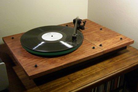

Hi there,
I am looking for a relative simple circuit to precisly control a small 12v DC motor. It must also have 2 speed presets - and yes, it is for a turntable... 😉
The conversion kits comercially available is rediciliously expensive! I wont pay what they ask - rather make my own unit.
Thank you in advance for any advice on where to start. I am a bit dumb when it comes to designing circuits - usually a lot of smoke and cursing...
Dewald aka GD
Attached is the pic of my DEWAUDIO Credence turntable. At the moment it uses an AC Synchronous motor. 240 VAC with a Linn Valhalla PSU.

I have a circuit for controlling a 12V motor with tachogenerator. It works pretty well. Does your chosen motor have a tacho? If so, I will draw the circuit up for you and post it.
If not, there are basically two approaches.
1) Simplest - just generate a low noise, adjustable voltage. Simple, can work well, but for a DC motor, the speed at constant voltage drops as the mechanical load, the torque, increases. Variations in torque requirements (for example due to loud passage on a record) cause minor wow. For two speeds, you just switch between two voltage settings.
2) Slightly more complex - current sensing circuits. These attempt to correct for the slowing due to increased torque by sensing the current drawn, and raising the voltage to compensate. If you over-do the compensation you get instability. There are several variants in this class. I've not heard one of these myself, but
they have a good reputation.
Primotec offer tacho options on some of their motors, but they are very expensive (£100 to £120) to buy in small quantities through the UK supplier.
I have one that I got 15 years ago, back when the motors were made by Phillips, before they sold the motor unit. I think they then traded as Impex, and later became Primotec.
There are probably other good options from different manufacturers.
See what options are available to you through your suppliers, and we can discuss further.
A tacho based circuit is more complex than the other options, and some people prefer simple constant voltage, or current sensing systems.
But you can usually find somebody who holds any opinion!

@ Error: Stepper motors can be used but I suspect they will mechanically induce a whine noise into the system. There is a guy however that converted a floppy drive's motor to run at 300 rpm.
Stepper motors are generally a poor choice. They move in steps even when they "seem" to be rotating smoothly. As you can image driving a turntable platter with a series of incremental movements is far from ideal.
Things can be done to minimize this problem, but they require instrumentation I'm guessing you don't have.
Like so many other things, a motor controller can be designed and built, it should not be assumed that this is a trivial task. Wow, flutter and speed stability suitable for good quality sound reproduction may not be quite as easy as you presume.
Using high speed control pulses is a good way to control a motor, but you need to be careful that those same pulses can not find their way into your cartridge. This is why many turntable manufacturers use a 60 Hz sine wave controller and then adjust the sine frequency.
Like I said it can be done, but IMHO if you can find a conversion kit for under $200 you'll probably end up money ahead.
